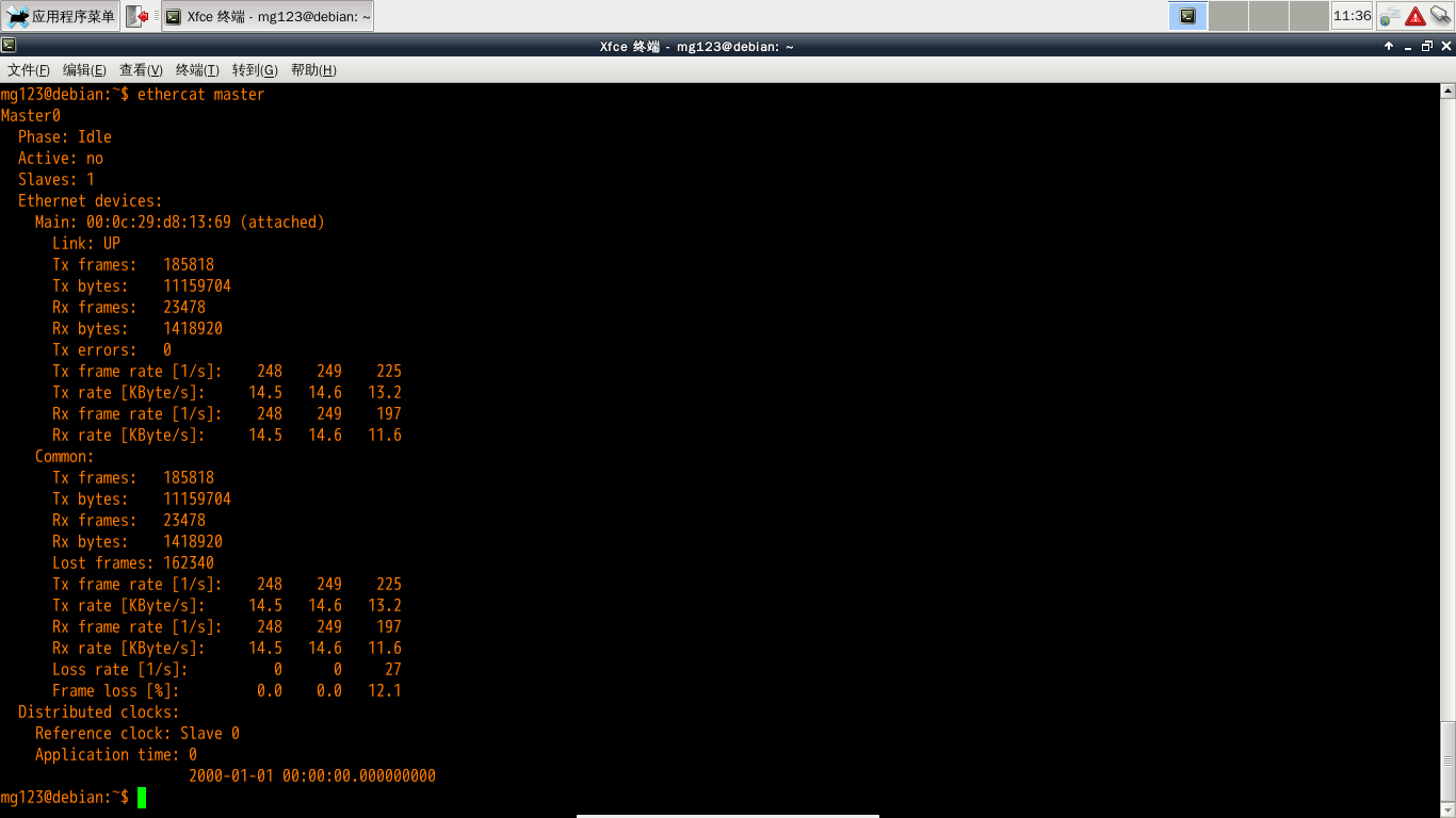

I have successfully installed igh-ethercat and detected slaves but I don't know how to make the slave station motor turn.

03 Jul 2019 20:08 #138581
by Grotius
Replied by Grotius on topic How to use LinuxCNC to control slave
I live in Guangzhou now.
Nice Cheng.
I want to learn how to use LinuxCNC to control the motor.
Oke that's fine !
I am going to find an example of C code in Etherlab.
It's important you play a bit in the Etherlab source code. There is one example provided (included) that is basic enough to investegate.
I have a question. Is your system 32 or 64 bit? You can read a bit about .ko and .so kernel modules.
32 bit uses .ko modules. 64 bit uses .so modules.
The installation of 32 bit is quite easy to do. The 64 bit installation is more difficult.
What kind of ethercat slave do you have? Is it a Beckhoff?
