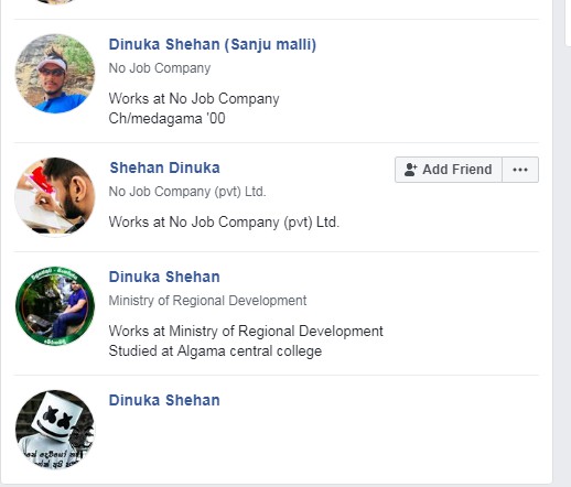

- Dinuka_Shehan
- Posts: 333
- Thank you received: 26
18 Jul 2019 06:11 #139780
by Dinuka_Shehan
Replied by Dinuka_Shehan on topic How to use LinuxCNC to control slave
Find me Dinuka Shehan on facebook
