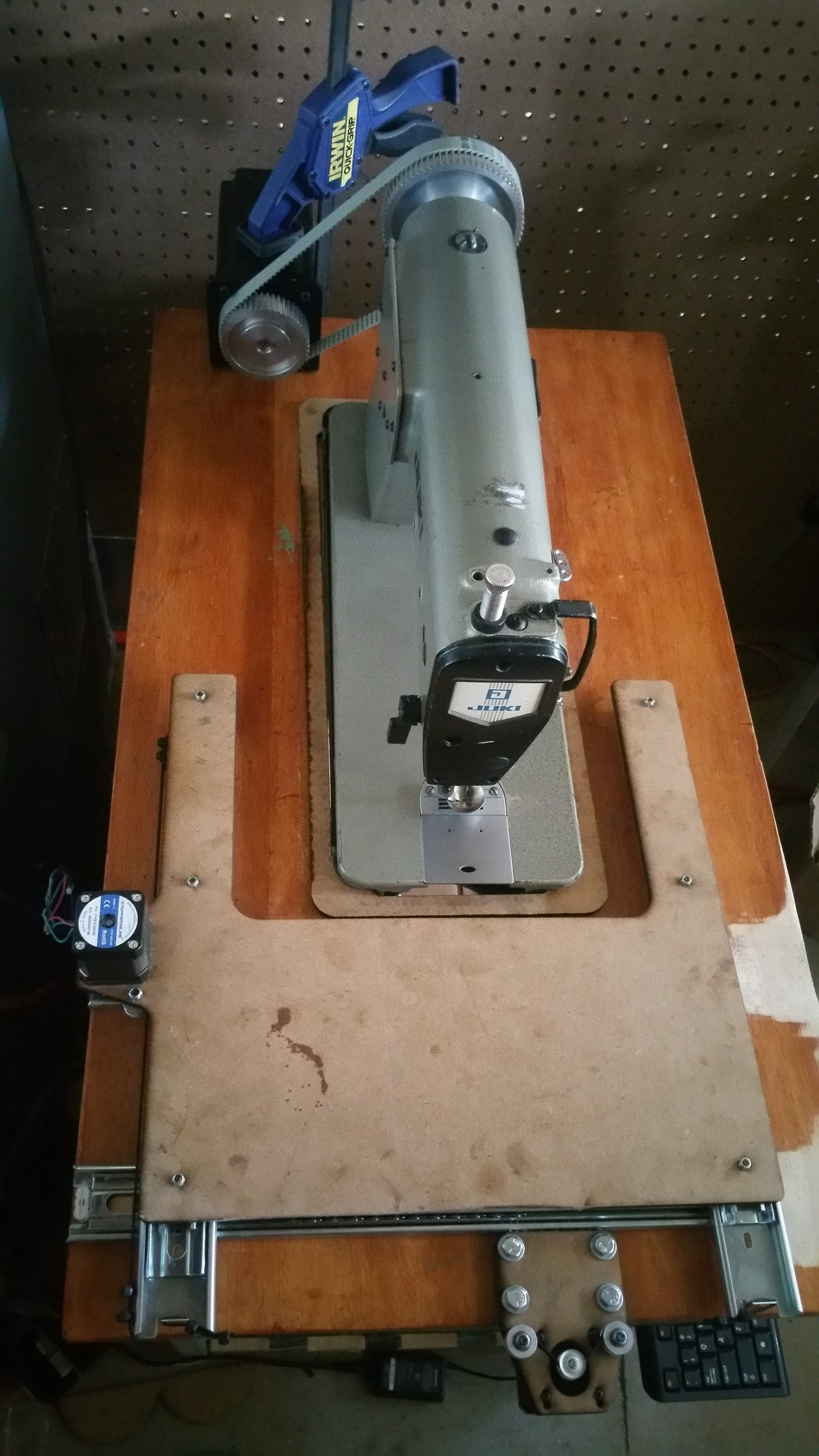

I have taken an old sewing machine and given it some computer controls using LinuxCNC. See attached pictures.
While it is working, it is not fast enough.

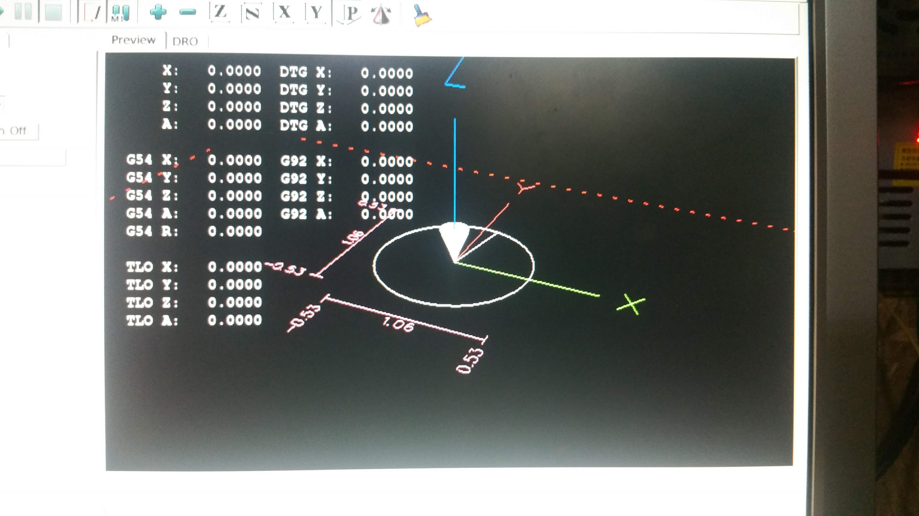

I am building on ideas from several others who have built similar machines. Basically, the strategy is to move x and y to the right point and then advance the A axis 360 degrees - this is one cycle of the needle going down, up, then back into position. I have attached some G Code that I am using for testing... it is a circle roughly 1 in diameter broken into 33 segments. The A axis is set to wrapped rotary in the .ini file. I have pushed the accel and velocity as fast as possible before skipping and the time to sew this circle is about 13 sec... it should be like 3 secs.
Here is a segment of code:
N18 G90 G1 X0.1007 Y0.5217
N19 G91 G00 A360
N20 G90 G1 X0.1978 Y0.4932
N21 G91 G00 A360
N22 G90 G1 X0.2878 Y0.4468
N23 G91 G00 A360
... etc

Ugh! Why do you think you need to program the needle crank in degrees?
All you want is for the needle to be up when you make LARGE moves of the material.
Why not set up the sewing motor to be the spindle (maybe even have programmable "spindle" speed, and then have a circuit that always stops the needle at full up.
You could program a pause after every spindle stop to allow the needle to get to full-up.
Jon

Yes. The stepgen has to be set in velociry mode, i think as i never done it.
From what others mentioned in this thread, you will need to add a sensor to the machine pulley so it always stops at the top position of the needle.
There is also the issue of the X and Y axis moving the material while the needle is inserted in the material. I am aware that the machine clamps the material when in normal use and pushes it back. That can normally be disabled.

From what i know about those machines, the material can not be moved while the needle is in the material, that is why i think you would need two sensors on the machine pulley so it can know when the needle is out to start moving the material and when to stop moving just before the needle is inserted into the material.
All that is not very important for very high thread count as a litle flex to the needle is OK. That problem becomes very obvious when you try to stitch letters at 2 or more mm apart, that will break the needle or in your case most probably lose position.
Do a search for "rugbot" here on the forum maybe there is some info there on how to do that.

The frame to hold the material is pretty large. When the CNC program is in the sewing mode, it will be moving at a very slow rate, and should not break the needle, as the fabric has some stretch to it. When making larger moves, as between letters, the "spindle" should be stopped with a timed pause command to allow the needle to go fully up before moving. I think this will really solve the problem.
Jon

I understand what you mean. The reason I was trying to time everything so that it doesn't move while the needle is down is to avoid bending it into the hook on the underside. The slot on the spinning hook is pretty narrow that the needle goes into. I think it could tolerate more bending in the x than the y.
It is a good suggestion though. I will try it and see what happens. Worse case scenario, I have to replace the hook.

I've no experience with cnc sewing machines but plenty with conventional ones. I can say that you'll need to make sure the bed isn't moving when the needle is down. Best scenario it will just give you rubbish results because the stitches will be in the wrong place, worst case you'll get constant broken needles.
You should have the best part of 180 degrees of spindle movement to do the bed moves. Perhaps a little less for reliable results. I suspect you'll need really high speed and torque on your x/y to get good results.
