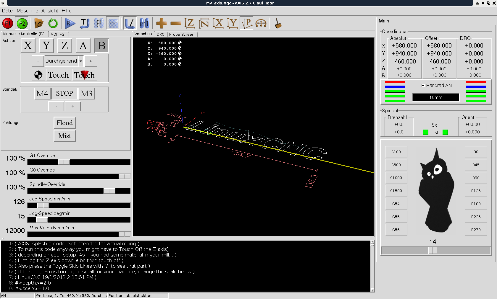

06 Sep 2019 23:16 - 06 Sep 2019 23:18 #144430
by Emanresu
Replied by Emanresu on topic HD Axis and axisrc
Not the most ultra fancy GUI ever, but thats all, my knowledge allows me to do
Thx for the Help all!
Buttons are created in Blender, if anyone needs something like that, just send a little sketch and
i try to help.
Buttons, tlc and .axisrc aswell as infos with linenumbers are in the ZIP if anyone wona play too.
i try to help.
