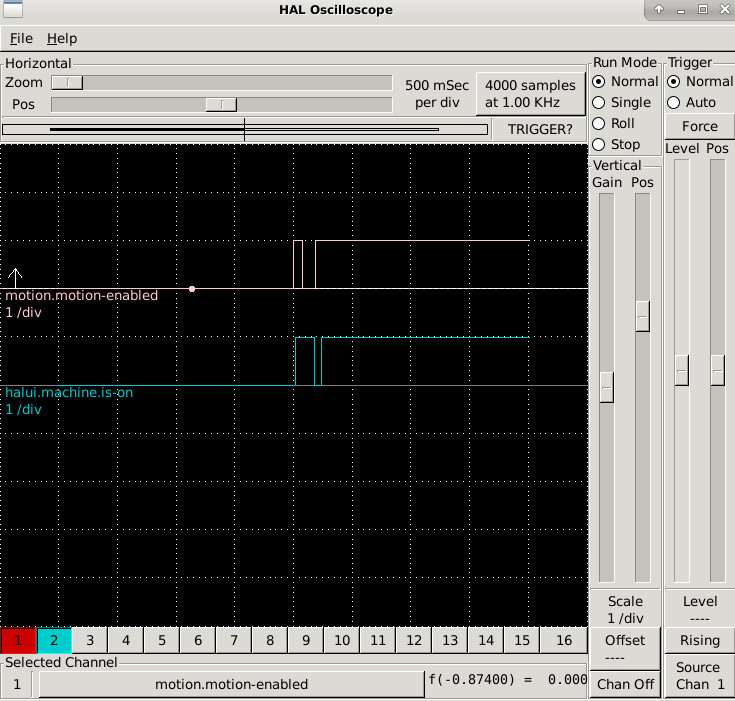

halui,machine-is-on is driving machine-is-on.
Hal File
custom.hal
Replied by bevins on topic Gmocappy fires relay twice
what drives the signal 'machine-is-on'?
Chris M
When you press the on button in the gui.
Gmocappy version 3.08
I think what Chris meant is: what drives the 'machine-is-on' signal in the hal file
Could you post your hal files?

Replied by PCW on topic Gmocappy fires relay twice
Does your axis config use halui the same way?
What pokes halui.machine.on and halui.machine.off ?
- dgarrett
- Posts: 492
- Thank you received: 297
07 Sep 2019 20:19 #144493
by dgarrett
Replied by dgarrett on topic Gmocappy fires relay twice
The userspace pin halui.machine.is-on is following
realtime motion pin motion.motion-enabled.
Some investigation shows this behavior with gmoccapy
has existed for a while -- it has probably just

Using configs/sim/gmoccapy/gmoccapy.ini, Pressing the Machine-On button:
Suggestion: file a bug report (issue) on github and/or notify Norbert
never been reported.
The problematic code is likely in this function or
its triggers (2.8 branch):
github.com/LinuxCNC/linuxcnc/blob/fbd3f7...py/gmoccapy.py#L2296
What is triggering motion.motion-enable?
/EDIT nevermind I think I understand how it works. The function (on_tbtn_on_toggled) looks like it works. Must be in the triggers in the widgets.
Where can I create a bug report?

Hallo @ALL,
i am able to reproduce the behavior. so now is just to find the reason and bug fix that one.
I apologize for the inconvenience.
Norbert
Norbert

I just tested this one with gmoccapy 3.1.0 (the latest release from 2.8 branch)
As far as I can see from hal scope, the behavior has been fixed.
Please test with latest 2.8 release and gmoccapy 3.1.0.
I will close the issue, if it has not been solved, please reopen it.
Norbert
Norbert
