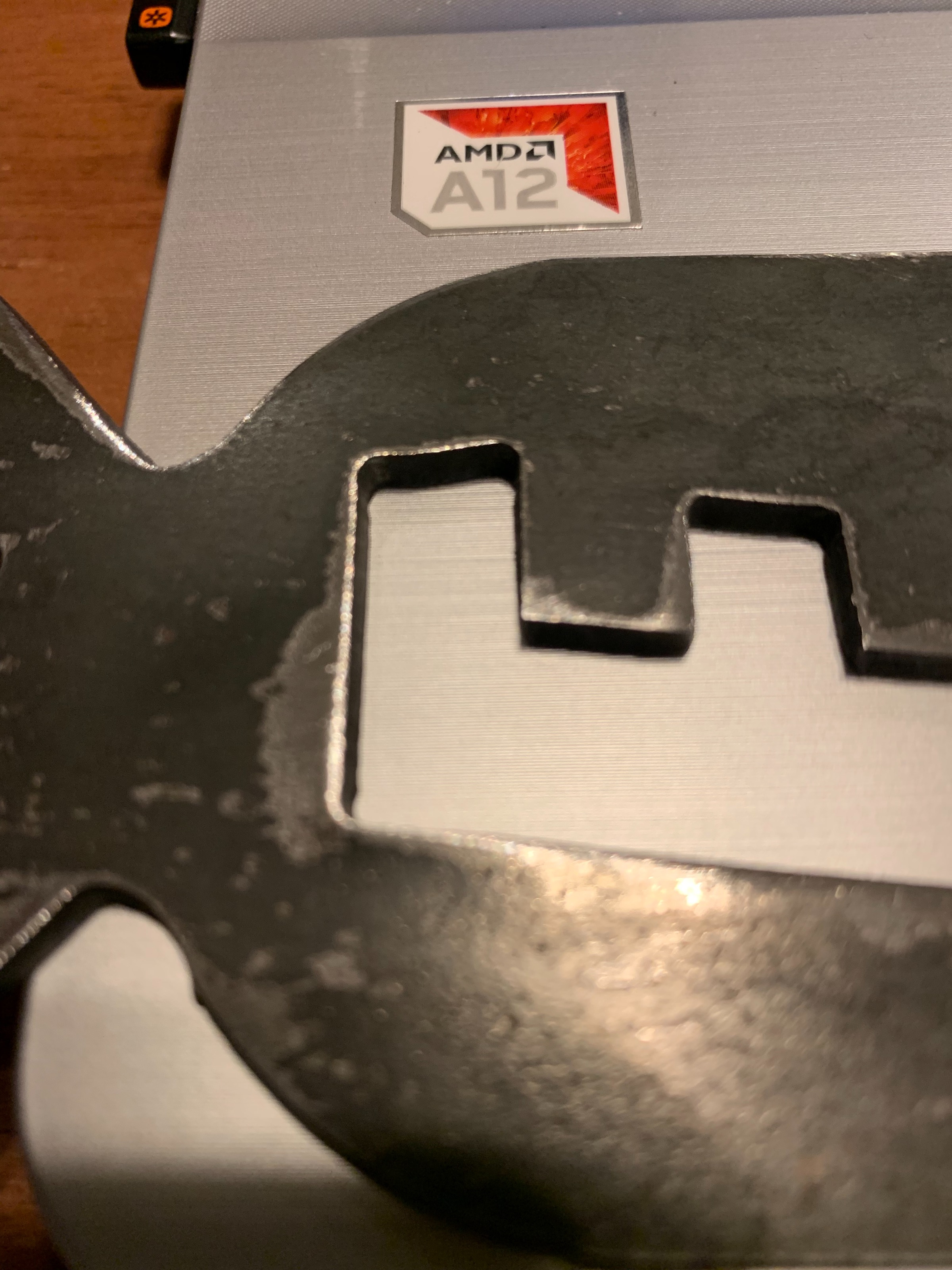

Replied by tommylight on topic Anybody using a thermal dynamics CM 52?
Can the hys go lover, i can not recall ?
Are you using the ARCOK signal from the proma and does it work properly ? Setting the HU to something like 150 to 160 would be better for some plasma cutters, but if it working, leave it as is.
Also check if the torch is at 90 degrees on all sides, tapered edges are always caused by that or bad nozzles.
You should do some testing with various feed rates while cutting, that changes the cut quality a lot.
Find a welding helmet and see if the torch is roughly 1 to 2mm above the metal while cutting.

Replied by rodw on topic Anybody using a thermal dynamics CM 52?
The plasma primer has a diagram showing what causes bevel cuts (releated to cut height)
But you don't say how thick the material is you are cutting. I cut a fair bit at 40 amps with my TD A120 but mostly 2mm
Also check your manual and make sure you are cutting in the right direction. If the swirl is going the wrong way, it can cause a bevel.

Arc ok was fine I think what I was worry about was that the threshold of the plus and minus on the voltage when I was cutting and had the voltage set at 94v it would be fluctuating plus and minus 6-8v
- TexasCNC
- Posts: 373
- Thank you received: 10
01 Oct 2019 03:49 #146780
by TexasCNC
Replied by TexasCNC on topic Anybody using a thermal dynamics CM 52?
I saw on another thread that the cut direction was important also and I didn’t know that and I went to check sheetcam and it was cutting counter clockwise on outside cuts and clock wise on inside cuts. I changed my direction but didnt have time to test some cuts. I will check to see my squareness on my torch I am using the hand torch so it will be a task to check but I will see if I can. I am getting bevel cuts on any material I put on it from 1/4 10g 14g
- TexasCNC
- Posts: 373
02 Oct 2019 04:16 #146851
by TexasCNC
I got it figure out the cut direction was the fix I had it backwards and I raised the voltage on the thc man what a difference it made thanks a lot for the pointers on this.

Is there a way to move the part or drawing that gets imported on linuxcnc to move to 0/0? The drawings are setting 2 inches X and 2 inches Y. so when I am cutting a part out it runs out of material but I should theoretically have enough but linuxcnc doesn’t put part on 0/0. Any ideas or a setting I can change?

Your CAM program should be setting up the coordinates. Can you post the start of a typical GCode file up until the first M3.

Here is a pic
