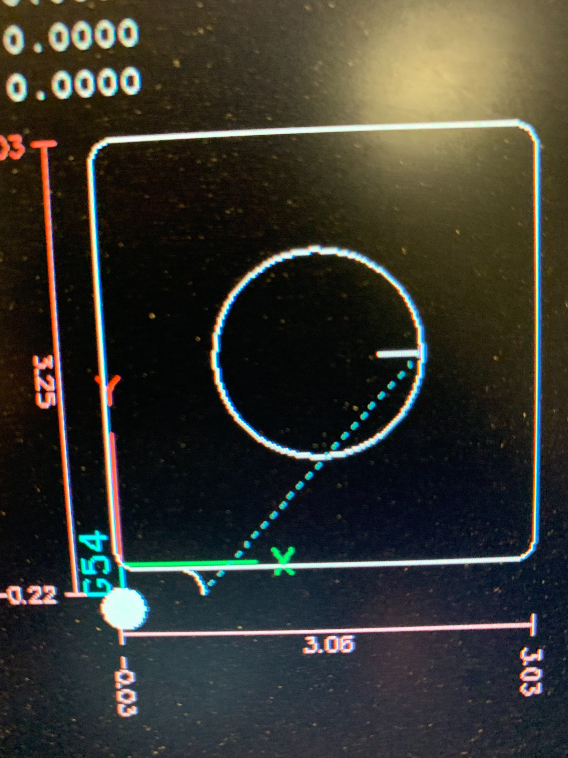

Replied by TexasCNC on topic Anybody using a thermal dynamics CM 52?
It’s not letting me upload a picture
I am using sheetcam and I have it set up on 0/0

04 Oct 2019 02:16 #147076
by phillc54
Replied by phillc54 on topic Anybody using a thermal dynamics CM 52?
Looking at that, X0 Y0 is the bottom left of the square cut.
Do the X and Y DRO's show zero at that position?
Do you have offsets set somewhere?
Can you post the GCode?

04 Oct 2019 02:26 #147078
by TexasCNC
I import the gcode then I home the machine to the bottom corner. Do i need to home the torch first then upload the gcode?

04 Oct 2019 02:39 #147080
by phillc54
After you Home, if the DRO X&Y are zero then that is the position you need the material.
If your material is in a different position you need to jog X & Y to the correct position then "Touch Off" X and Y to that position using the Touch Off button.

04 Oct 2019 02:40 #147081
by phillc54
Have a look at Coordinates at this link linuxcnc.org/docs/devel/html/plasma/plas...de.html#_coordinates
