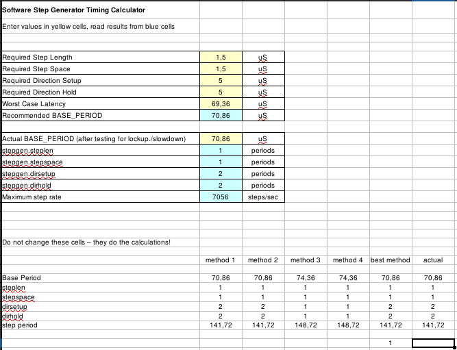

Today I run latency test for a from 8 o'clock to 16 o'clock, watching milling videos on YouTube
, reading LinuxCNC documention...
I finally obtain 69358ns max jitter.
I download StepTimingCalculator.ods file and get this result :
In INI file setup this values :
In HAL file setup this values according to Calculator file :
I get the same latency message when I run LinuxCNC.
What's wrong ?
BASE_PERIOD = 70860
*_VELOCITY = 44.10In HAL file setup this values according to Calculator file :
setp stepgen.x.steplen 1
setp stepgen.x.stepspace 1
setp stepgen.x.dirhold 2
setp stepgen.x.dirsetup 2I get the same latency message when I run LinuxCNC.
What's wrong ?

your base period shoudt be
BASE_PERIOD = 100000
your settings in HAL per STEPGEN /AXIS
setp stepgen.0.steplen 1
setp stepgen.0.stepspace 0
setp stepgen.0.dirhold 45000
setp stepgen.0.dirsetup 45000
if you loadup your ini and hal file we can edit it

I don't understand why I have to use these values. I make test, compute values with the provided tool and you give me something very different.

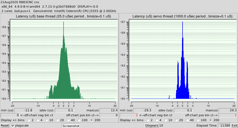

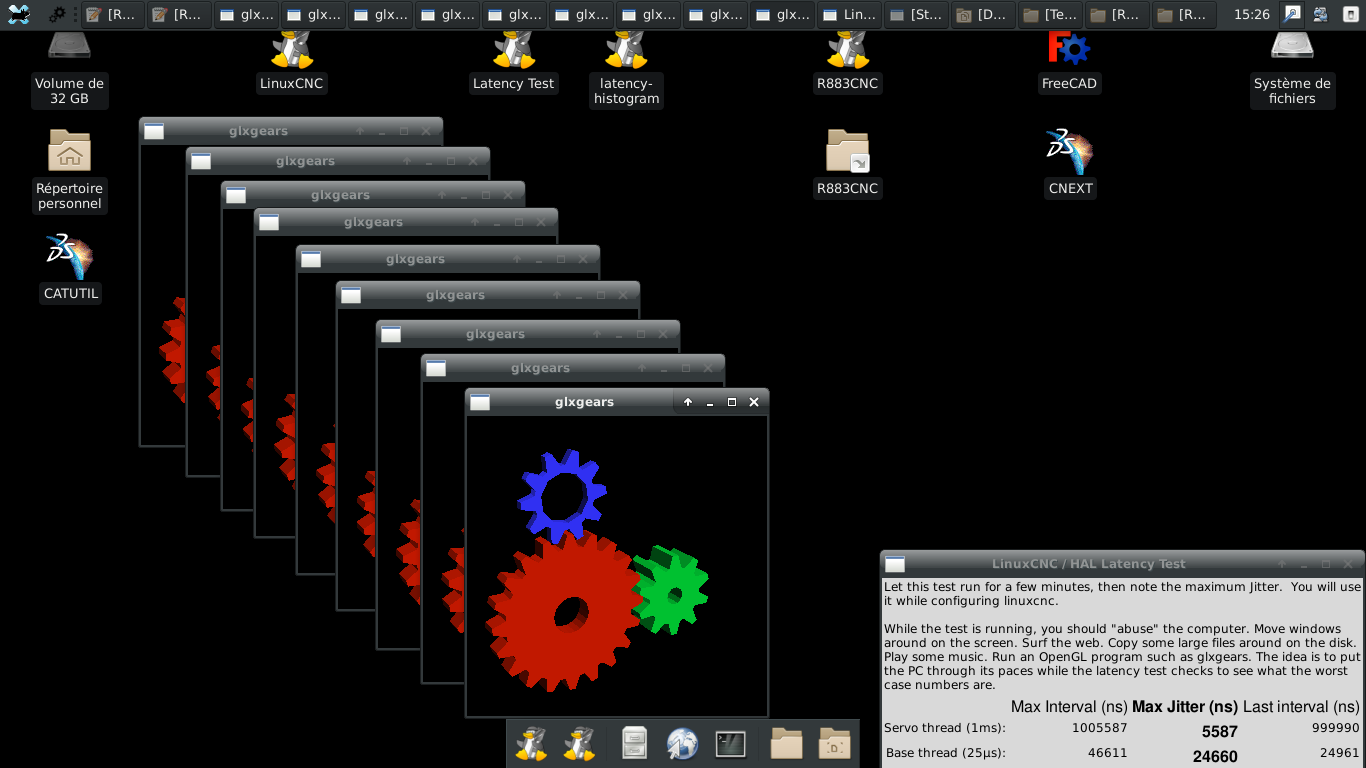

Hi.
Since a couple of day I have make some changes in the BIOS and in GRUB.
The BIOS :
I revert all changes and then turn off every things that can disturb CPU (power save...).
The GRUB :
it is set like this
Then I have run LatencyTest and LatencyHistogram with 1 YouTube video, 10 GLXGears, CATIA over Play on linux and I get this results :
This results are now pretty good for stepping.
I put the worst result in a temporary StepConf aud Copy the result into my Router Conf.
In the next days I will run LinuxCNC and see what happen with Latency Message.
The BIOS :
The GRUB :
it is set like this
GRUB_CMDLINE_LINUX_DEFAULT="quiet isolcpus=1 idle=poll acpi_irq_nobalance noirqbalance"Then I have run LatencyTest and LatencyHistogram with 1 YouTube video, 10 GLXGears, CATIA over Play on linux and I get this results :
