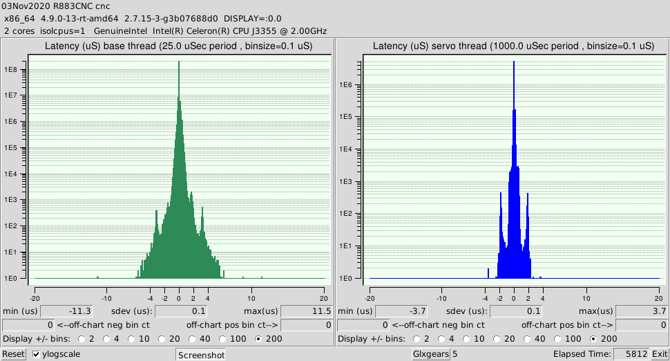

03 Nov 2020 21:03 #188263
by macsddau@linuxcnc
Replied by macsddau@linuxcnc on topic Latency mesage
A good news
After some BIOS or grub adjustment and making a hard stress test a get a pretty good value for base thread.
I will get good feed fate for milling.
Finally this PC configuration is not so bad for stepping. I Will recommend it for is low cost side.

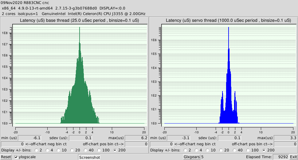

09 Nov 2020 21:21 #188808
- Posts: 21736
- Thank you received: 7427
09 Nov 2020 22:01 #188815
Replied by tommylight on topic Latency mesage
That looks really good.
