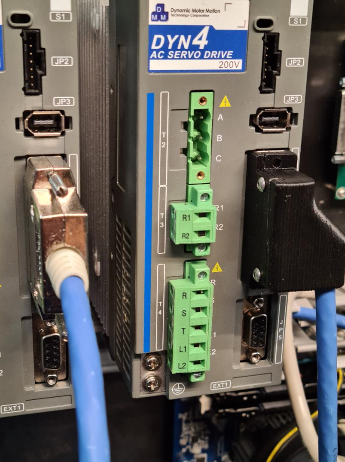

31 Mar 2020 08:11 #162206
by Hytek
Replied by Hytek on topic Need help with component selection
Just a quick message to share my fix for the stiff cable issue. I basically designed & 3d printed up some new backshells for the D-sub 25 connectors. If someone can tell me how to add .stl file, I will add them in case these are of use to anyone else. The attached pic shows the space saved as well as the more desirable cable direction.
And before I forget, thanks for all advice so far.

Ok, for some reason the download all link doesn't work. If you download the 2 files from the 'Thing File' it works.
Even better, add ZIP
