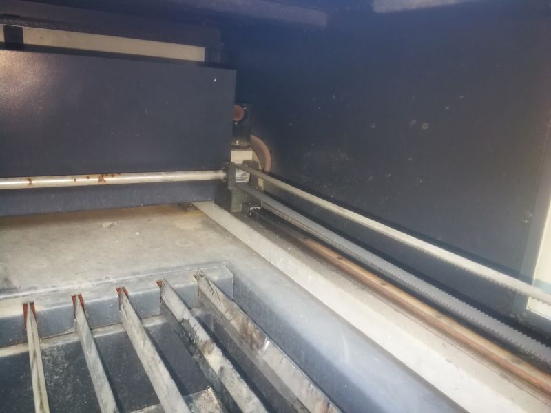

This afternoon i'm going to have a look at the reducers fitted to the frame, and count the teeth or diemeter of the pulleys.
It has only 1 drive for each axis, gantry is moving with a single drive connected by a shaft to the belt drive on the other side, and the head is moving with belt an a reducer as well, i might remove it and put it on the other side to have 2 independent drives for moving the gantry so i'll be able to auto square it.
And end up with a direct drive for the head, as for Z i have a 30cm ball screw availible.
BTW what is the standard for axis naming ? i know Z is the vertical for the head, but Y and Z could be inverted or do we refer to the longest axis ?
My gantry is 1.5m long and the shortest axis has 1.2m rails bolted on the frame. Well my explanations might not be very clear is guess, need more vocabulary.......

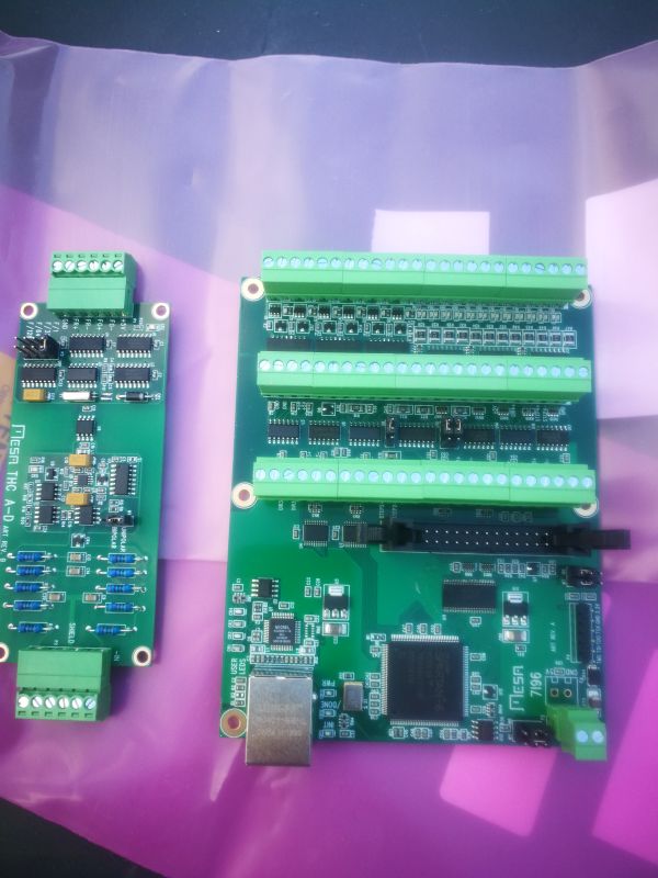

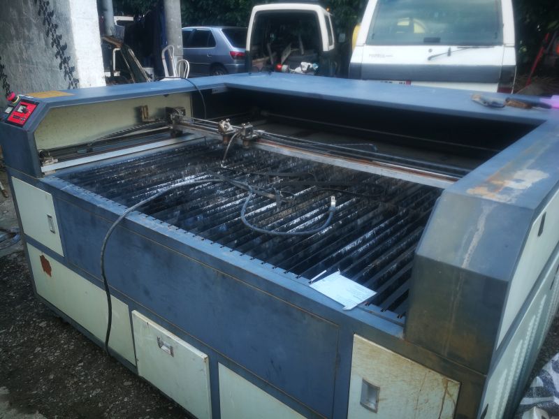

So i got my electronics from Mesa yesterday, so happy about it
7i96 and a THCAD10

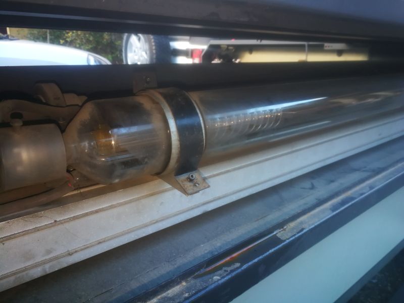

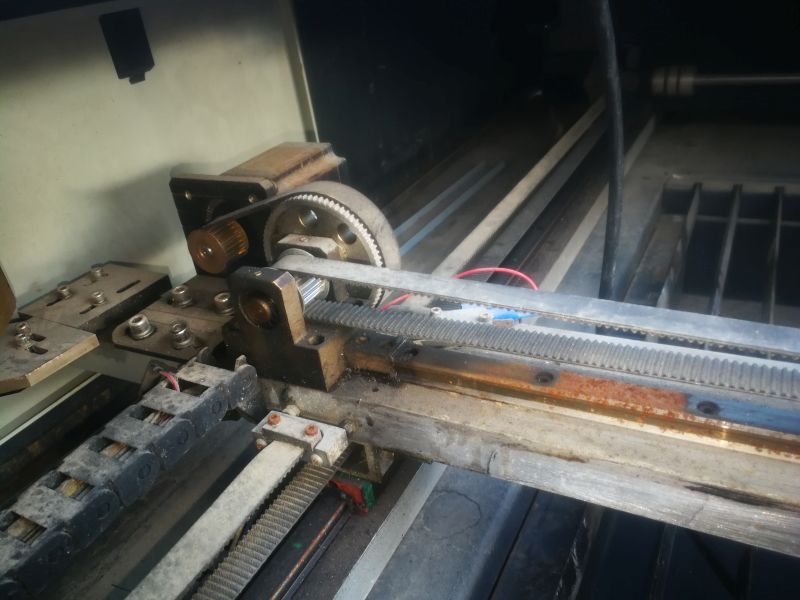

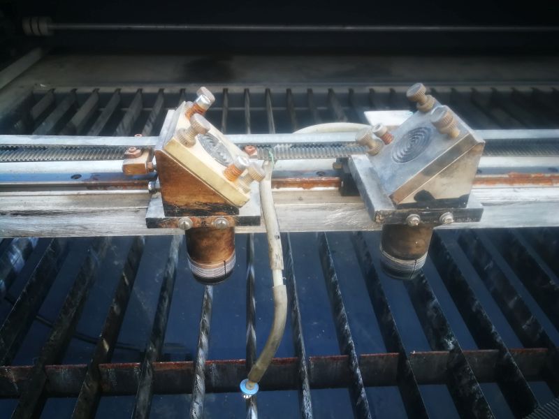

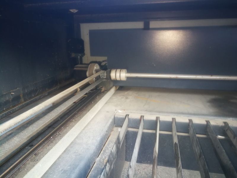

As for the frame, here is the twin laser cutter i'll be using
With the stock motors, i'll change the rails as those are all rusty, and a bigger gantry to hold the Z, going with a 1.5M long 60x120 extruded aluminium profile.

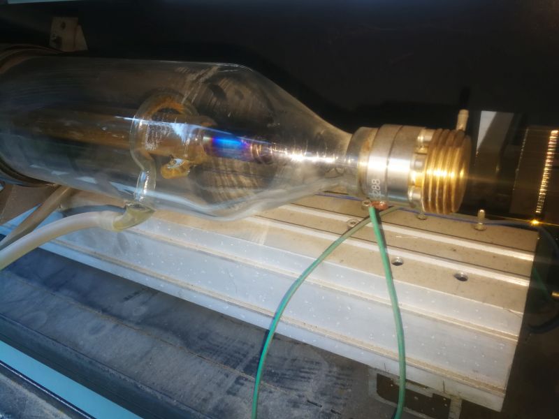

The laser heads and mirrors are still there with the tubes, 150w and 80w, all the electronics will be replaced but i'mkeeping the power supply for the motors and add a 3rd driver for the Z (THC)
By curiosity i'll check if it's the 150w tube or it's supply which is faulty and my be keep or sell them or make a smaller laser CNC.....
7i96 and a THCAD10

- Posts: 21913
- Thank you received: 7466
19 Feb 2020 19:42 #157891
Replied by tommylight on topic new to linuxcnc and building a plasma table
If there was a short torch that would fit inside with the lid closed, that would be nice !
Then again, plasma uses a thick copper cable and that might prove a bit much for the existing mechanics.
You might want to strap a torch there and move it around to check that it holds.
Torch with bent cable form 5 to 20 KG of pressure on all sides.
