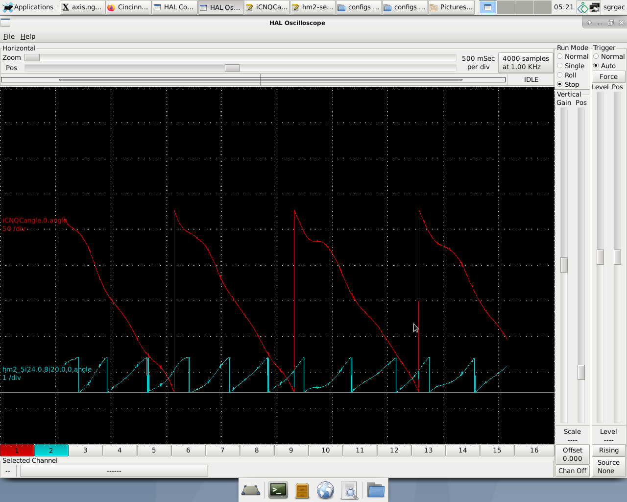

Can you halscope the link between the ICQ component and bldc? That should localise the issue to one or other of the components.
- stegrg
- Posts: 61
- Thank you received: 3
26 Apr 2021 12:04 #207107
by stegrg
Replied by stegrg on topic Cincinnati Milacron Arrow 750 Retrofit
Are you referring to plotting commutation-counts in halscope from the following link in hal?:
net commutation-counts iCNQCangle.0.angle => bldc.0.rawcounts
- Posts: 19896
- Thank you received: 4648
26 Apr 2021 12:22 #207110
Replied by andypugh on topic Cincinnati Milacron Arrow 750 Retrofit
Yes, that looks useful.
If you get it, then save the halscope plot to a data file so that I can look at the actual numbers. (there is an option in Halscope to save to file, sadly no option to read from file)

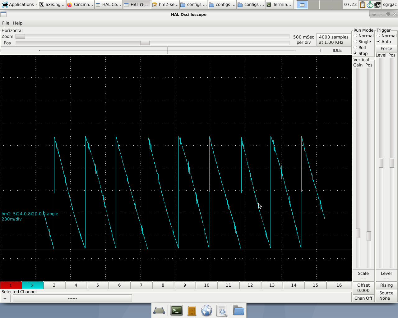

27 Apr 2021 12:40 #207219
by stegrg
Andy,
I managed to figure it out. It turns out it was in fact my iCNQCangle comp file causing the issues. I wrote the comp file to roll absolute rawcount encoder values back to 0 once maximum readings per revolution were achieved (that were initially 2048 and then subsequently reduced to 256). After I switched to gray-code within the Hostmot2 SSI function, I noticed that the absolute encoder value doesn't roll to zero after maximum readings per revolution were achieved. Instead it keeps counting up or down past the readings per revolution until it maxes out the S32 bit data type, I'm guessing.
I think the way I was going about this initially caused issues with bldc comp because it wasn't expecting the rawcount encoder values to reset to zero after maximum readings per revolution were achieved.
Here is a plot of the 8i20 angle. Notice it doesn't have the sudden signal drop anymore.
Next step is getting the axis setup in Linxucnc and the servos working in closed loop.
Thanks for the help everybody.
