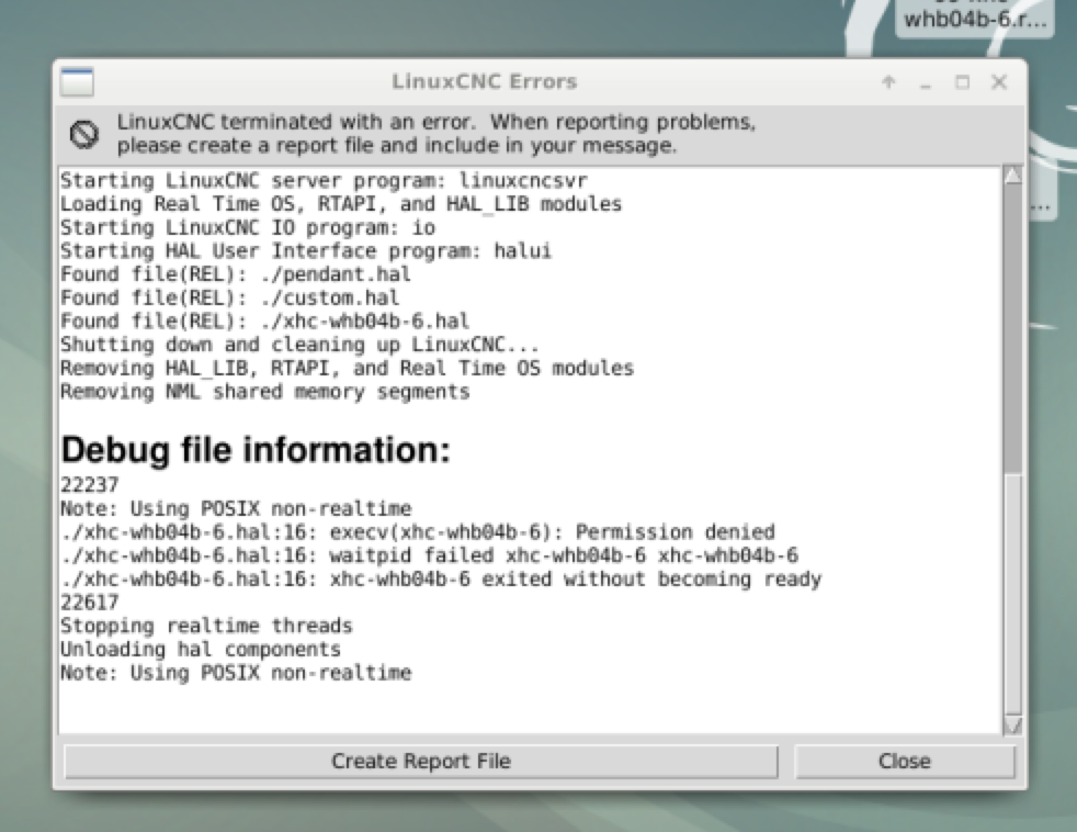

I tried this, but I have an error message during startup.
See the screenshot.
See the screenshot.

07 Apr 2020 20:18 - 07 Apr 2020 20:26 #163089
by alkabal
Replied by alkabal on topic Pendant WHB04B on LinuxCNC 2.7 / Debian
It is XHC-WHB04B-6 or XHC-WHB04B-4 ?
have you do : You need to copy the files "99-xhc-whb04b-6.rules" in the folder /lib/udev/rules.d
i think the error is related to this rules file because you have error waitpid displayed, if your device is XHC-WHB04B-4 i haven't test this one but i can try to compile a version with correct PID/VID with another rules file
in your ini you need to have something like this :

07 Apr 2020 20:29 #163092
by Peterdeleu
Replied by Peterdeleu on topic Pendant WHB04B on LinuxCNC 2.7 / Debian
It is a XHC-WHB04B-4.
The rule file is in the /lib/udev/rules.d folder.
But I don't have the HALUI in the ini file.
Do I need to ad this?
[HALUI]
MDI_COMMAND=(debug,macro0)
[HALUI]
