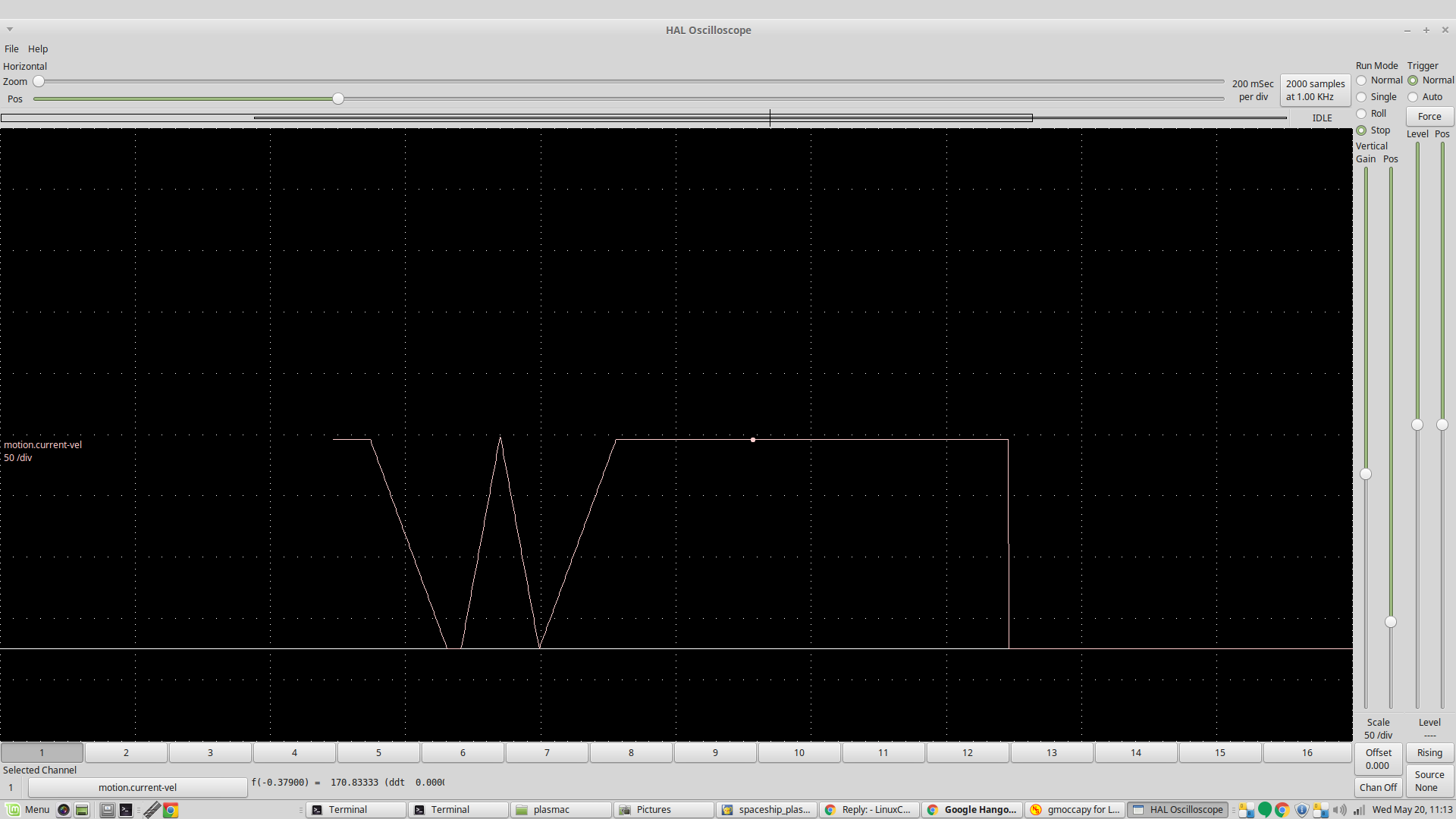

This is the first time, I really want to measure elapsed time in Halscope. So if it says 200 ms per division, is that between the smallest tick or is it between the vertical lines.
The graph shows current velocity for a move on my plasma machine from a standing start to 10240 mm/min (170.667 mm/sec)
So the question is, how long does it take to get to speed? I read this as 2.3 seconds (assuming the smallest tick = 200 ms)
But maybe its 230 ms
Help please?

Replied by PCW on topic Halscope scaling
The major divisions are what time/division refers to.
The small divisions (tics) are 10 per division (so every 20 ms)
(so it gets to speed in 230 ms)

Replied by tommylight on topic Halscope scaling
Just did some tests, came to the same conclusion as PCW, as i noticed you used a different sample rate, so was not sure if that affects the readings, but as it should, it changes the time per division.
I was wondering why you were mentioning that same 2.3 seconds before somewhere else when all i could see was 230ms, but since you used halscope more than me, i did not doubt your results. I should have, shame on me !
What is the acceleration set at?

19 May 2020 21:11 #168300
Replied by rodw on topic Halscope scaling
Thanks guys. it was my bad.
But the next question is that if I have the acelleration in my ini file set to 1500mm /s/s so it should have got to speed in 114 ms.
So why in hte real world am I only getting half? Is this where a better quality stepper drive would come into play?
Sounds like I need to change my ini file to be 750 mm/s/s and retest.

19 May 2020 22:20 - 19 May 2020 22:21 #168309
Tommy, yes, thats the same maths I did but without the proof
And I checked myself on this calculator
www.smartconversion.com/unit_calculation...tion_calculator.aspx
So restating it, by halscope, the acelleration was about 742 mm/s/s when I had 1500/mm/s/s in the ini file
So where did the other 50% go?

20 May 2020 01:22 - 20 May 2020 01:25 #168330
Replied by rodw on topic Halscope scaling - Axis Acceleration behaviour
So I got to work and had to check this out.
At first I thought it may have been some legacy external offset ratios in the INI file so I played around for a bit with that. They worked as expected. Then I took deleted the OFFSET_AV_RATIO from the X & Y axes
So I halved the velocity to 750 mm/s/s and the time to speed doubled
So then I doubled the velocity to 3000 mm/s/s and the time to speed halved
But it is not going to speed at the max acceleration
So I set the STEPGEN_MAXACCEL to 6000 (double 3000) in case that was limiting but it made no difference
It is consistently only acellerating about 50% of the maximum you allow.
So does it keep some acceleration in reserve for dealing with short sharp segments while cutting?
Any Ideas welcomed.
Any Ideas welcomed.
