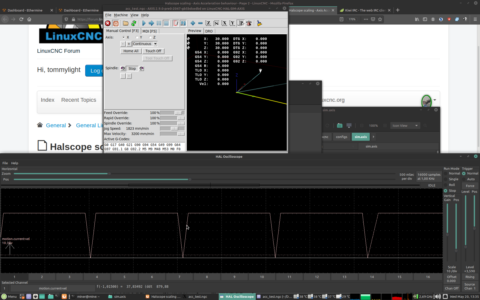

Same result using axis mm sim, half the accel on the graph.
I think we are missing the point as the acceleration is a function of 3 variables, and we are looking at only two on the graph.

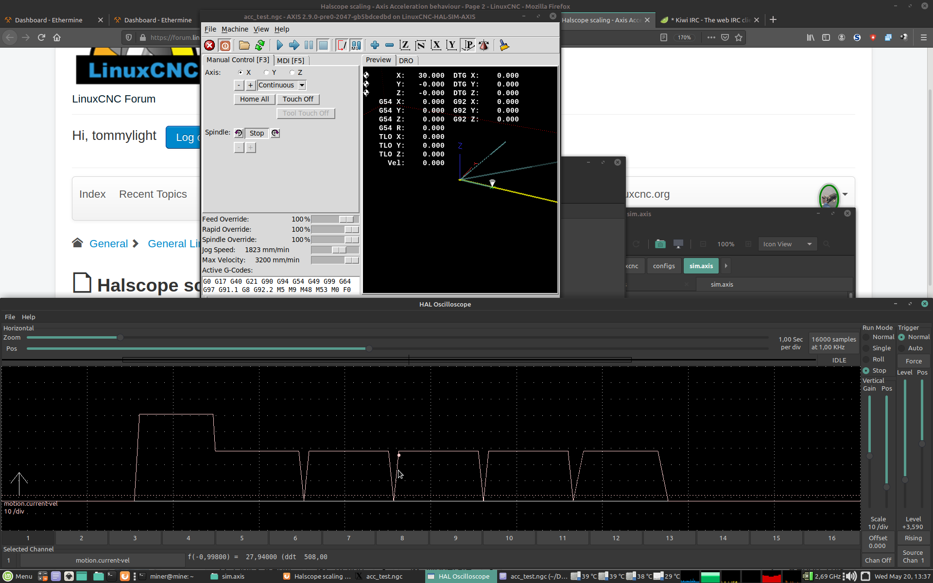

That was all from MDI, this is from gcode:
Max_acc set at 508 in sim, velocity max at 30.48, moving all 3 axis at the same time, same distance of 20mm, it goes over 508 set in ini:
All axis going back to 0 and then only x axis moving 20mm, there is the 508 we are looking for:
So to recap, in MDI it accelerates at half the set limit, while in gcode it does accelerate at the set value in ini.

Its hard to work out from the screen dump, how far over the max accel did it go?
Actually when I think about it if X & Y are both moving at Max-vel for their axis, the total accel has to be over the individual max-vels

879.88 while moving all 3 axis.
508 only x
508 is set in ini as the max accel.
508 only x

That does make sense, if X & Y are both acellerating at 508, the resulting total Accel has to be higher! You could work it out with resolution of forces but my brain hurts. It should be a 45 degree angle so I think its something like 508 * sin(45) +508 * cos(45) but that does not make it to 879
- Posts: 18111
- Thank you received: 5330
20 May 2020 13:38 - 20 May 2020 13:42 #168380
Replied by PCW on topic Halscope scaling - Axis Acceleration behaviour
if all 3 axis accels are 508, and the overall acceleration is not bounded,
say by MAX_LINEAR_ACCELERATION, acceleration in all three axis
can be sqrt(3)*508 =879.88
Last edit: 20 May 2020 13:42 by PCW. Reason: clarify

The ini settings are used for GCode, MDI commands do seem to use 1/2 of the acceleration settings

Yeh I had a thought overnight. I was using relative commands so maybe they are planned the same way as MDI commands.
Also there is Simple trajectory planner used for jogging. I wonder if it used for MDI and relative commands? More testing later today.
