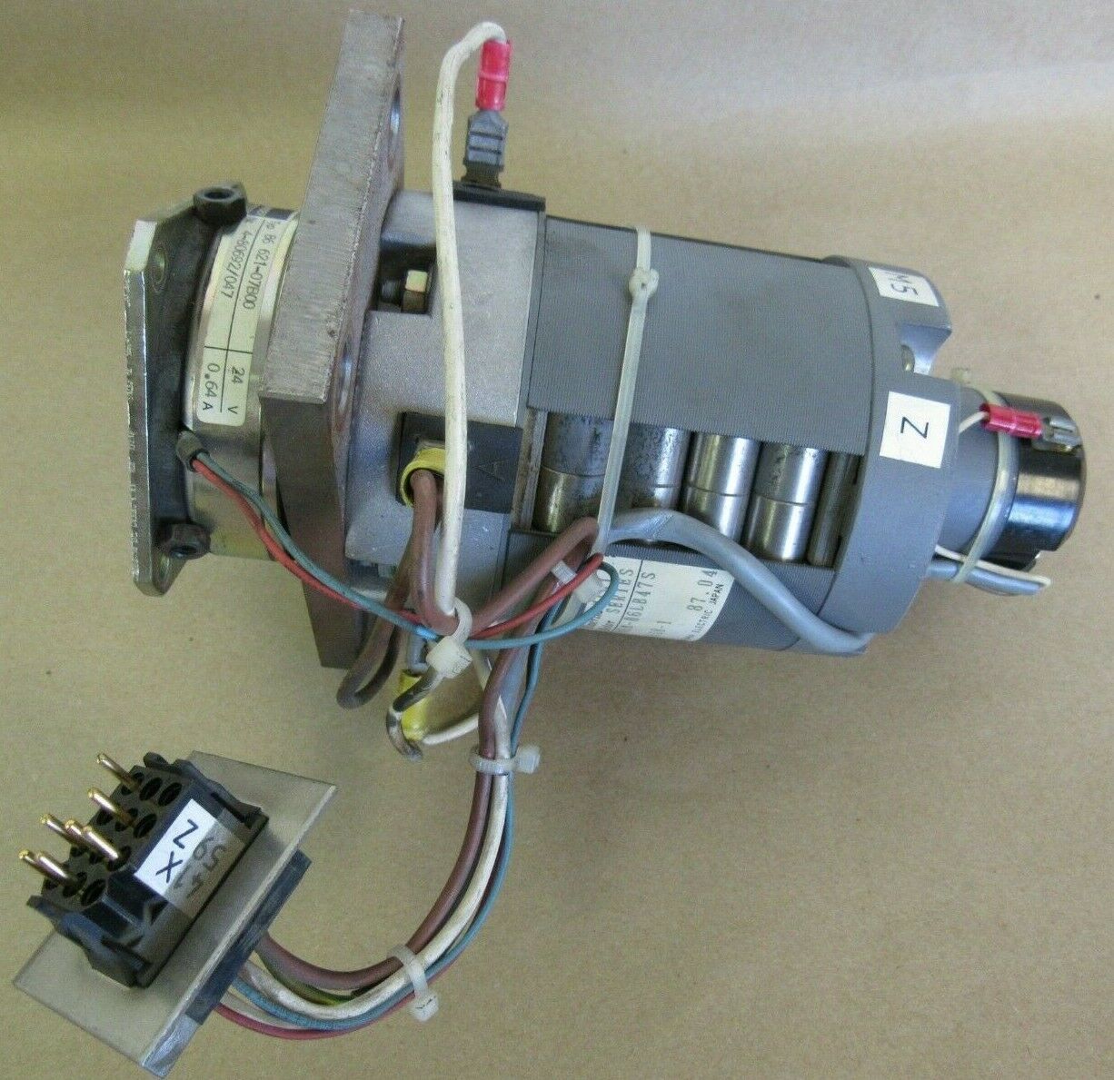

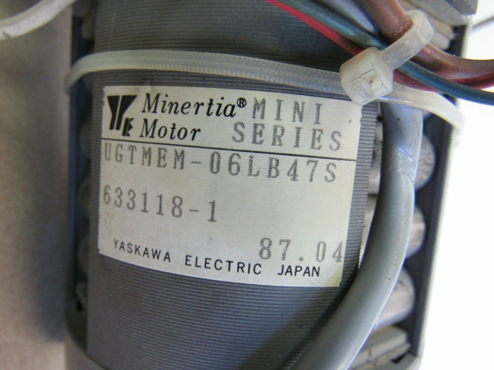

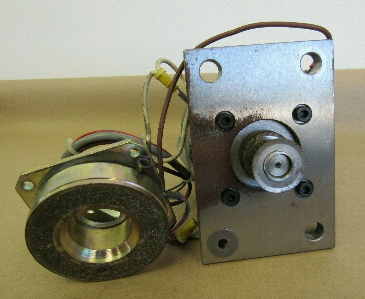

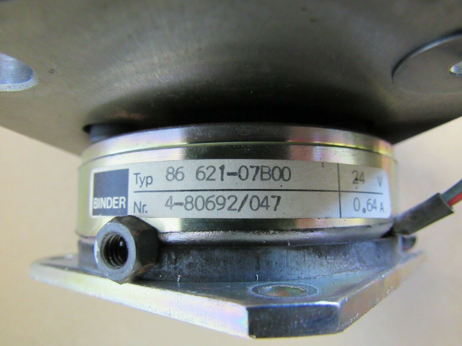

I found some picture on ebay of this motor based on the part number on the label.
ABB UGTMEM-06LB47S Servo Motor 6.1A 235V
I also found a pdf on the manufacturer website. I don't see the exact model on the pdf though.

No need to tear the motor down I think we have the dimensions in the last page of the pdf file.
But we will open it to check the dimensions though.

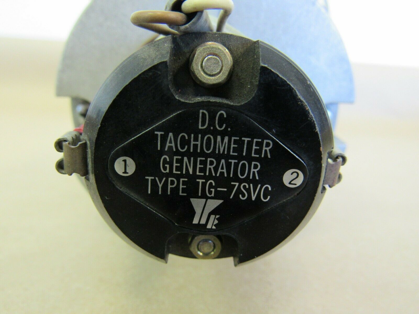

Yes that small part above the motor is the tacho, that should be replaced by an encoder, and new shielded wires from them sent to the control box.
OR <<<<<<<< This is OR,
If you can afford to get the new motor and drive i linked by the end, that would make wiring much easier for you as you would need only 4 unshielded wire to the motor, so no grounding and shielding problems, and much easier to install and setup, no tuning required, etc.

OK for the more expensive route and easier setup.
This means the whole part in the bellow picture will be removed, right?
Do you confirm the one on the list is of the right dimensions/specs?, Just checking

Replied by tommylight on topic Esab Ultrarex UXD-P2000 Upgrade Project
Yes that is correct, that assembly goes out if you go the expensive route.
The DB25 connector is a must. The plates and the 7i84 are not a must have, but instead of plates you can get the raisers for the 7i77 for mounting it to a DIN rail as you will also ned some of that DIN rail to mount the relays.
