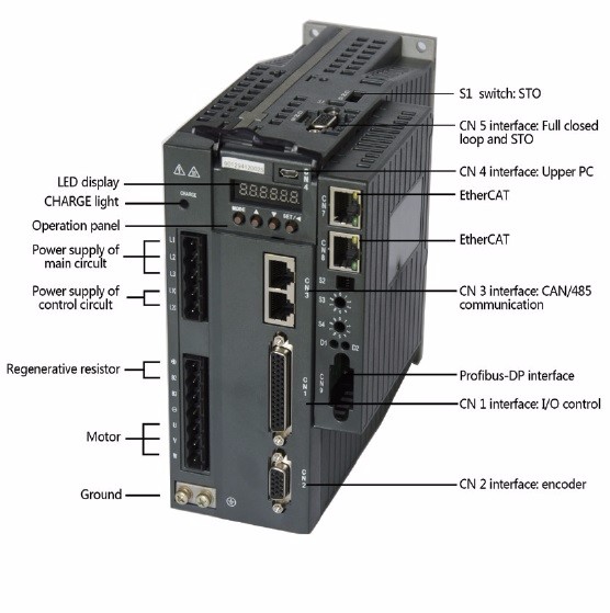

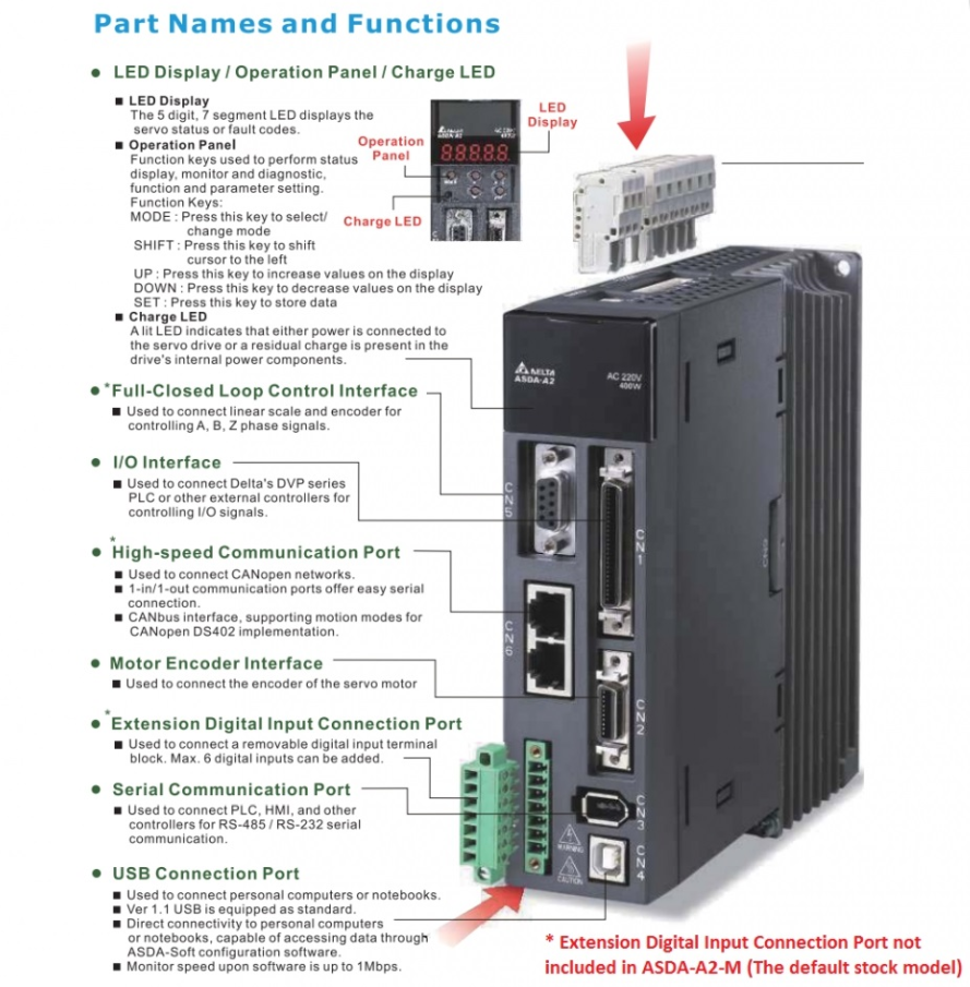

Here is an example for the ASDA-A2
This is another Servo drive company called INVT (I like this servo motor drive because they has the same price as DELTA servo drive price, except that the DELTA motor has 20bit encoder and the INVT has 23bit motor encoder) If you could give me your opinion on those two drivers that would be nice.

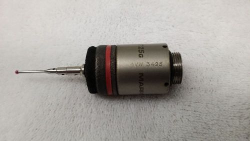

Also, I bought MARPOOS touch probe T25G

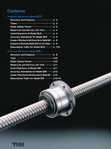

Those are parts you buy when building a 5 ton machine, and a fast one at that!1) I bought so far HIWIN linear guides for all my axis.
I bought THK Ball screw:
2) For Y-axis THK BLR3232 rotary ball screw.
3) For X-axis HWIN 2020 ball screw
4) For the Z-axis THK SBK 1616 ball screw
5) Aluminium 4080 extrusion profile and 80160 for my gantry.
6)MARPOSS
So aluminium extrusion is to weak for those parts, as the ballscrew alone will weigh more than the extrusion.
Still, very nice parts, for sure.
