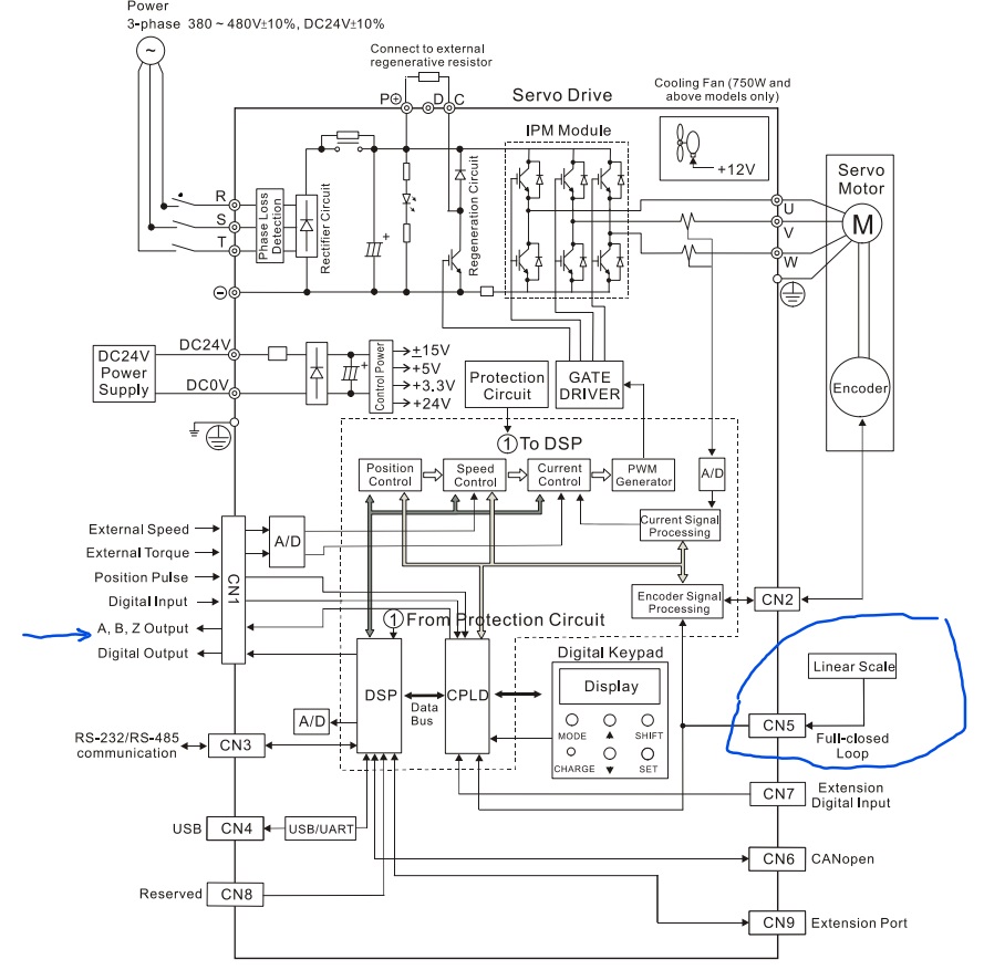

Just for clarification. When you said, "you need to connect the encoder PASS THROUGH from the drive to the mesa board," How this is gonna happen? There is an encoder output pins in the I/O CN1 in delta drive, is it through those pins? Or from the 2nd encoder CN5 to 7i77?
Can I use my 2nd encoder input TO CONNECT my linear scale direclty to the drive instead of connecting it to Mesa 7i77 or 7i76e? Or do I have to get 7i85s? Because that 2nd encoder in the Delta drive is solely for linear scale... I don't get it.

cn1 is the pass through. cn5 is an encoder input, for an encoder that isn't on the motor - like a linear scale, or if you are deviating from the standard delta motors.

So, the advantage of A2 Delta drive is that it has 2nd encoder for LINEAR SCALE like HEIDENHAIN or rls.
I have checked the B3 Delta and you completely right, they have a really fast response bandwidth and a 23bit except it doesn't have a 2nd encoder like the A2. Moreover, I got a quotation for the B3 and they are cheaper than the A2.. Also, I'm looking at the A3 series and they look awesome, but I don't know how much it cost yet.

On the lack of linear scale on the B3 - you wouldn't not want that scale going to the drive anyway, youd want it going directly to the control. its only really useful in the drive when it is commanded by position directly (as in, go to x5.345, and not a step by step command).
