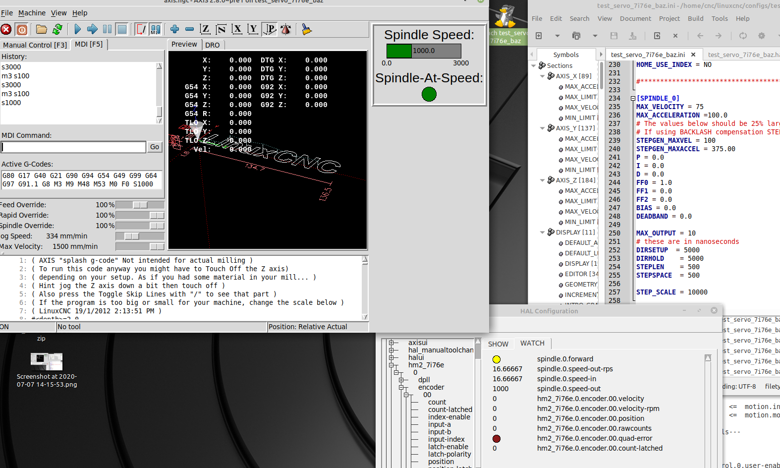

This is on my test bench. 1.8Kw servo in position mode I think connected with step/dir on a 7i76e
I believe the encoder is 2500 p/r
It seems to be running OK ie. commanded speed 1000 and the spindle dro is the same and checked with a rev counter.
But don't see the encoder working. Also the spindle at speed is not working (probably due to the encoder not giving feedback)
I need the encoder feedback for rigid tapping
Does the ini file look correct for the spindle?

There is nothing related to spindle encoder in the hal file.
Open pncconf and choose to modify an existing config, add the encoder as spindle encoder, and do not set a spindle at speed input, that should be generated by the encoder velocity.

Ok spindle is commanded 1000 and it is doing 1000 the spindle dro is zero

I still don't see any encoder life from the show hal config. Any clue to what am I missing?

The commanded velocity is working properly, but there is no feedback at all as can be seen by encoder.0.velocity that stays at 0, it should also show 1000 if the scaling is correct.

The encoder A and B don't change
Jumpers in RH for diff. Step/Dir on TB-2 20,21,22,23 No field power supplied only 5V on P3 .Nothing else connected to 7i76e

Edit : with the encoder disconnected from the mesa card ie measuring the encoder outputs I get about the same results as above.
So I wonder if the servo encoder output is not setup properly?

You should measure ~+3 or ~-3 across the A,B differential pairs
(and never close to 0) if you wiggle the shaft around to see all
quadrature states
