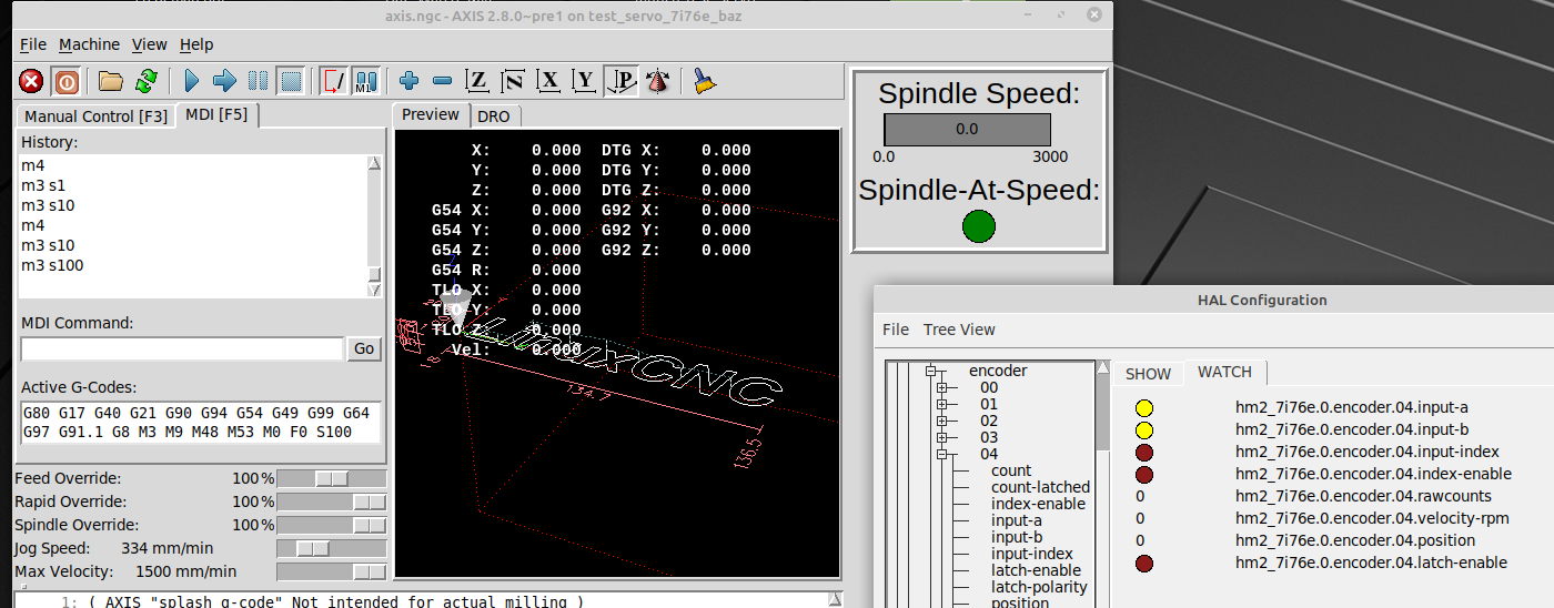

So I should see around 3V across a pair but I am only seeing about 17mV with the servo doing 100 rpm but 3V when stopped
Is that correct?
Replied by Clive S on topic Using a Servo for a Mill spindle 7i76e
You should measure ~+3 or ~-3 across the A,B differential pairs
(and never close to 0) if you wiggle the shaft around to see all
quadrature states
Thanks Peter
Is that correct?

08 Jul 2020 17:27 #173999
Replied by PCW on topic Using a Servo for a Mill spindle 7i76e
That sounds correct (because the signals should alternate between about +3 and -3 so the voltmeter will average this to ~0 when moving)
What firmware in on the 7I76E? (the encoder mapping can change depending on
the installed firmware)

Ah light bulb moment I was playing with this servo before connected to a 7i85s so I will have flashed it for that card.
Now I am just using the 7i76e using the encoder on TB-3

Last edit: 08 Jul 2020 18:17 by Clive S.
- Posts: 18111
- Thank you received: 5330
08 Jul 2020 18:48 - 08 Jul 2020 18:49 #174007
Right so if you are using that firmware, the 7I76Es local encoder is encoder 4...
Last edit: 08 Jul 2020 18:49 by PCW.

Ok I have not got the 7i85 card plugged in. Also got no field power connected.
Will I have to changed the load line in the hal file to encoders =5 and change all the encoder bits in the hal file from encode.00 etc to encoder.04 etc

loadrt hm2_eth board_ip="10.10.10.10" config=" num_encoders=5 num_pwmgens=0 num_stepgens=5 sserial_port_0=00xxxx"
# ---Encoder feedback signals/setup---
setp [HMOT](CARD0).encoder.04.counter-mode 0
setp [HMOT](CARD0).encoder.04.filter 1
setp [HMOT](CARD0).encoder.04.index-invert 0
setp [HMOT](CARD0).encoder.04.index-mask 0
setp [HMOT](CARD0).encoder.04.index-mask-invert 0
setp [HMOT](CARD0).encoder.04.scale [SPINDLE_0]ENCODER_SCALE
net spindle-revs <= [HMOT](CARD0).encoder.04.position
net spindle-vel-fb-rps <= [HMOT](CARD0).encoder.04.velocity
net spindle-index-enable <=> [HMOT](CARD0).encoder.04.index-enable
Still no joy. servo is running at 100rpm

Sorry the on card encoder is the last one (encoder 8)
- Clive S
- Posts: 2204
- Thank you received: 486
08 Jul 2020 19:40 #174016
by Clive S
No need to be sorry its a big learning curve but I am getting better.
Success. That was it . What is the name of the standard bit file as it seems wrong to have 8 encoders loaded.
Many thanks.
