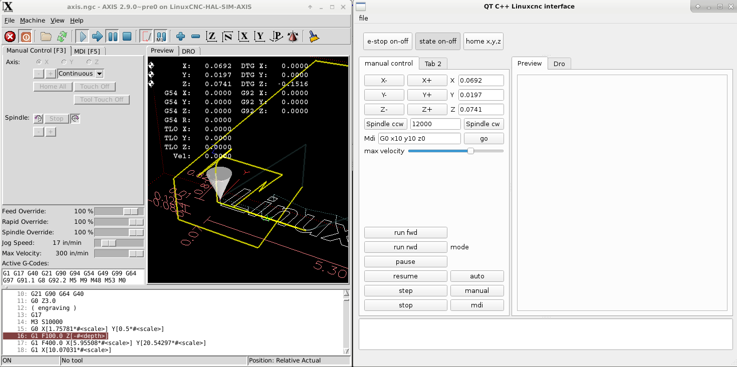

Replied by Himarc3D on topic LinuxCNC for automation
Today did some work on the opengl, source code attached.
The toolpath preview (simulator) is doing a very nice job so far.
For gcode preview i have to write some extra code.

- Grotius
- Posts: 2419
- Thank you received: 2349
05 Aug 2020 21:36 - 05 Aug 2020 21:50 #177425
by Grotius
Replied by Grotius on topic LinuxCNC for automation
Hi Himarc,
The buckie videos on youtube are nice to follow.
If you compare buckies examples to my code style, you will see i use header only if possible.
Most of time i use a header file to do calculation's instead of a class wich contains a .h and .cpp file.
Private, public and so on don't interest me. The only thing that interest me is a compact program that does the job.
The downside of header only is, sometimes you cannot include a header twice in the same program.
Qt, look at : refractor -> rename under cursor
Qt, auto indent selection
For documentation i learned to use the standard c++ library (std) as much as possible. So when i can avoid a qt library i do so to
make program's more cross platform compatible.
If i need to know something about c++ i google for a example.
Good luck. What will you write for a program, will it contain a graphical interface with opengl?
