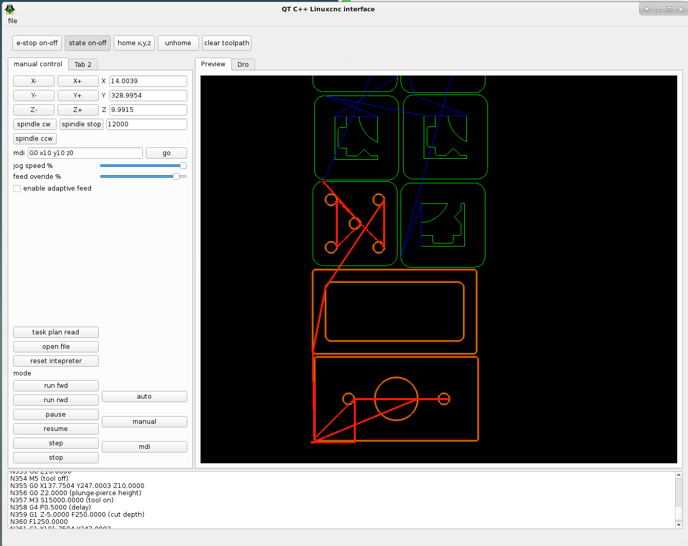

Today added the gcode preview into the opengl. I think you can call it a gcode parser. It works fine.
If you replace in the axis.ini file :
# Name of display program, e.g., axis
#DISPLAY = axis
DISPLAY = QT_Lcnc_interface
It will start as stand alone gui if the QT_Lcnc_interface file is in the bin folder.
Source code is attached.

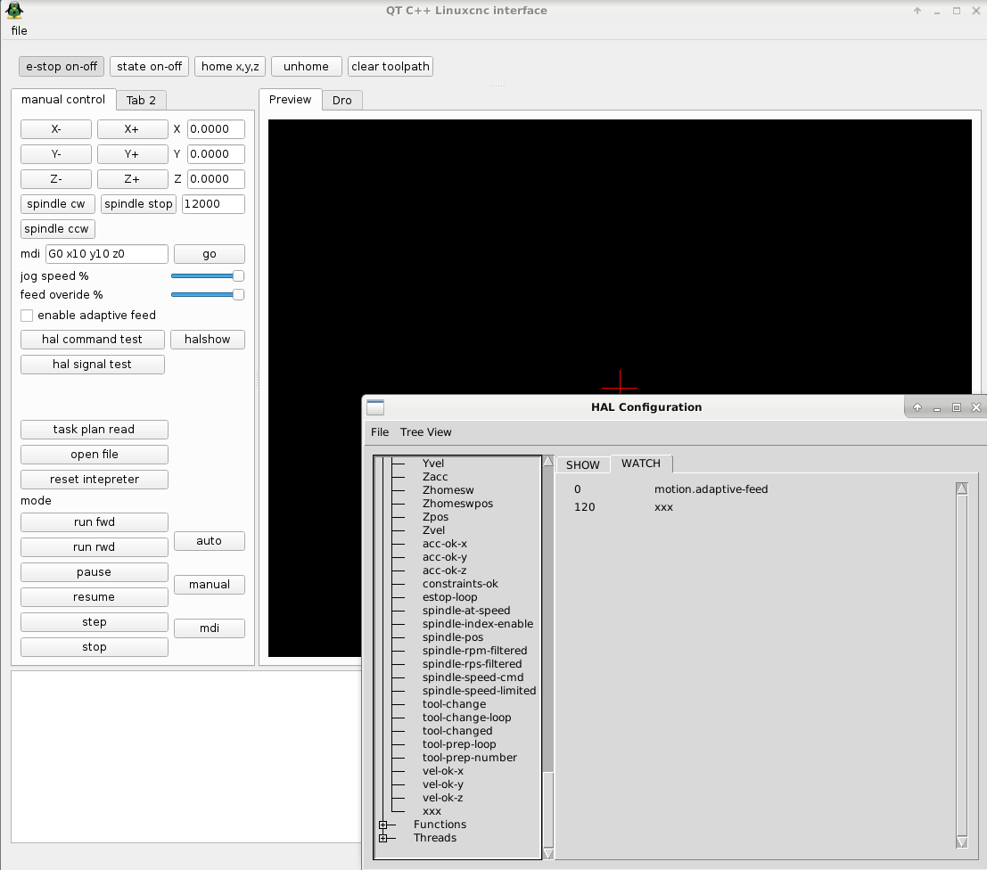

I think i can use some help. A few c++ commands are not working :
-feed rate override
-max feedrate
-adaptive feed
When calling those functions i get error : ../linuxcnc/include/emc_nml.hh:548: undefined reference to `StateTag::StateTag()'
C++ code looks like :
It looks like m.tag has to have a value and be part of above code. But wich value must the tag have?
Tag is abracadabra for me.
Any idea's?

Today i did some work to try to connect the c++ app to hal.
I got no luck the first hours.
Then i decided to copy parts of the c++ halcommand code into my app to see if we can get lucky.
And that worked.
Now we can set pins, signals and parameters, etc very easy from c++
Look in the attachment, for hal/halsextion.h, the code is still raw, but is working.
Here we fill in the "name" and the "value" of the component and we are done !
//sets means set signal
int do_sets_cmd(char *name, char *value)
//setp means set parameter
int do_setp_cmd(char *name, char *value)
To save copy time i did make a symbolic link to the linuxcnc/bin folder from my qt compile directory.
Otherwise i had to copy the new compiled executable every time to the linuxcnc/bin folder.
Also added halshow to the app, so we can check the port and pins.
Tested 2 signals, set parameter motion.adaptive-feed from 1 to 0.
Set up a signal in c++ code, named xxx, change value from 0 to 120.
Source code attached.

Okey i did write some code today.
1. The gcode preview is now interactive with the program.
2. We got several status connections now.
3. The most of the gui buttons and sliders are working except : spindle + and -, program reload.
4. The c++ code i refined some bit to make it usefull for beginning c++ users.
For every linux command or call i made a function. So for mdi command you simple write in c++:
mdi("G0 X0 Y0");
Just take a look at the code. If you want to try the app. You have to download QT c++ and open the project file.
When compiled place the executable file into the linuxcnc bin folder. Change display in the ini file to executable name and
you are done!
Result for today.
Edit : For latest code update :
github.com/grotius-cnc/QT_C-_Linuxcnc_in...ithub_screenshot.png
The most of code is done. Read the readme file for my comments.
mdi("G0 X0 Y0");
you are done!
Result for today.
