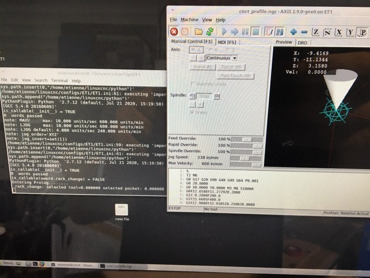

OK so it is running prolog as I suspected because of print statement in rack_change.ngc and it prints Entering Prolog print statement I put in there but it never runs change_epilog.
Can someone else verify this?

I am trying to make sure it is not an issue I caused with config. But I have exhausted all possibilities. I even reinstalled via debs the latest 2.9. Still same issue.
I am also getting this when I load linuxcnc with remap M6 enabled.
I dont know what this means....lol
I put prtint statements in prolog and epilog and in ngc file. It prints the statement prolog and ngc file but never hits epilog.
