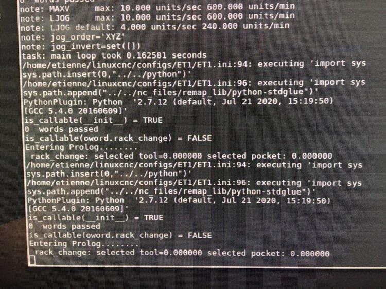

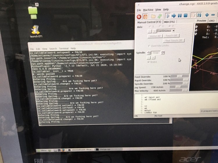

It is sayoing the oword ngc's are not callable. I even gave them absolute path.
Replied by bevins on topic ( Solved ) Issues with python plugin for remap
distribution change is the least likely cause.
can you confirm the sample sim/axis/remap/extend-builtin works?
I then added print statements to nc_files/remap_lib/stdglue.py 's
change_prolog and change_epilog.
They both printed when I ran the default program for that sample from 2.8
This is running the epilog because it is printing my print statement.
This would prove the underlying code is working.
I will check this tonight, but did you run this on machine or simulator?

Last edit: 03 Aug 2020 23:44 by bevins.

here is the terminal when I run the sample:
Note that it mentions adding the path to python-stdglue. Your printout doesn't mention that.

113246211Note that it mentions adding the path to python-stdglue. Your printout doesn't mention that.
Are you using the python-stdglue or have you coded something specific?

I have my stdglue in python folder in linuxcnc folder which it gets referenced. If I remove it it wont run saying cant find it.
I cannot use the append ../../nc_files/remap_lib/python-stdglue because it says it cant find it when I do. It is there though.
I can run the sim no problem with both the rackchange and extend-builtlins.
I tried it all different ways. I think the issue is it is saying the oword subs are not callable even though it runs them.

I notice this O sub doesn't have a endsub ... is it there?
Replied by cmorley on topic ( Solved ) Issues with python plugin for remap
Here is my rack_change.ngc
o<rack_change> sub M73 (auto-restore modal settings on return) ;(print, rack_change: loaded tool=#<_current_tool> current pocket: #<_current_pocket>) (print, rack_change: selected tool=#<_selected_tool> selected pocket: #<_selected_pocket>) m2
So there is basically nothing in it. It does do the print statement but never continues on like it didn't run the epilog, which is a python thing,,,,.. WTF am I missing?

04 Aug 2020 02:31 #177160
by bevins
No its not there. I stripped out the oword when I was having issues.
I'll see if this changes things.
you didn't answer my last question
- bevins
- Posts: 1942
- Thank you received: 338
04 Aug 2020 11:21 #177215
by bevins
Yes that was it. I guess I was having two issues chasing one while the other obvious also.
Sorry for wasting your time Chris and thanks for the help.

04 Aug 2020 12:36 - 04 Aug 2020 12:38 #177229
by bevins
The sim is correct. I stripped the sub in an effort to dumb it down so I could find the issue and I left out an important piece that made troubleshooting even more difficult.
The actual original issue was a path and permissions issue.
Awesome work guys. I wonder if the sim can be updated for the next guy?
