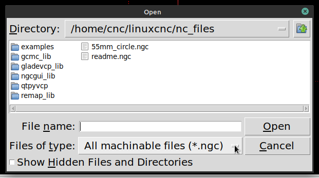

Short answer rename file.nc to file.ngc. That's assuming it's a plain text file.

Why not simply add .nc in the ini file?
linuxcnc.org/docs/2.8/html/config/ini-config.html passus 2.3

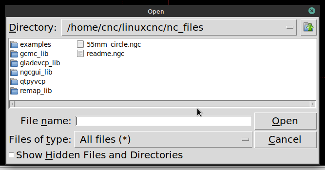

Hey Tommy, I tried doing what you said but this pops up when I try to open it. How can I fix this? Thanks! It won’t let me attach the image but it says “File ended with no percent sign or program end”

Edit the .nc file with a text editor and just add
or
M2
at the of the file and save.
Try to open again with LinuxCNC.
or
M2
