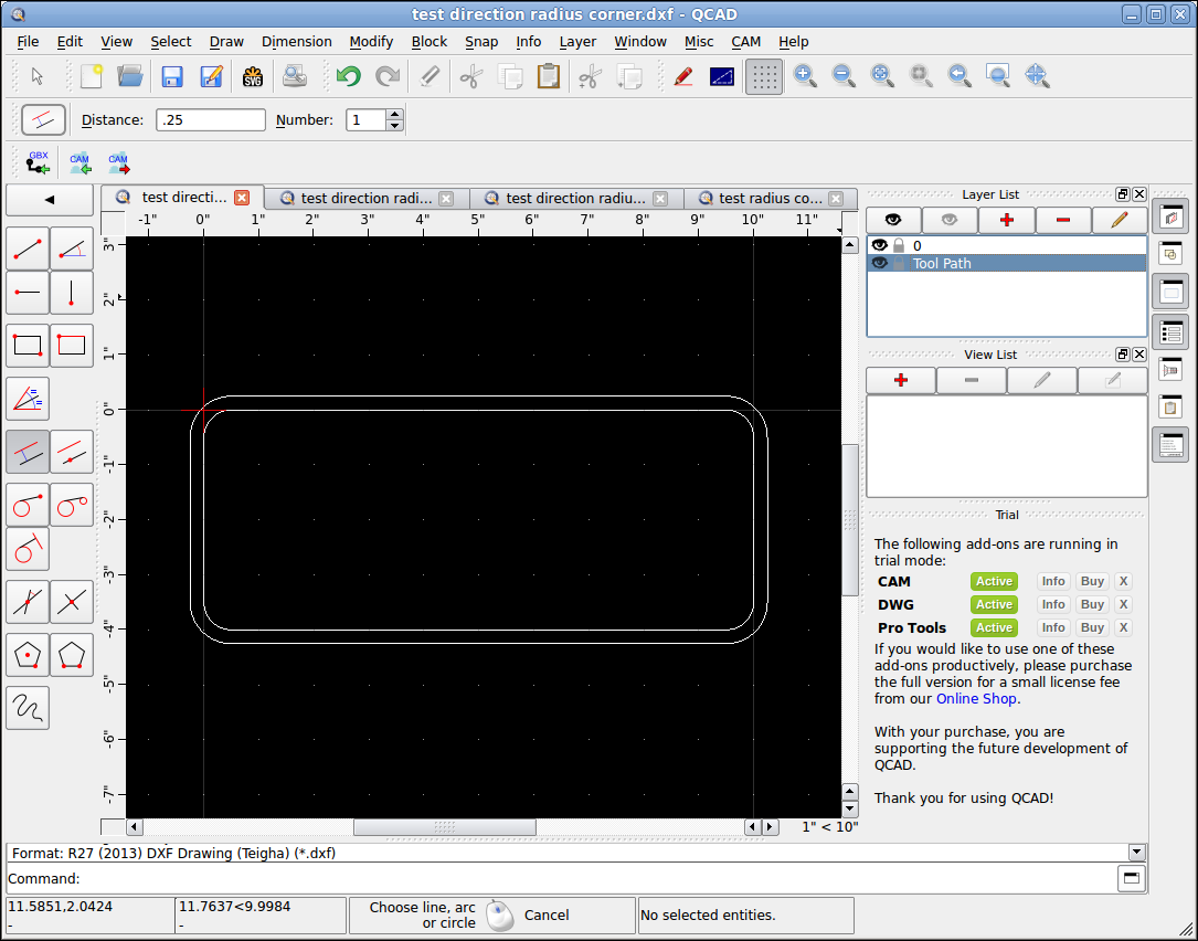

QCad CAM was created by BigJohnT
QCad 3
has a CAM option now. It is pretty rough at the moment but might take off if enough people suggest ways to get it up and going.
If your an Inch user you need an inch conversion file attached. It goes in the scripts/Cam/CamConfigurations directory where you installed QCad.
I'm trying atm to convert the GCode.js machine configuration file to be more LinuxCNC friendly. If I get it working I'll attach it.
JT

Ok, here is the LinuxCNC Mill Inch script for QCad. Place in the scripts/Cam/CamConfigurations directory. It still needs some polish but for the most part it will generate G code for a profile.

As an example I created a rectangle with radius corners, then added another layer, then offset the profile by the cutter radius to create the cut path on the new layer. Next I turned off the layer that contains the part profile and generated the G code to cut the profile. This is a good work around until the cutter compensation is done.

They are working on implementing G41/42 now. In the mean time for simple things it is easy to make an offset line.
