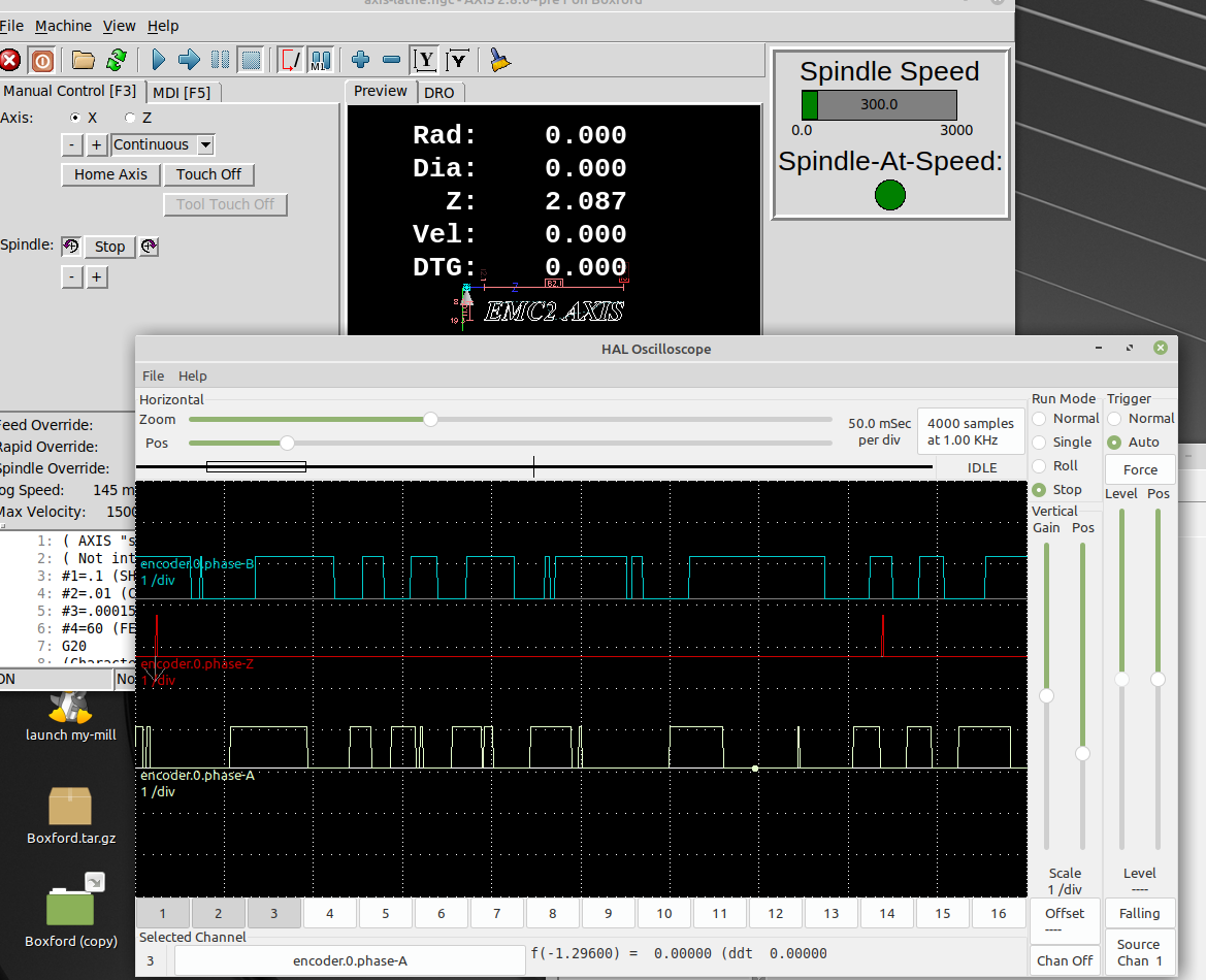

21 Aug 2020 14:53 #178925
by Clive S
Replied by Clive S on topic Using a rotary encoder with a p/port
Update:
I am retrofitting a very small lathe Boxford with a Chinese simple bob. I have tried a 600 pulse/rev ABZ it's to fast for the P/port .
I have not tried a 200 P/rev single ended. It seems to count OK up to about 350 rpm I am not sure if it is missing the Z pulse the scale is set to 800 which seems to be correct tested with a rev counter.
Am I asking to much of the P/port with this ie. should I just put a simple 100 slot wheel with index slot.

21 Aug 2020 16:10 #178934
Replied by tommylight on topic Using a rotary encoder with a p/port
Set the base period in the ini file to 50000, that should get you twice the speed, but do check if you get latency warnings and if not, lower that a bit more.
- Posts: 18111
- Thank you received: 5330
21 Aug 2020 16:23 - 21 Aug 2020 18:39 #178935
Replied by PCW on topic Using a rotary encoder with a p/port
To get a better Halscope view, you should set it to sample the inputs at the base thread rate rather than the servo thread rate
Last edit: 21 Aug 2020 18:39 by PCW.

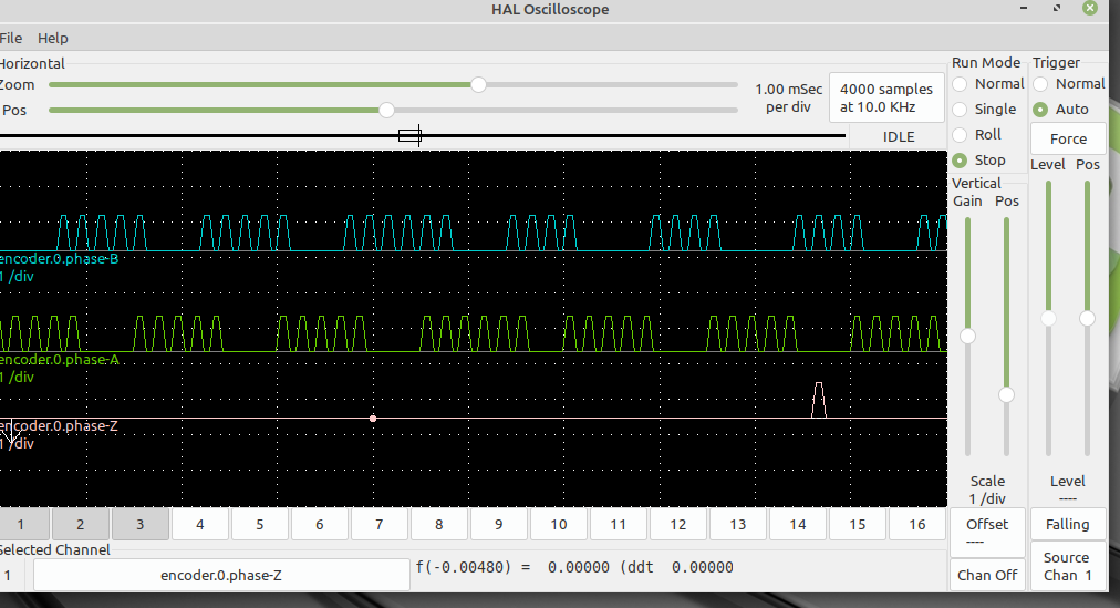

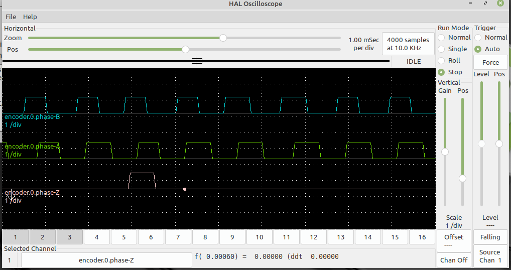

- Posts: 2204
- Thank you received: 486
21 Aug 2020 17:10 #178943
by Clive S
Thanks.
screen shots
1500rpm speed with tachometer
1000rpm
500rpm
250 rpm
Would this encoder be suitable for threading. Would you have an idea of the speed it could count at?
The speed on the axis screen is OK up to about 400 then it loses its way.
To get a better Halscope view, you should set it sample the inputs at the base thread rate rather than the servo thread rate
Thanks.
screen shots
1000rpm
500rpm
250 rpm

21 Aug 2020 18:40 - 21 Aug 2020 19:01 #178949
Yeah, I would say up to 250 RPM or so would be a good speed with some safety margin.
One way of looking at this is by calculating how many times linuxCNC samples each quadrature state
At 800 counts = quadrature states per turn and 500 RPM there are an average of 1.5 samples per state at 10 KHz.
While this exceeds the theoretical absolute minimum of 1 sample per state, it doesn't leave much margin for quadrature
errors or LinuxCNCs base thread timing jitter. Many quadrature encoders specify a 90 degree +-45 degree
quadrature error which would mean you would need to double the minimum number of samples per state
(to 2 minimum) to get a reliable reading
With 800 counts per turn and 2 samples per quadrature state and 10 KHz sampling, this works out to a
maximum RPM of 375 RPM. If you include host sampling time jitter, the 250 RPM figure seems good
