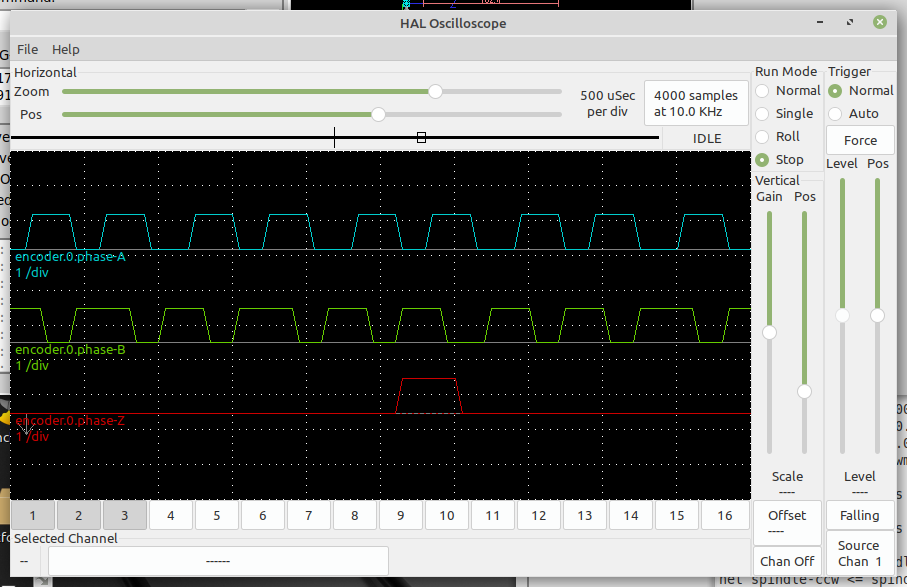

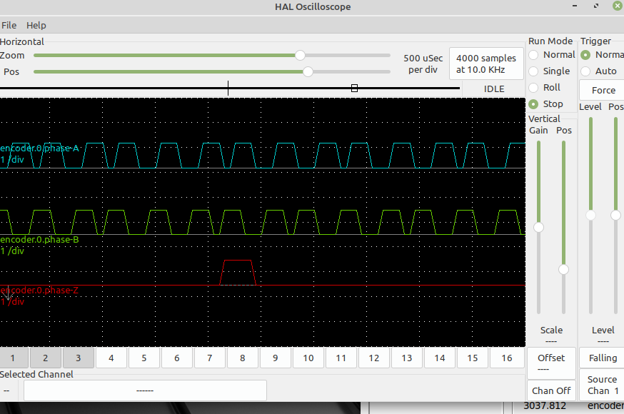

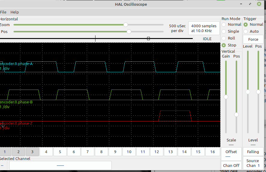

Ok I have changed to simple slotted optos with a 100 slot disc.
Should the encoder.0.position-scale be 100 or 400. 400 seems to give the correct speed commanded but it does jump around.
i.e. does the encoder need to be in a different mode
Disclosure the 100 slot disc is slightly oval but I am getting another as the laser in was done on needs calibrating.
500 rpm
1000 rpm
1500 rpm
500 rpm
1000 rpm
1500 rpm

Replied by tommylight on topic Using a rotary encoder with a p/port
That all seems ok.
Sorry i somehow missed this.
