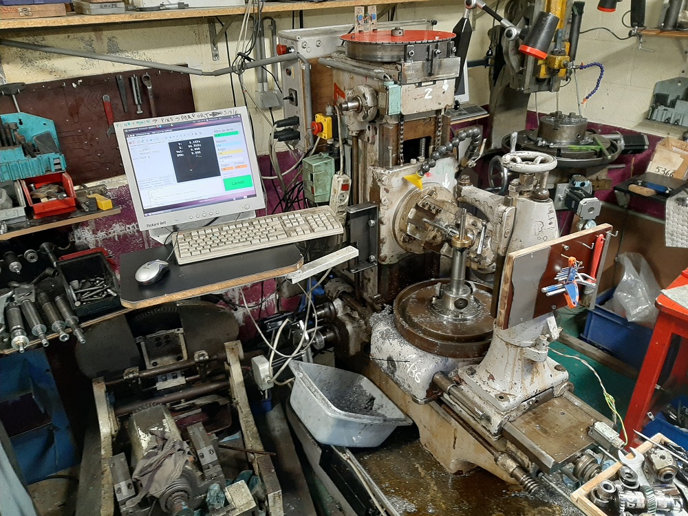

hello everyone, after a few years of using spur gears, i need to make helicals, i transformed my pfauter 10 years ago, i work with parallel port.
i think i need to add coder, but i dont know how, someone to help me.
have a nice day

Maybe tell us what your machine is capable of. You would need to be able to tilt the cutter in reference to the gear I would imagine?

here is the file of my gear cutter, it has been working for 10 years for spur gears without problem, I would like to be able to make the helicals.
I think that it is necessary to add an encoder at the level of the table to be able to make the differential with linucnc.
the gears have 24 teeth at 30 ° and 48 teeth at 60 ° module 2.

Well, now we know what your config looks like, that's good but I still have no idea what your machine looks like physically. Show us some photographs of the machine so we get an idea of its kinematics, axis and geometry.

You are still not providing enough information. If you want people to help it might be worth your while to elaborate a bit more. Maybe there are people here who have a hobber and know what you want but I don't.
I guess the Z axis is the vertical slide with the hob and the X is the horizontal slide with the limit switch that has wires coming out of it?
To me it looks like the hob is already slanted.
Where does LinuxCNC come in here? Do you want to motorize the angle of the hob?
[edit]
Are you aiming to replace the gear mechanism between the hob and the gear as CORBETT has guessed?

Originally the machine has a mechanical differential, which we adjust according to the helix angle, but there is no longer any on my machine, I would like to replace it with linuxcnc.

I have not cut helical gears before, but I thought that there was not really any difference between Spur and Helical hobbing other than tilting the hob more degrees to get the tooth angle. Is this wrong? If wrong, what other process that needs to happen other than Hob rotation tied to the gear blank drive, and hob spindle movement.
When you say "originally the machine has a mechanical differential", are you referring to the change gears between the hob and the gear blank?
My machine is almost identical to yours and mine has the hob head move up and down for the cutting process. Is there any other movement other than these three: 1= Hob rotation, 2= gear blank rotation, 3= hob spindle movement?
I have a really good Barber-Colman book that explains all the different ways to setup a manual machine for hobbing, but I can't get my hands on it at the moment...
