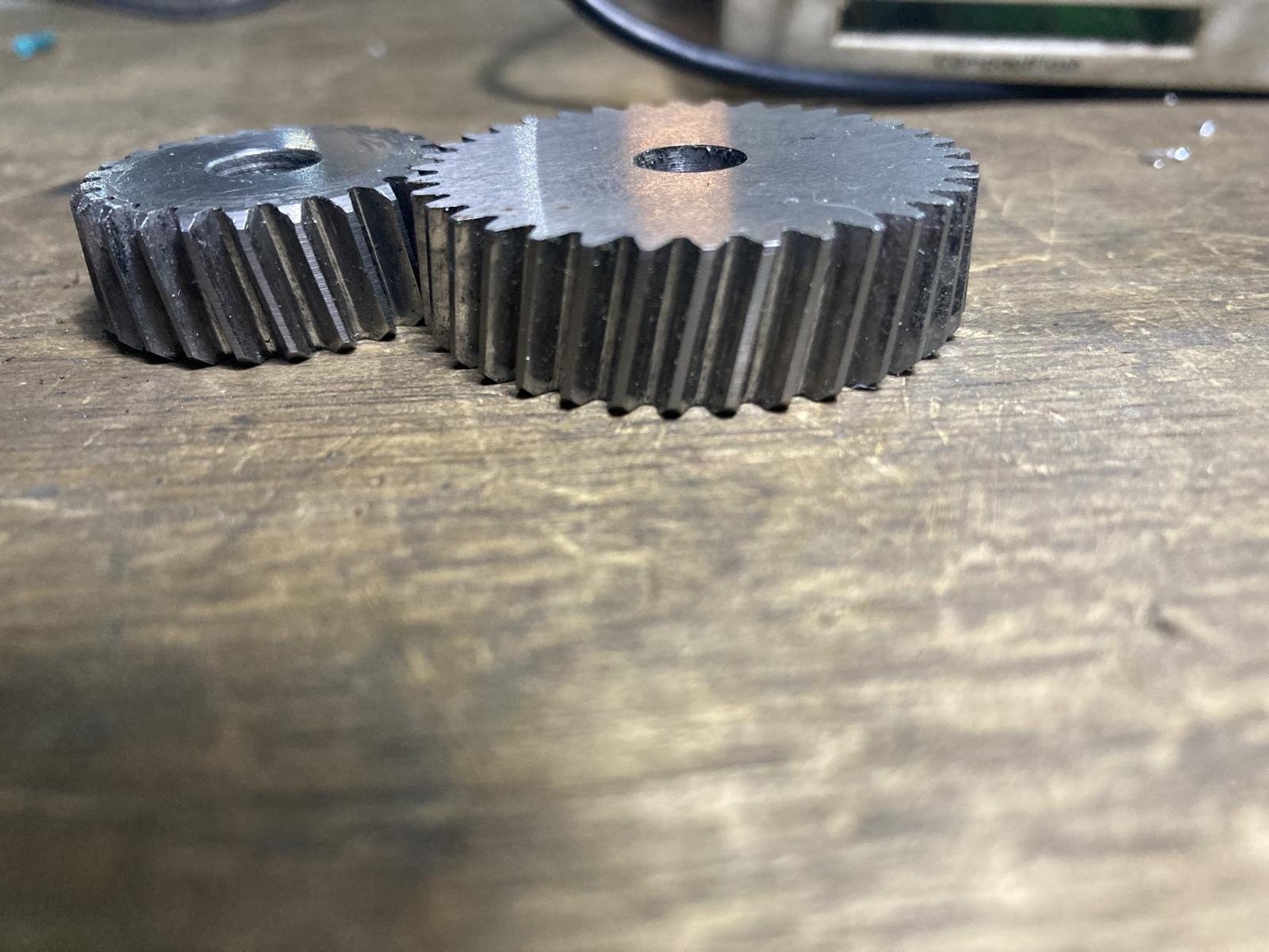

yes it's crossed helical gears 90 degres.
there is a way to catch the head badly with the calculations and the settings of the machine

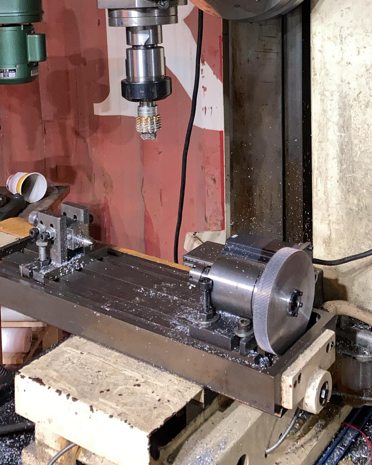

Hello all,
quite some time ago I tried this based on andies Youtube advise and forum information.
For not too steep helix angles with the hob it can be simply done ( on my machine to move the column down while traversing the hob ) As far as I recall it is not dependent on blank diameter, but as the hob is tilted the hob does not move along its axle, but slightly off.
Did not notice that yet.
I have experimented with rotation of the blank for that Andie suggested another scale and hooking it up to the x-position.
I am a little stuck with figuring out what numbers to put into the hal file.
Did someone get it running yet?
Greetings Timo
p.s. the gear were made shifting the hob. Problems why I am not happy with hob shifting.
The width of the gears will be limited to 10 or so mm, rotating the gear blank would allow thicker gears, or cutting more than one at a time.
machine looks like this.

On our Pfauter PE500 (running Linuxcnc) at work, the z axis is parallel to the work piece axis, which is on the C axis. The Y axis is parallel to the hob/spindle, so when you apply a hob shift or hob axial movement, the C axis must rotate by a corresponding amount, determined by the gear reference diameter and the angle of the B axis ( hob tilt axis).
When hobbing a helical gear, the Y axis generally stays in the same position, although it is possible to use axial feed as well to spread the wear across the hob. The Y axis or hob shift is not used to generate the helix angle though.
The Helix angle is generated by additional C axis movement linked to the Z axis (X in your case), this ratio is determined by the Lead of the gear being cut.
The last link that determines the C axis position, is the hob or spindle. this relationship is determined by the number of teeth on the job, and the number of hob starts.
These three relationships are summed, and the result drives the C axis position.
