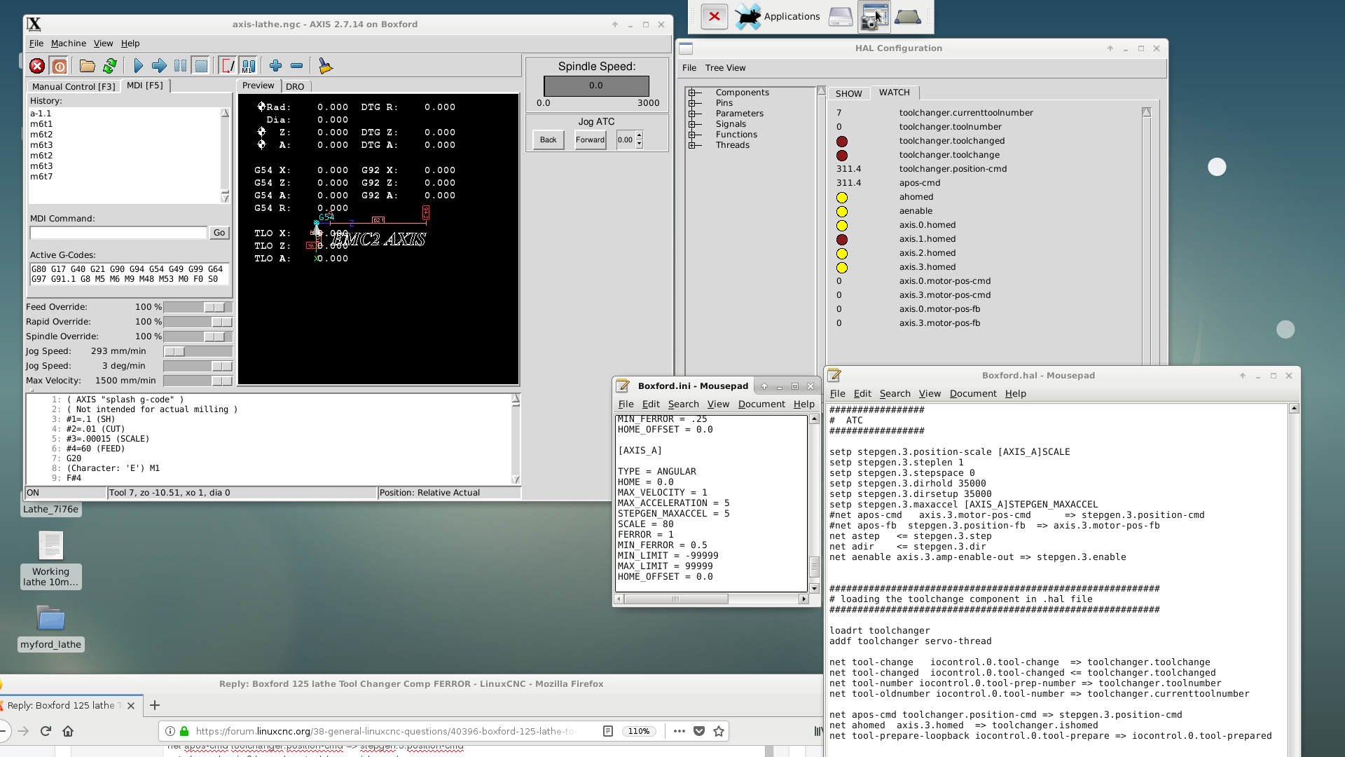

If you have the time could you look over the post from the beginning. I have done some Halscope plots
I have tried all sorts of values this is the previous one forum.linuxcnc.org/38-general-linuxcnc-q...error?start=0#187119
I am trying to set up a toolchanger on a small Boxford.
The following error happens after the A axis moves 1 unit ie. G1 A1 F2 is ok but A1.1 will error
I am not sure if I am using the correct comp or even using the turret as an A axis. I have tried it with changing the TYPE = ANGULAR to LINEAR. if I remember before I found the comp I could jog it around using a Y axis.
In the ini file I am using X,Z,A with 3 stepgens I am using stepgens 0,2,3 . I have 4 loaded in the hal file
Will missing one out create a problem?

I have used halshow and I can see the various pins like toolchanger , toolnumber etc that side of things seems to work.
but I cannot move the turret more that one unit. Disclosure I see the DTG on the dro show 1 unit but not the A axis I do see the counts in halshow apos-cmd toolchanger.position-cmd but not axis.3.motor-pos-cmd. So I know I have some more wiring in hal to do
I am using the word unit as I am not sure if it is degrees or mm

In the comp file I read
### must unlink these 2 to access stepgen.3.position-cmd
### and prevent continual following errors if motor-pos-fb left linked
#net apos-cmd axis.3.motor-pos-cmd => stepgen.3.position-cmd
#net apos-fb stepgen.3.position-fb => axis.3.motor-pos-fb
You have:
setp stepgen.3.maxaccel [AXIS_A]STEPGEN_MAXACCEL
net apos-cmd => stepgen.3.position-cmd
Maybe try to comment out net apos-fb stepgen.3.position-fb => axis.3.motor-pos-fb ?

Yes I tried that last night:-
setp stepgen.3.position-scale [AXIS_A]SCALE
setp stepgen.3.steplen 1
setp stepgen.3.stepspace 0
setp stepgen.3.dirhold 35000
setp stepgen.3.dirsetup 35000
net astep <= stepgen.3.step
net adir <= stepgen.3.dir
net aenable axis.3.amp-enable-out => stepgen.3.enable
loadrt toolchanger
addf toolchanger servo-thread
net tool-change iocontrol.0.tool-change => toolchanger.toolchange
net tool-changed iocontrol.0.tool-changed <= toolchanger.toolchanged
net tool-number iocontrol.0.tool-prep-number => toolchanger.toolnumber
net tool-oldnumber iocontrol.0.tool-number => toolchanger.currenttoolnumber
net apos-cmd toolchanger.position-cmd => stepgen.3.position-cmd
net ahomed axis.3.homed => toolchanger.ishomed
ini file:-
[AXIS_A]
TYPE = ANGULAR
HOME = 0.0
MAX_VELOCITY = 1
MAX_ACCELERATION = 5
STEPGEN_MAXACCEL = 5
SCALE = 80
FERROR = 1
MIN_FERROR = 0.5
MIN_LIMIT = -99999
MAX_LIMIT = 99999
HOME_OFFSET = 0.0
That got rid of the error.
Can you help me rewire the hal in that it is not driving the net apos-cmd toolchanger.position-cmd => stepgen.3.position-cmd
As you can see the DRO is not updating - ie not passing the steps to the motor
Thank you for your help.

I think the DRO gets its data through axis.3.motor-pos-fb. Not sure what to do there as the author of the comp wants you to disconnect that. Maybe he didn't use the DRO for the toolchanger?
As for the motor:
Is the stepper on the toolchanger not moving at all when you command a toolchange?
Since you have:
The stepgen should get the position from the comp when you do a Tx M6. If it isn't moving is signal aenable TRUE?

We are getting there. I was testing on the bench ie no machine connected. I have now got the machine connected and yes the turret moves. :)
Now we have two more problems.
No 1. Jog ATC in side pane does not work I will come back to that after the turret is correct
No. 2 The turret try to move in reverse for some moves ie:
going from 1 -2 ok
going from 2-3 0k
going from 3-2 ok
going from 2-3 ok
going from 3-1 not ok goes in reverse So this stalls the motor
going from 1 -5 ok
going from 5-4 ok
going from 4-3 not ok goes in reverse So this stalls the motor
I think it is trying to go the shortest path.
This ATC turret can only go one way and then a short move to lock. When it moves it goes to the tool position and then retracts OK
