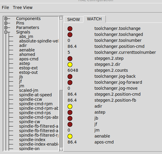

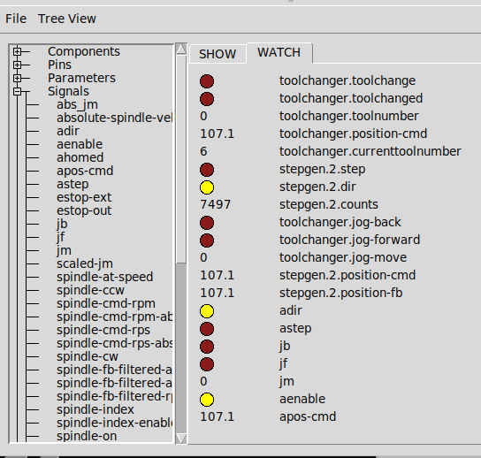

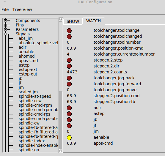

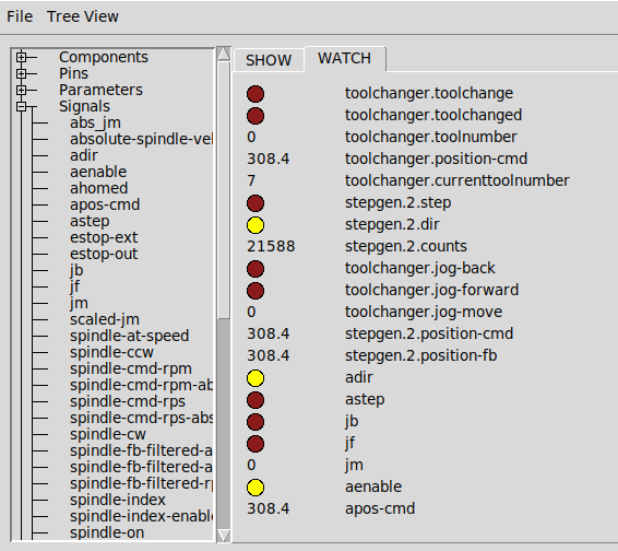

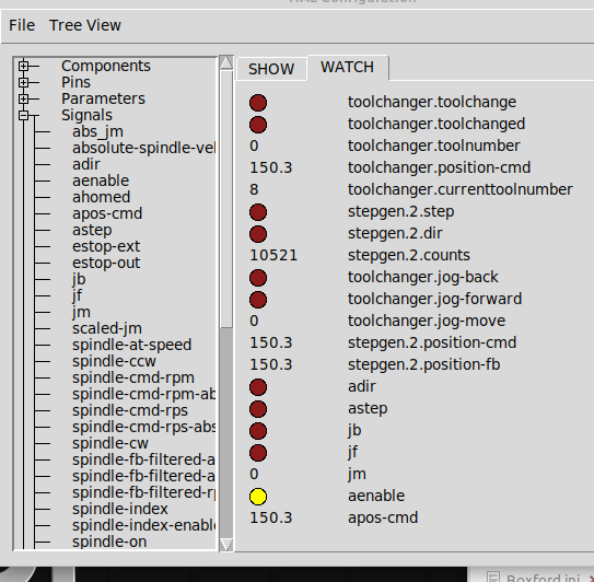

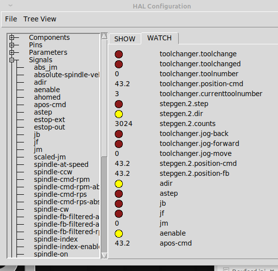

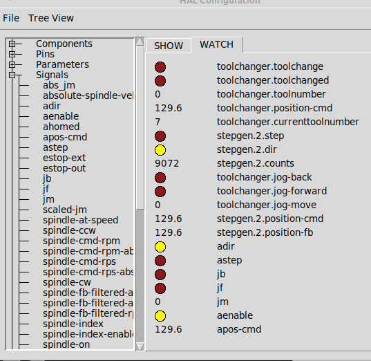

OK I have tried to get the scale correct so that G1A360 F100 does one rev.
So have put the hal back so that the comp is working. I am also running 2.8 mint and sorted out the ini files to accommodate this.
As its been said it tries to go backwards at various tool numbers.
I have done some screen shots from tool 1 to 8 then back to tool 7

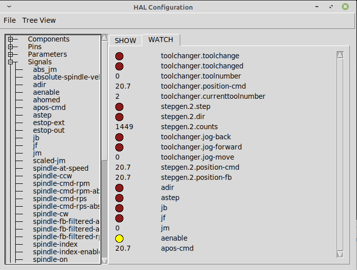

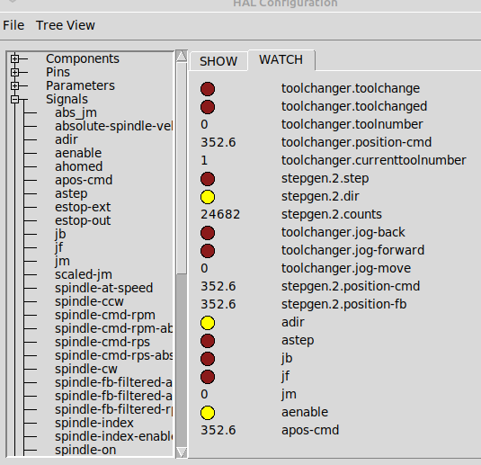

31 Oct 2020 07:51 - 31 Oct 2020 07:54 #187900
by Clive S
Replied by Clive S on topic Boxford 125 lathe Tool Changer Comp FERROR
To continue
Back to tool 7
Then back to tool 1
Back to tool 7
Then back to tool 1

31 Oct 2020 09:21 - 31 Oct 2020 09:25 #187912
Replied by Aciera on topic Boxford 125 lathe Tool Changer Comp FERROR
One thing I notice is that all moves seem 1.5° short of the actual angles set in the comp. So does this reflect the backward locking?
[edit]
Ok, just noticed that 1.5° is actually not true for all moves. Which I find a bit strange.
[edit]
Last edit: 31 Oct 2020 09:25 by Aciera.
- Clive S
- Posts: 2204
- Thank you received: 486
31 Oct 2020 09:28 #187914
by Clive S
Yes I believe so when watching in the halshow moving from T1 to T2 it shows 22.2 then moves back to 20.02 (to lock the changer)
It does that on each move. Apart from when it goes bonkers in reverse.
That's why a temporally have disabled the locking mechanism
- Posts: 4819
- Thank you received: 2177
31 Oct 2020 09:55 #187918
So does the unwanted backwards motion always happen on the same moves?
Which is the correct, (foreward) direction "adir"=TRUE?
