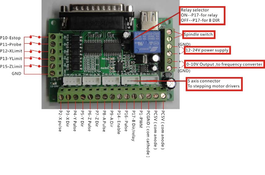

I'm aware that's the case, but I do not know where to then wire the PWM from the breakout board into - there's documentation for everything except that
- bevins
- Posts: 1947
- Thank you received: 339
26 Oct 2020 18:12 #187351
by bevins
Pin1 looks like the pwm so :Linuxcnc will output to the BOB. You connect 12- 24 volts to the dcin on the BOB then you have your 0-10 volt oput[put to spindle. You will probably need fwd contact into the vfd. If you only need fwd you are good to go. If you need rev then yopu need another output to fire a relay when asking to go reverse then feed that contact into the vfd.
Thats what I would try.
Replied by bevins on topic Making 0-10V output work with spindle in HAL

Pretty sure the PWM pin is brought out so that it can be used as a standard 5V output if the spindle analog out is not used
Replied by PCW on topic Making 0-10V output work with spindle in HAL

As PCW suggested. You would leave the green PWM terminal unconnected as this is the 5V Signal coming from the Parallel port.

With that breakout board (below) uses the 12-24v combined with the PWM signal on pin 1 (the computer side) to output the 0-10v signal. Don't connect anything to the pin1 output on the breakout board. He was trying to say that in your hal file the PWM output gets connected to the parallel ports pin 1 there. Then the breakout board uses that signal to generate the 0-10v signal. (The pin 1 output on the breakout board is for situations where you are not using the 0-10v signal and want to bring out the output from parallel port pin 1 for other uses.)

Hello guys,
I face the same problem with the same 5 axis breakout board. I am also a Linuxcnc beginner...
I am able to start and stop the spindle via Linuxcnc, using the relay on the BOB, which is connected to the FWD of the VDF.
A 12V power supply is connected to the BOB, so the board is able to generate the 0-10V for the spindle speed.
in my HAL file, I use the pin1 for the pwm but I am only able to change speed directly on the VDF, not via linuxcnc.
If I measure the 0-10V output, it is stuck at 9.5V. The speed displayed in Linux cnc doesn't change when I click on "+"
If you can check my HAL, there is maybe something wrong...
If someone could help me, it would be great. Thanks a lot
