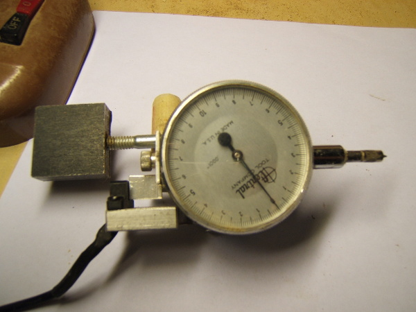

Thank you again. The probe, did you assemble one or buy a ready one? Do you power what on your machine? Acrylic, wood, printed circuit board?

Self made. The plunger on the dial indicator breaks the beam of the photo interrupter. This is fancier than needed. The only necessary parts are a spring loaded plunger and some way to make/break a circuit. A momentary switch will work if you can find a suitable unit.
If the material you're cutting conducts electricity a switch is not necessary. I cut metals, woods, plastics and some other materials.
Replied by jbraun on topic Problem when trying to run Autoleveller on Mint 19.3 + Linuxcnc.

Wow, so a comparator watch ... the accuracy of your probe is very high ...
I'm researching youtube for more probe models, I'll make one and try to use the Gcode reaper.
