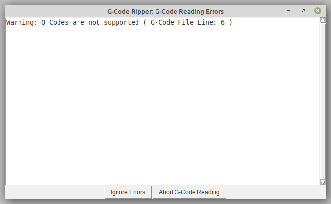

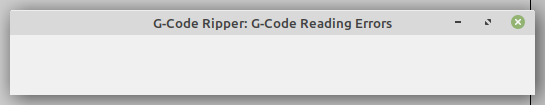

Hello, I did some tests just now and had some problems.
The probe and port are configured correctly in Linuxcnc and it sees status change 0 and 1.
When I ran gcode-ripper **. Py via terminal, these messages returned:
When I select an option, it returns an error message, when I open a gcode file it also returns an error.
What am I doing wrong? From what the command returned, I have Python 2.7. * Installed ...
I attached the gcode files I used for testing, I generated them to machine a pcb from a layout made in Eagle and exported by the ULP "pcb-gcode.ulp".
Exception in Tkinter callback
File "/usr/lib/python2.7/lib-tk/Tkinter.py", line 1550, in __call__
return self.func(*args)
File "g-code_ripper.py", line 2068, in Entry_recalc_var_Callback
self.menu_Mode_Change()
File "g-code_ripper.py", line 2294, in menu_Mode_Change
self.Open_G_Code_File(self.NGC_INPUT,Refresh=True) #V0.8 needed so auto arc2line is active during reading
File "g-code_ripper.py", line 2114, in Open_G_Code_File
if error_message(MSG) == "ignore":
File "g-code_ripper.py", line 180, in error_message
error_report.grab_set()
File "/usr/lib/python2.7/lib-tk/Tkinter.py", line 690, in grab_set
self.tk.call('grab', 'set', self._w)
TclError: grab failed: window not viewable
File "g-code_ripper.py", line 2077, in Entry_units_var_Callback
TclError: grab failed: window not viewableWhen I select an option, it returns an error message, when I open a gcode file it also returns an error.

26 Nov 2020 18:37 #190346
by jbraun
Replied by jbraun on topic Problem when trying to run Autoleveller on Mint 19.3 + Linuxcnc.
Remove Q.001 from the ngc file. I think if you remove the G64 line entirely it won't matter as g-code_ripper will add it's own G64 according to it's general settings.
from the user guide description of Naive Cam Detector:
Successive G1 moves that involve only the XYZ axes that deviate less than Q- from a straight line are merged into a single straight line.
www.linuxcnc.org/docs/html/user/user-con...c:trajectory-control
Yeah, clear as mud to me as well

28 Nov 2020 06:25 #190486
by jbraun
Good to see you have this solved.
Please ignore the suggestion in my previous post of removing the G64 line entirely. G-code_ripper doesn't post G64 by default.
I'm not sure how to change where the probe data file is created. This is the probe.ngc in case someone else knows a way.

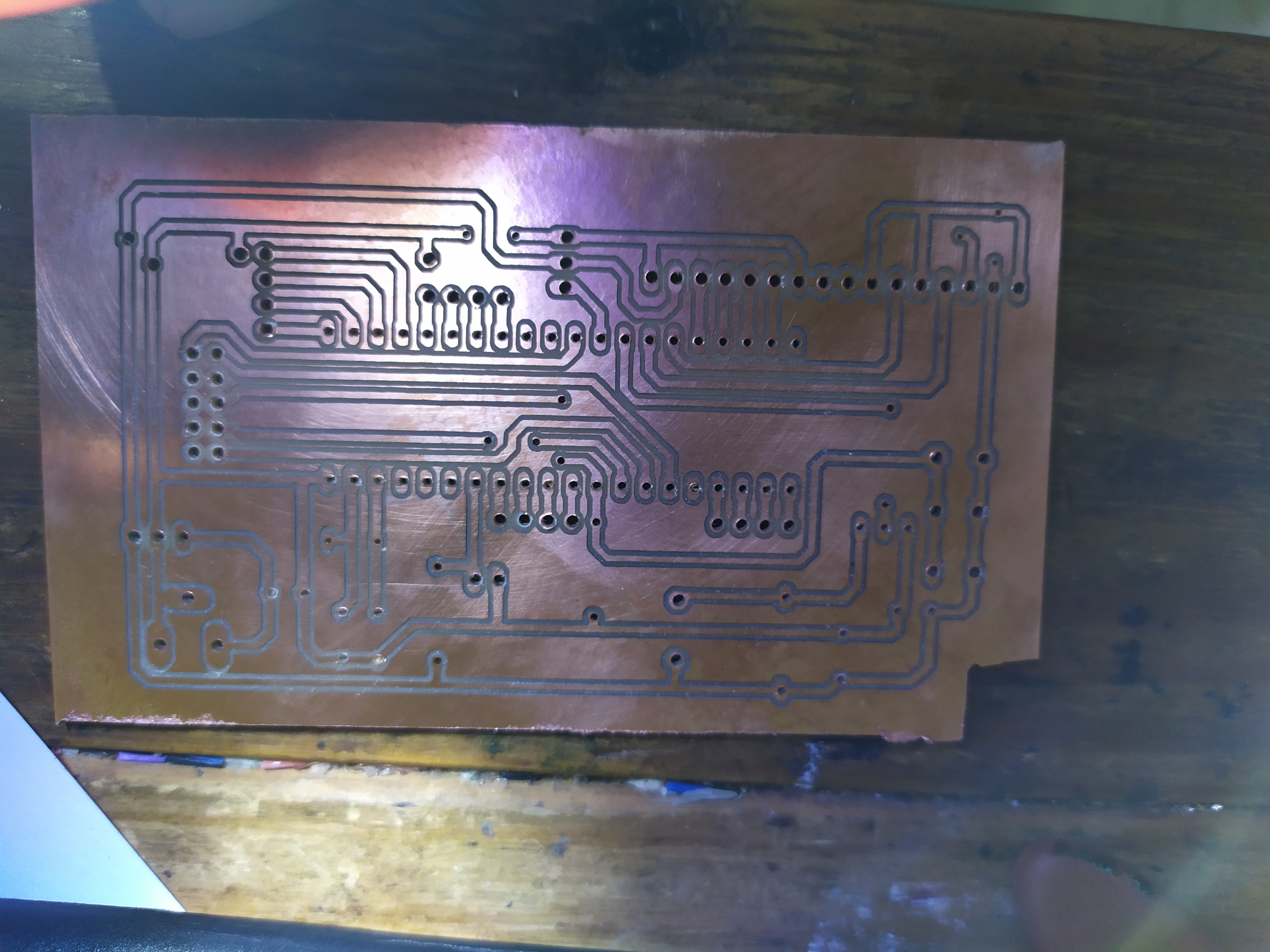

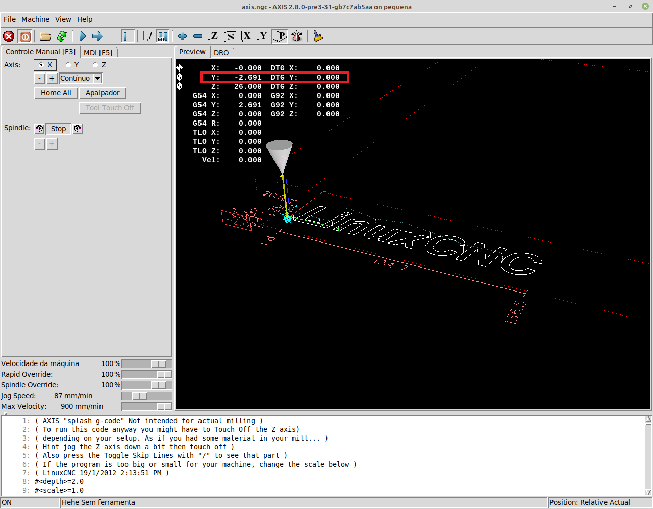

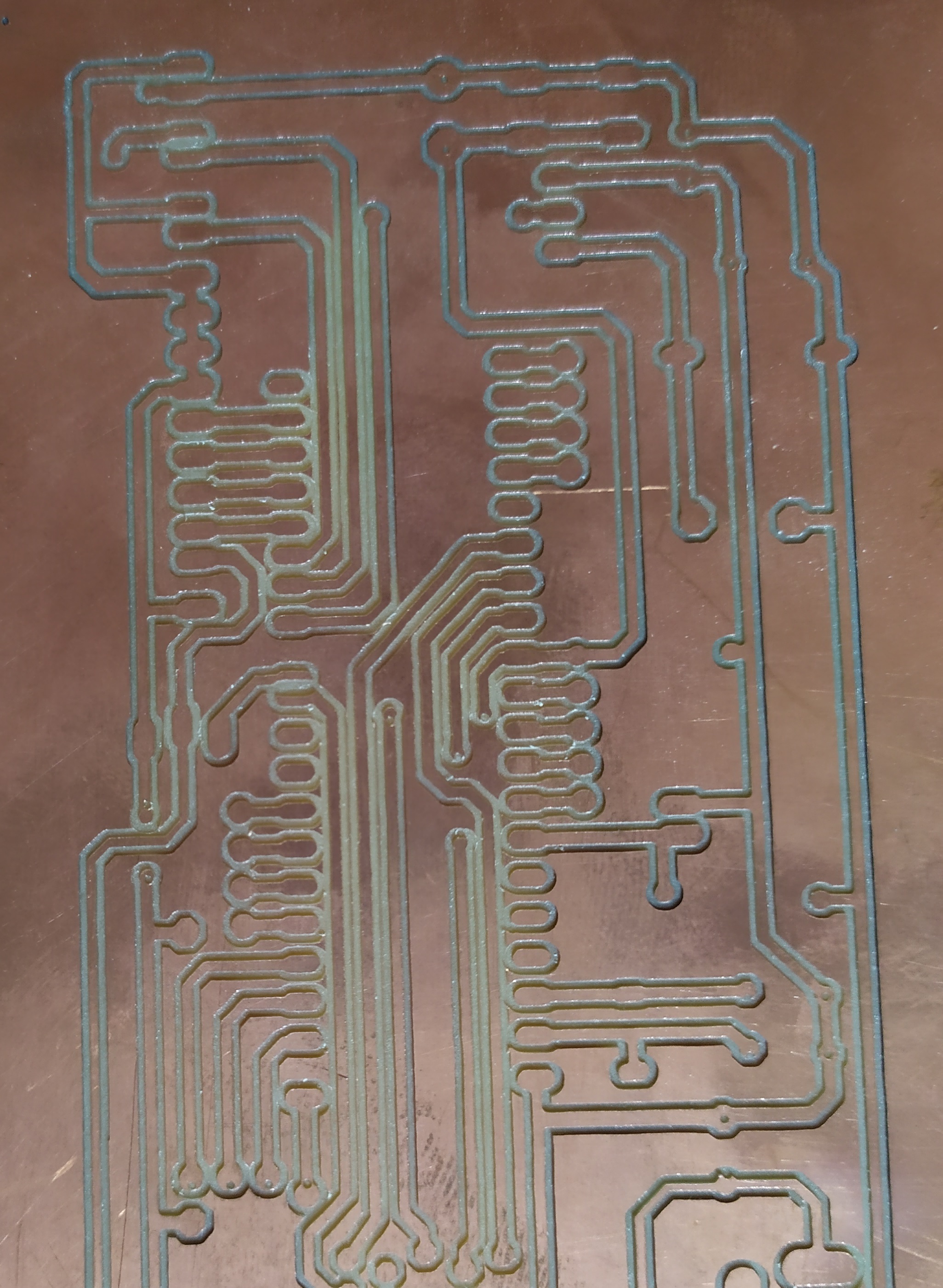

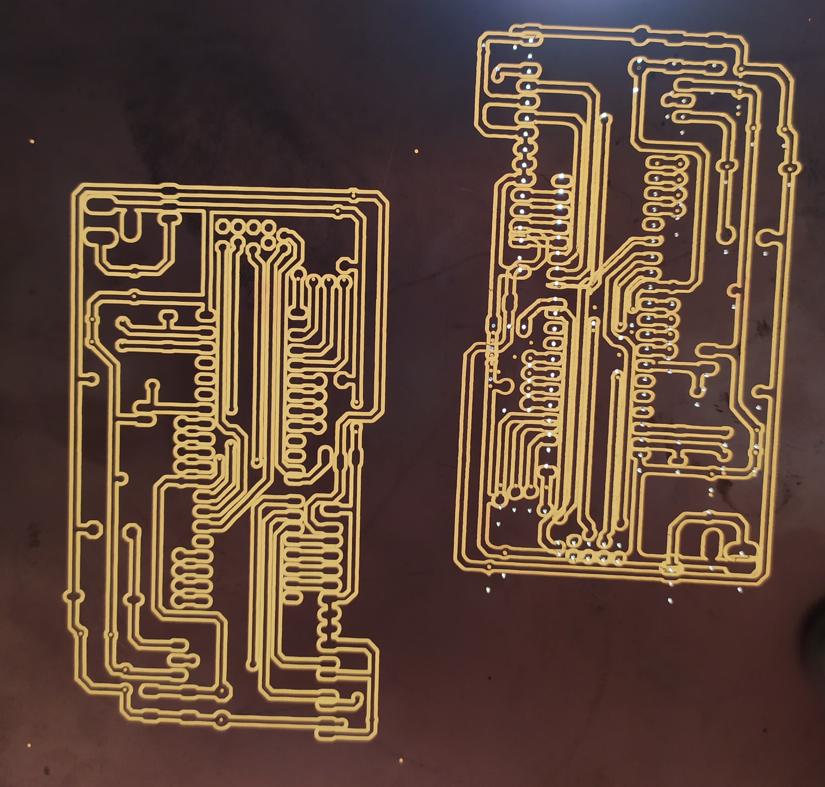

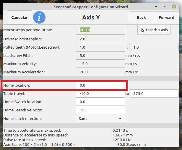

08 Dec 2020 15:38 #191427
by aparecido
Replied by aparecido on topic Problem when trying to run Autoleveller on Mint 19.3 + Linuxcnc.
I was able to use the gcode ripper to correct the imperfections of the board's surface, but now there are other problems, but I believe that with Linuxcnc 2.8, so as not to be creating several topics here on the forum, I'll post it right here.
1-I give the command for the machine to go home on the 3 axes, on the X axis it goes to "0.0" which is the configured position of the sensor, on the Z axis it goes to the position of the sensor which is "26.0". However, on the Y axis, the sensor position setting is 0, but it finds the sensor and marks it as "-2.691".
2-When machining the pcb, it seems that the machine is losing pace and makes some overlapping tracks and some holes in the wrong position, however I lowered the speed of the machine well, checked the board (CNC3AX) and sensors, the power supply is not overloaded , the mechanics of the machine are also ok.
I give the command to do homming on the 3 axes and have it run again from a certain point in the gcode, where there is already a problem in the machining position and the machine runs 'with error'.
So I'm guessing it might be a problem in Linuxcnc 2.8.0 interpreting the code, or maybe it is the computer that has a problem with latency? Although I did the tests that I even posted here on the forum.
I attached photos of the board and the gcode.

08 Dec 2020 16:10 #191429
Replied by tommylight on topic Problem when trying to run Autoleveller on Mint 19.3 + Linuxcnc.
1 it looks like you have active offsets as can be seen from the green round/spiky thingy where the tool overlay is in the GUI.
2 one axis is loosing steps, badly and progressively, so check for mechanical issues like binding first by removing the motor and spinning/moving the said axis, then check the drive for what current it is set to, make sure the motor connected to it can handle the set current.

08 Dec 2020 16:24 - 08 Dec 2020 22:13 #191431
by aparecido
1-How do I disable offsets? I was testing and didn't activate anything, I don't know how it was activated.
2-Okay, I'll check the mechanics and electronics.
News:
I did some tests here, generated a gcode for the machine to move 30 times from the point "x 0 y 0" to "x 200 y 200" and return "x 0 y 0", at the end, it gave a difference of 0.03mm in x axis and 0.1mm on the y axis.
The axles are not weighted, removing the motor, the spindle of these two axes rotates freely in the hand. The motor current is adjusted correctly, I am using the CNC3AX driver board.
News:
Last edit: 08 Dec 2020 22:13 by aparecido.

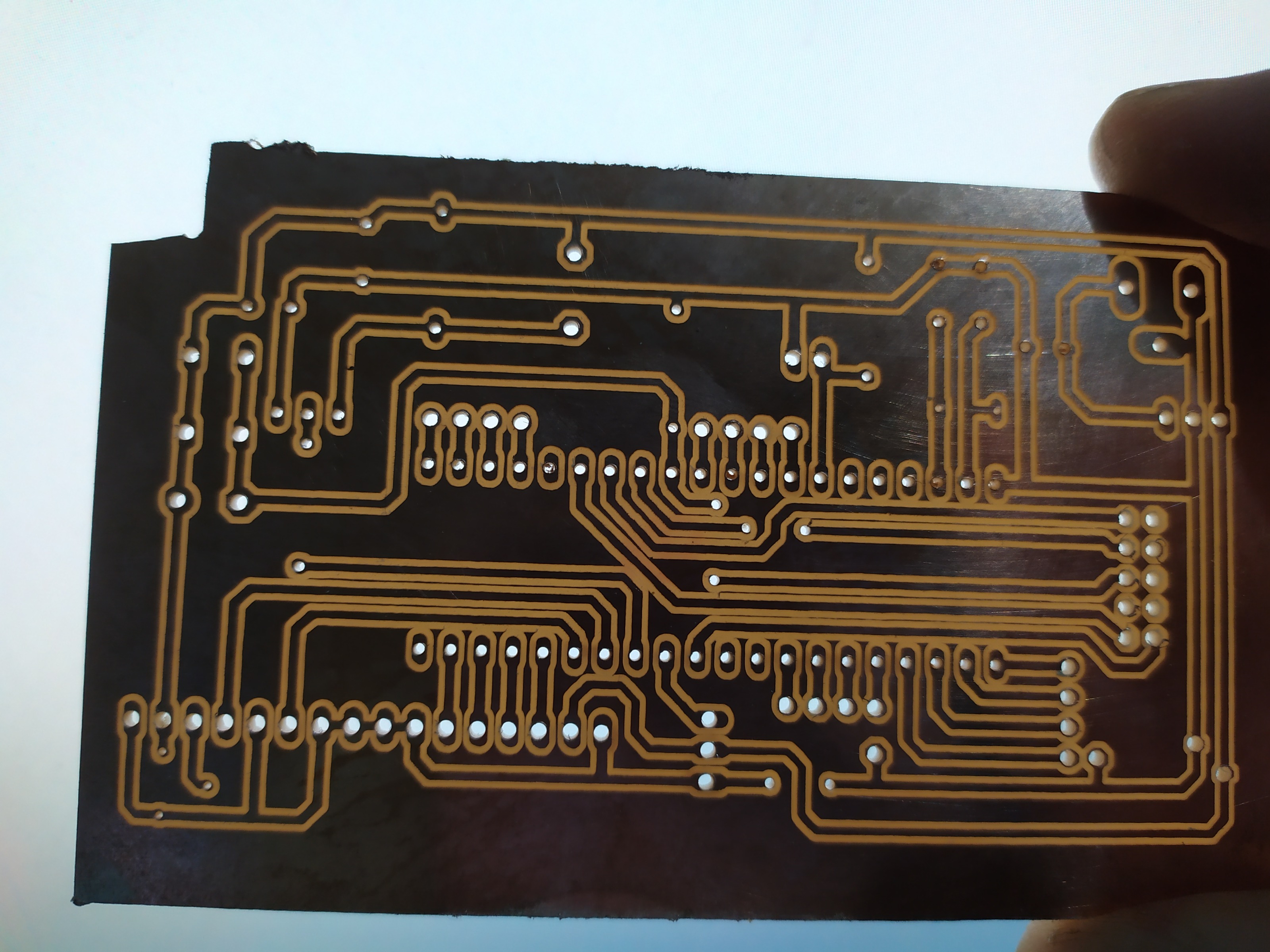

- aparecido
- Posts: 100
- Thank you received: 6

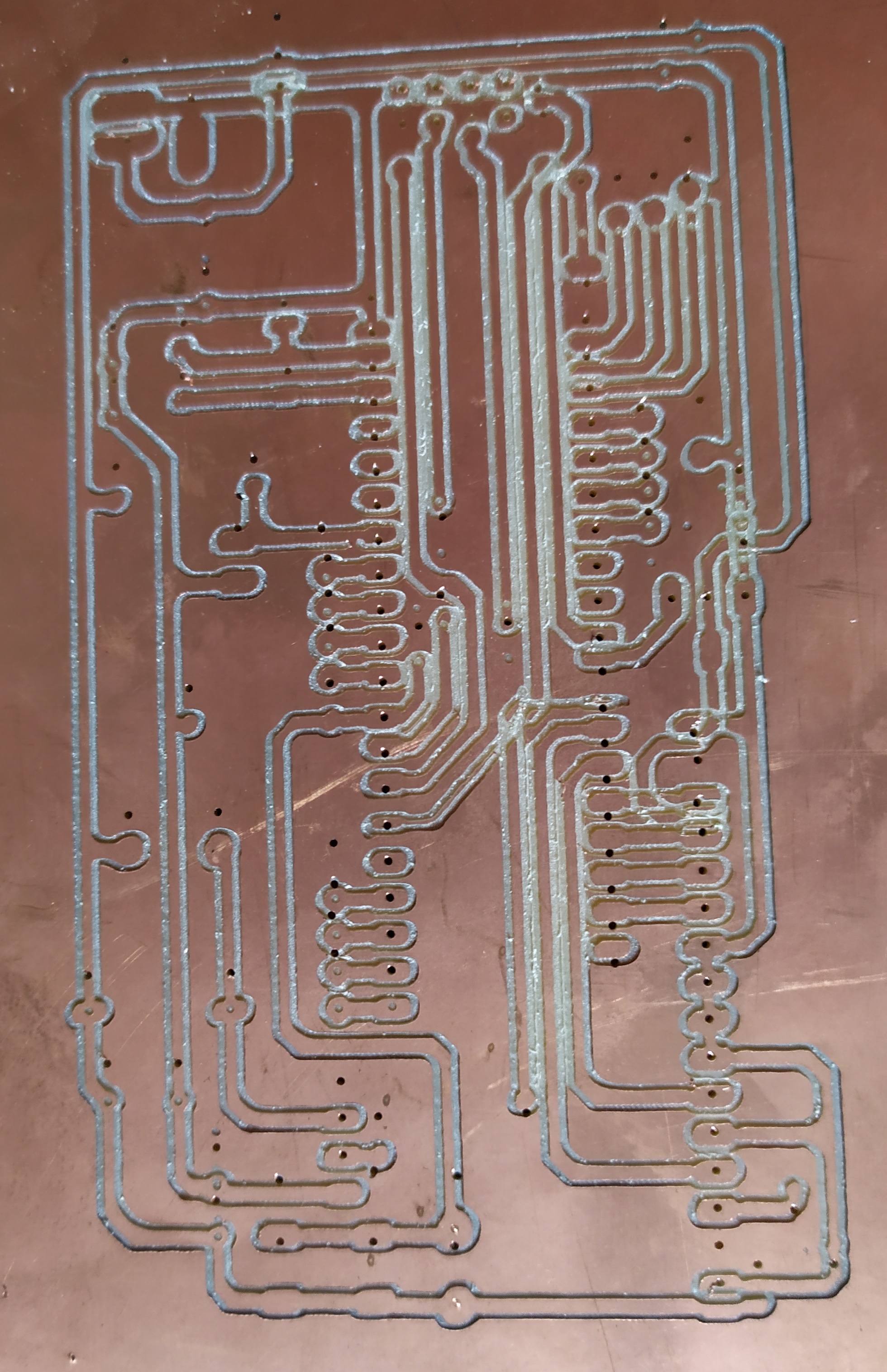

21 Dec 2020 22:03 - 21 Dec 2020 22:05 #192733
by aparecido
I was able to machine the plate a little while ago, practically all the holes were centralized, I think some 3 were left out but it is almost imperceptible, I believe it is something with the plate creation software (Eagle).
Well, detailing what I did, it might help others with the same problem:
-I reinforced the structure of the machine, welded some angles locking the 4 legs even more, to prevent the structure from having any balance when the machine moves.
-I changed the type of foot that was in the structure, to a rubber that fixes better on the floor.
-I adjusted the current adjustment trimpots of each axis of the CNC3AX board again.
-The handle that I use to probe the surface and adjust the imperfections by Gcode Ripper, I disconnected it from the part that was being machined, I got the impression that the spindle when it made the cutter touch the surface of the PCI, induced something by the probe that could interfere with the CNC3AX cycles responsible for controlling the motors.
Follow the photos of the last machined plate, thanks for your help.
Last edit: 21 Dec 2020 22:05 by aparecido.

21 Dec 2020 22:35 #192739
Lookin nice !
