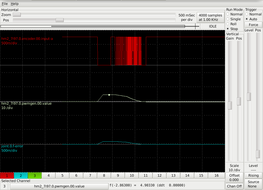

Hello Everybody,
We are trying to retrofit an old servo drive system for a VMC and we want to use the MESA 7i97 along with LinuxCNC to make it all work.
We got LinuxCNC to startup correctly by modifying the HAL/INI files provided by PCW in this link . As soon as we go into AXIS home screen we tried to turn the machine power on by clicking on the icon(or pressing F2), but immediately we face a joint 0 following error and the machine is stopped again by LCNC.
Here are the things we tried to correct the issue:

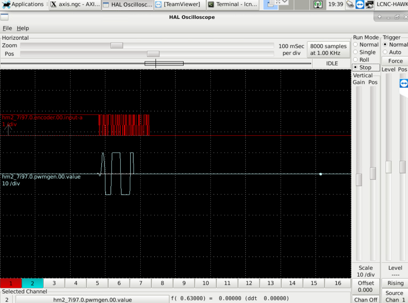

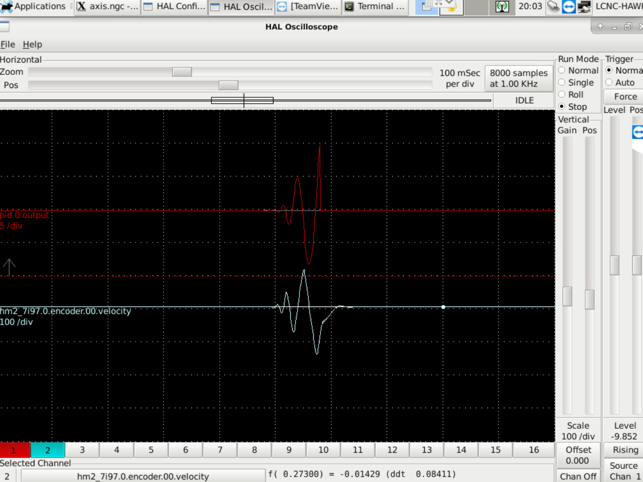

Our problem is as soon as the machine is powered on using F2 the machine automatically Starts to move for a small moment before we get the error. At this point we haven't even given any jog command or home command, the JOINT 0 starts to move as soon as Click on machine Power ON.
We tried to SCOPE some things (PFA below), we found that as soon as we give the power on command there is some signal on the analog-out pins and the PID loop starts to compensate for the movement as the current position command is essentially 0. We suspect that due to the current position command being 0 and there is movement and thus feedback on encoder pins we get a joint following error because no actual command was given to the motor.
We have scoped the encode channel A and pwmgen.0.value in one image and pid.0.pos and encoder0.velocity in another image. The signals you see are there as soon as we click on Machine power on, no other inputs were given.
- As suggested by some of the posts here we tried to increase the FERROR and MIN_ERROR parameters in INI file and increased them. but the error still exists.
- Verified the encoder scale and the encoder feedback on the encoder 0 pins using HAL SCOPE
- Tried to tune the PID by decreasing the values
- Checked the servo thread jitter and verified that the Latency.

23 Nov 2020 20:52 - 23 Nov 2020 21:04 #190143
Replied by PCW on topic Joint following error right after clicking on Machine Power ON (7i97 LCNC 2.9)
I would say that the P term is way too high, causing oscillations
In addition, The FF1 value is incorrect, FF1 can only be 1.0
if the output scale = the velocity at 10V.
In addition the maximum velocities in the INI file seem very low
(8.333 mm/second in X and 1 mm/second in Y)
BTW The I term should always be 0 for initial tuning
Last edit: 23 Nov 2020 21:04 by PCW.
The following user(s) said Thank You: shadab

28 Nov 2020 10:15 - 28 Nov 2020 10:32 #190499
by shadab
Replied by shadab on topic Joint following error right after clicking on Machine Power ON (7i97 LCNC 2.9)
We corrected the scale value, due to the tuning we were doing I had changed the scale value. Now both MAX_OUTPUT and OUTPUT_SCALE are 10 and -10 respectively.
I had checked another post where you had suggested a few things to verify while debugging this error:
forum.linuxcnc.org/38-general-linuxcnc-q...nt-0-following-error
I can confirm that my encoder scale is correct and the output scale is correct as well. We manually measured the axis movement after jogging the axis discretely for 10mm using 0.1mm jogs. Encoder direction and scale are correct.
One observation I have is that when we remove the encoder and then try jogging we get good acceleration and movement. 10v should corresponds to 75mm/sec speed in our drive. Without encoder if i use continuous jog the output voltage on mesa card and the speed of drive match.
When we connect back the encoder, the observed velocity reduced drastically, and hence we are getting the following error. The scale is -10 and pwmgen.0.value also goes till 10, in this case there should be a lot of acceleration in the drive, but the drive barely moves.
here is a screenshot of HAL_SCOPE with encoder attached.
