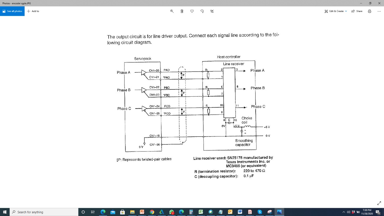

28 Nov 2020 15:56 - 28 Nov 2020 16:00 #190523
by shadab
Replied by shadab on topic Joint following error right after clicking on Machine Power ON (7i97 LCNC 2.9)
Hi Peter,
I have checked the scale by rotating the ball screw by hand. I am getting the 5mm/rev as expected.
For voltage output I have following observation on the machine.
When I Plug in encoder connector and jog the axis in + direction pwmgen value is going up to 10 V (get -10 when jog in – direction). LCNC goes to following error soon .Servo goes only to around 50 RPM. I scoped the mesa analoge o/p I am not getting the expected voltage (corresponding to pwmgen value) . in scope I find only around 20 mV.
If I remove the encoder pwmgen value and mesa o/p matches exactly and servo goes to full speed.in both directions.
Encoder signal is coming from drive (not directly from encoder) refer below circuit.
This circuit is done as per recommendation on drive manual. +5v from 7i97 is not connected to drive . only GND is connected for reference.
We tried both differential and single ended signals .results are the same.

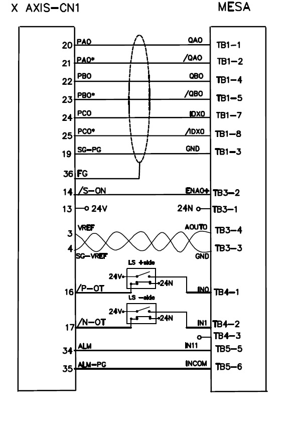

28 Nov 2020 16:06 - 28 Nov 2020 16:28 #190524
by shadab
Hi again Peter!,
One very strange issue we found.
When we are plugging in the x axis encoder from the drive to the joint 0 input we get the above mentioned problems.
As a last resort we swapped the x axis encoder and y axis encoder on the mesa side. So now if we rotate the Y axis ball screw by hand X axis see the change in DRO. When we rotated the Y axis by hand, X axis immediately started to correct the change by rotating in the opposite direction. The speed at which X tries to correct is also very high.
When we swap the encoder connections back to the correct configuration (x axis to x axis drive encoder and same for y) we get the same error where pwmgen0.value is saturated to 10 but the analog output on mesa pin is a few milivolts.

28 Nov 2020 16:45 #190528
Replied by PCW on topic Joint following error right after clicking on Machine Power ON (7i97 LCNC 2.9)
Sounds like you have a wiring error so you have the analog output connected to the drives ground. As soon as you make the encoder ground connection to the drive, you short out the analog output.

30 Nov 2020 16:43 #190687
by NEMARIAZ
Replied by NEMARIAZ on topic Joint following error right after clicking on Machine Power ON (7i97 LCNC 2.9)
guess you were right . I removed the encoder GND , and voltage started rising and X-axis started responding as expected. Now X-axis is hunting a little bit upon power on . holds position at a voltage of ~0.23V. I think it can be corrected in servo.
On Y axis as soon as I switch on axis moves in + direction violently and trips with following error. I tried changing sign of encoder scale and input scale ,but results were same. (Tried all 4 combinations of signs). I swapped the analogue lines same result , but movement in opposite direction.(-).
Similar behavior in Z-axis also.
Any Idea Why this is happening?
- Posts: 18084
- Thank you received: 5317
30 Nov 2020 17:03 #190688
I think you have the drives miswired somehow.
If removing the encoder ground allows better operation
you must have the analog output connected to drive ground
This must be fixed before proceeding
