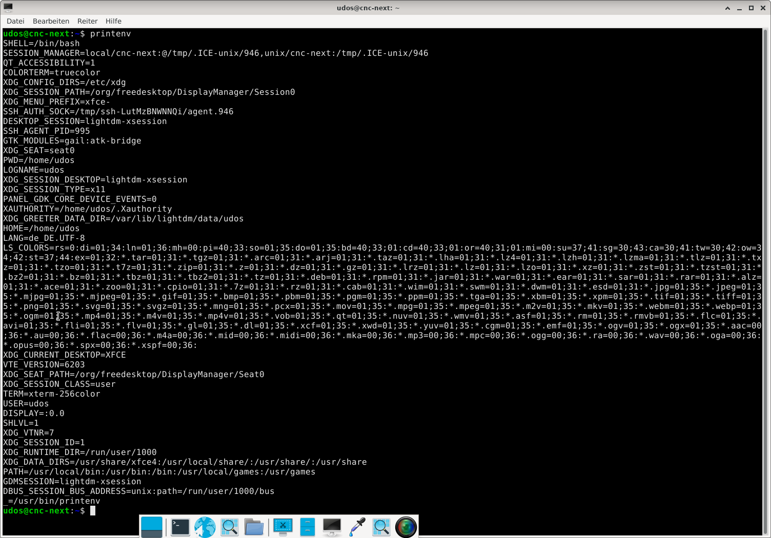

there is no "INI_FILE_NAME" or "CONFIG_DIR" in the env; Sorry.

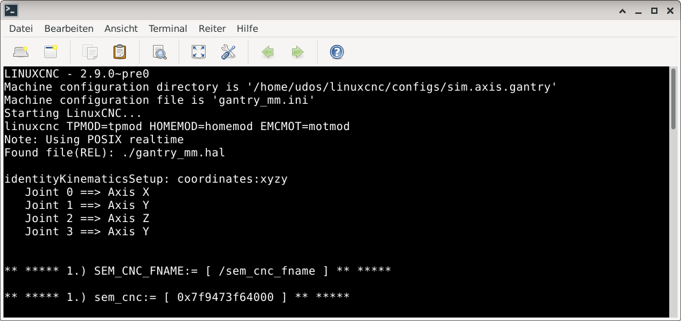

thanks for your effort; but the thing is that there are no "NON" of the env vars visible in respect to linuxcnc;

what I understand:
setting var in one shell e.g. "xfce4-terminal" or "lxterminal"
udos@cnc-next:~$ MY_VAR=my_var
udos@cnc-next:~$ export MY_VAR
udos@cnc-next:~$ echo $MY_VAR
BUT: that MY_VAR is only available in the same shell/process or child-shell/process;
If I run a new app/process, then those vars are not set/there; not available;
So to have them available, the new app/process would need to be a child of linuxcnc-env;
Best Regards

the $HOME/linuxcnc/config/anyConfig/anyName.ini
can always be different;
I start my app and have to check if or if not LinuxCNC is running;
If not then start it;
then I read from the .ini some values;
a.s.o. ......
