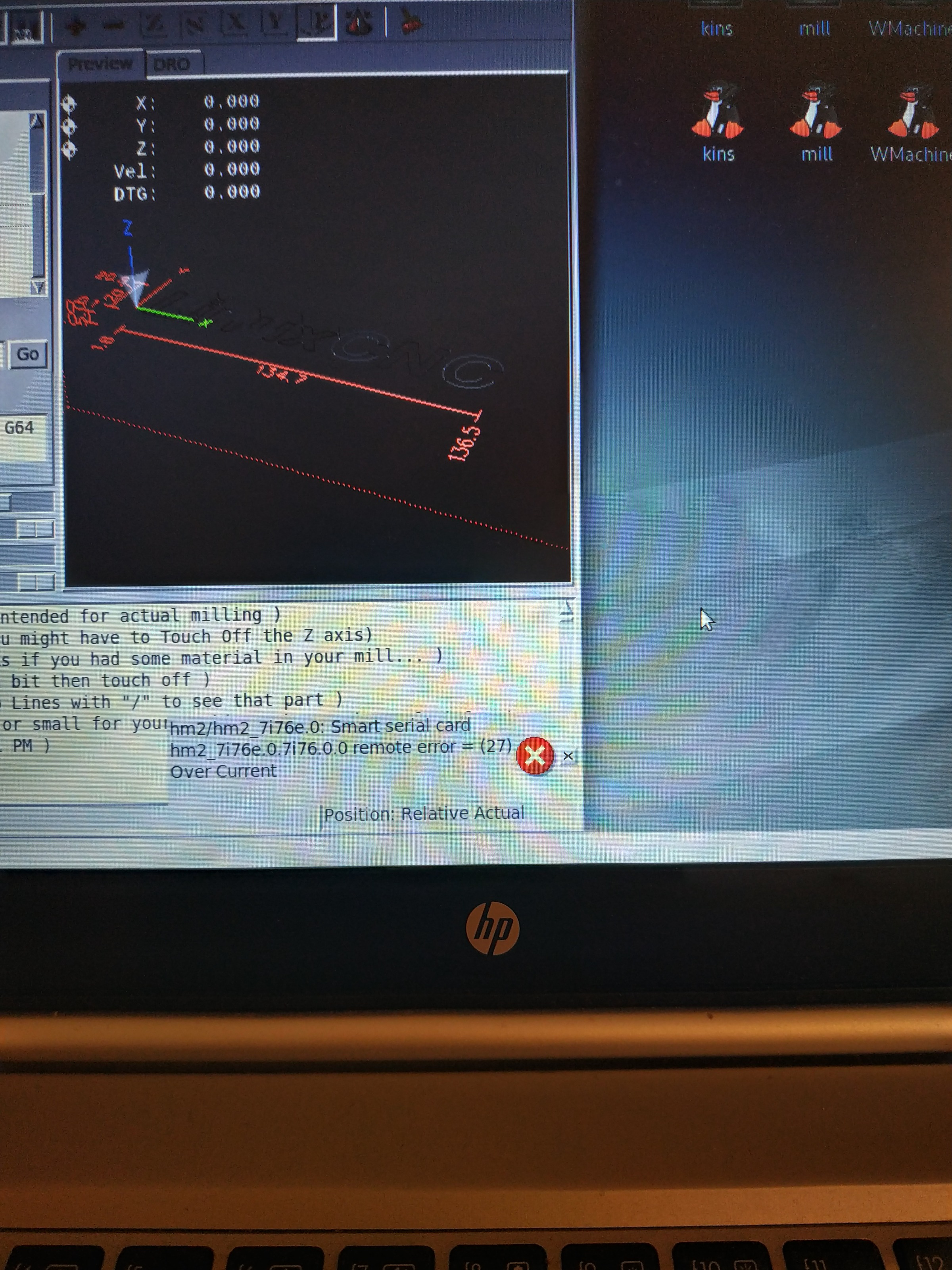

- Hamel2020
- Posts: 74
04 Jan 2021 06:55 #194024
by Hamel2020
Replied by Hamel2020 on topic Using M64 command for a relay trigger
Hi Peter ,
I did the wiring as a sinking signal , I got an error message :
- Posts: 21906
- Thank you received: 7466
04 Jan 2021 11:39 #194028
Replied by tommylight on topic Using M64 command for a relay trigger
No 0V from PSU.
- Posts: 18084
- Thank you received: 5317
04 Jan 2021 15:43 #194046
Replied by PCW on topic Using M64 command for a relay trigger
That error means you have a shorted load (backwards flyback diode?)
