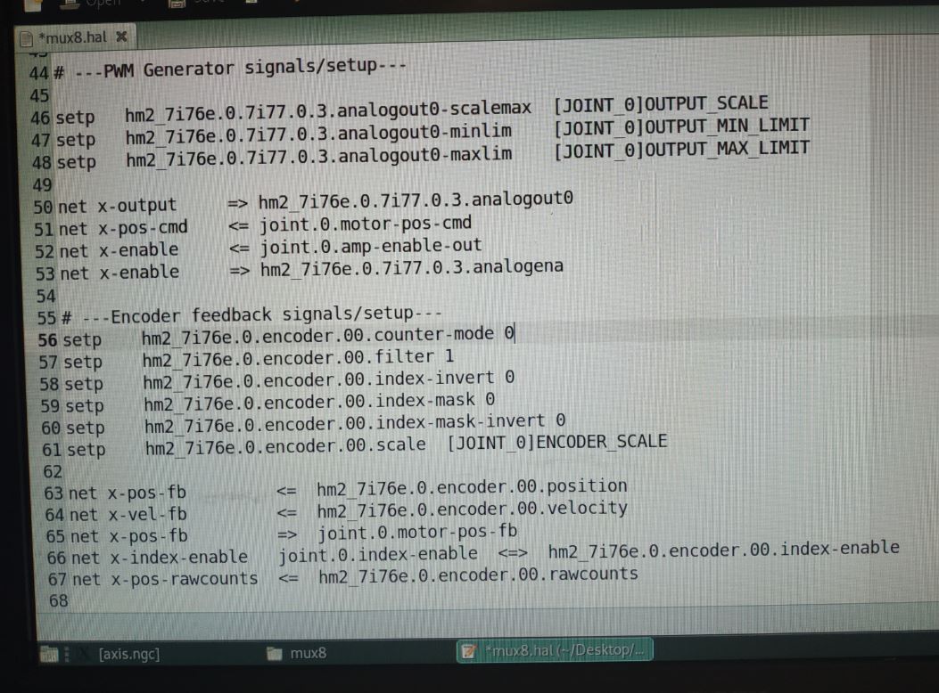

1) Looks good
2) The wiring for the drive enable is correct. Not sure what you are asking for the software enable? The hal file looks correct. When you enable motion on the machine (F2, or power button at the top of Axis gui, if thats what you are using). Mine looks like this:
net x-enable <= joint.0.amp-enable-out
net x-enable => hm2_7i92.0.7i77.0.1.analogena
Double check the pin names in halmeter to see whats available and if you have them named properly. Yours will be different then mine.

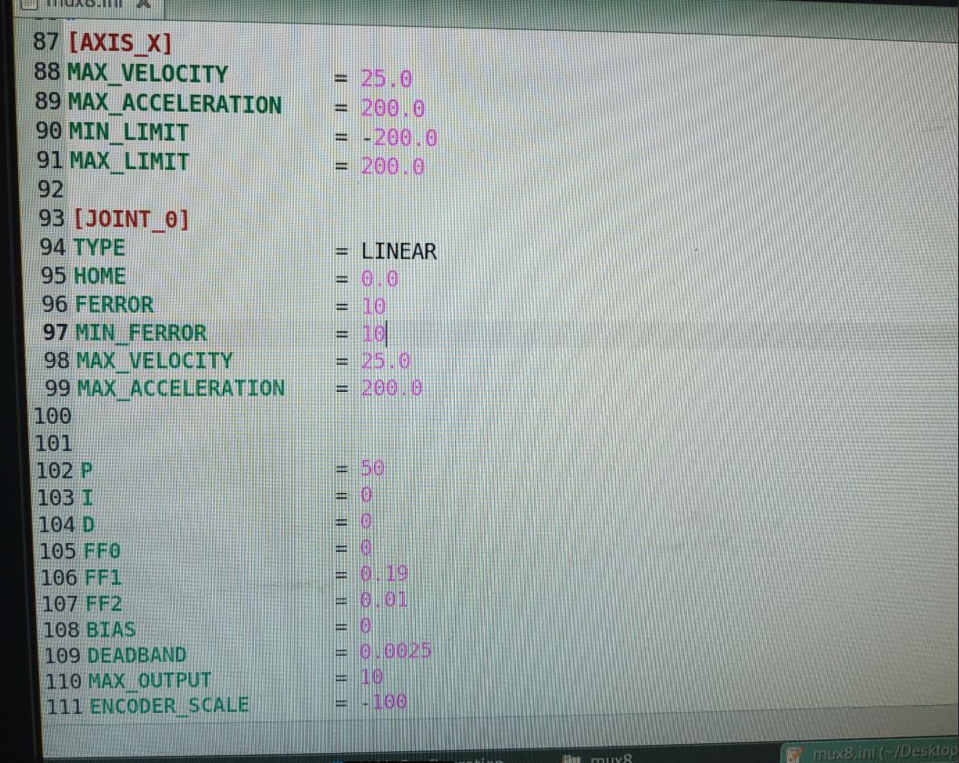

Thank you for reply ... YES ... finally I was able to make the servo move .... but I got joint following error ... and there is a sound in servo drive , I think I have to start my journey with PID ,
Actually I was able to tune the servo motor through the servo manufacturer software... but now when I connect it to mesa get stuck and only shake .. I tried to input the PID figures through ini that was P=1337, I=536,D =0 (which I got from the manufacturer software)
but still the same issue .

I think what he is referring to is the dro counts positive value in the positive direction. Does the motor also spin in the correct direction?
After you have the drives auto tuned they should be relatively stable with a low P value in Linuxcnc ini file. All other values in the linuxcnc ini file for axis tuning should be 0, at least until you get started.

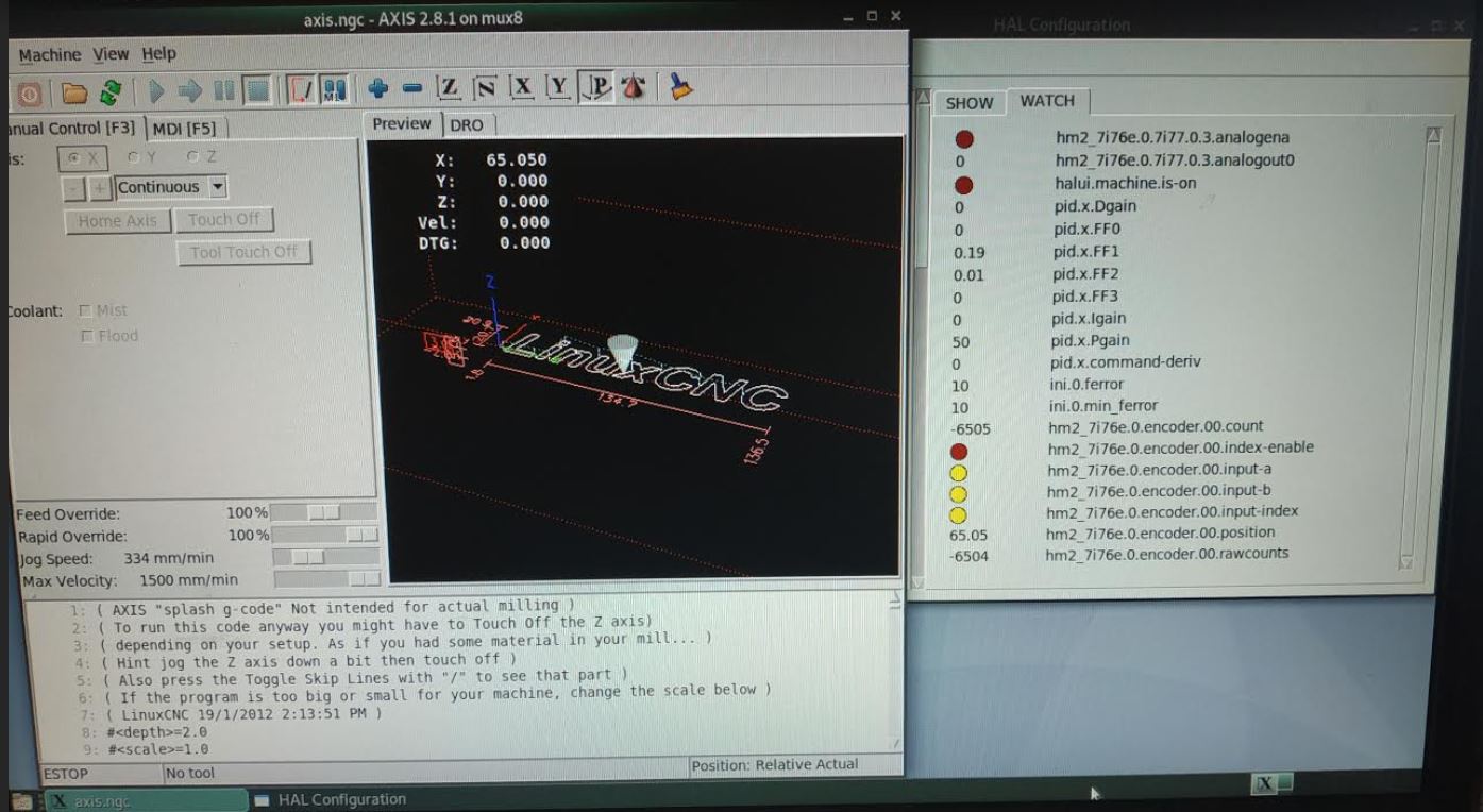

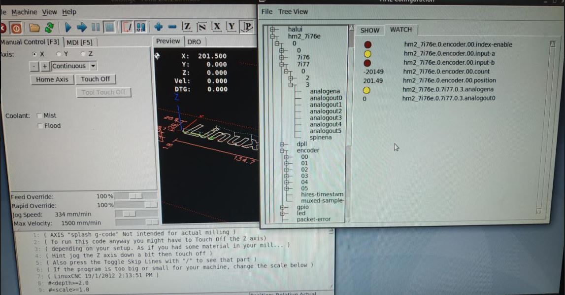

- Hamel2020
- Posts: 74
19 Mar 2021 16:48 #202858
by Hamel2020
Replied by Hamel2020 on topic Analog servo drive enable
Well .. as you seen in the screen attachments ..
when :
motor CW : => X + direction
motor CCW : => X - direction
also attach the ini file
the motor keep moving even not enabled , once i enable it get very fast short rotate and then get joint 0 following error ..
So I do not know what is the problem ...and as PCW said may be the loop not complete ... but I don't know how to verify .... I think the encoder feed back is correct ...
