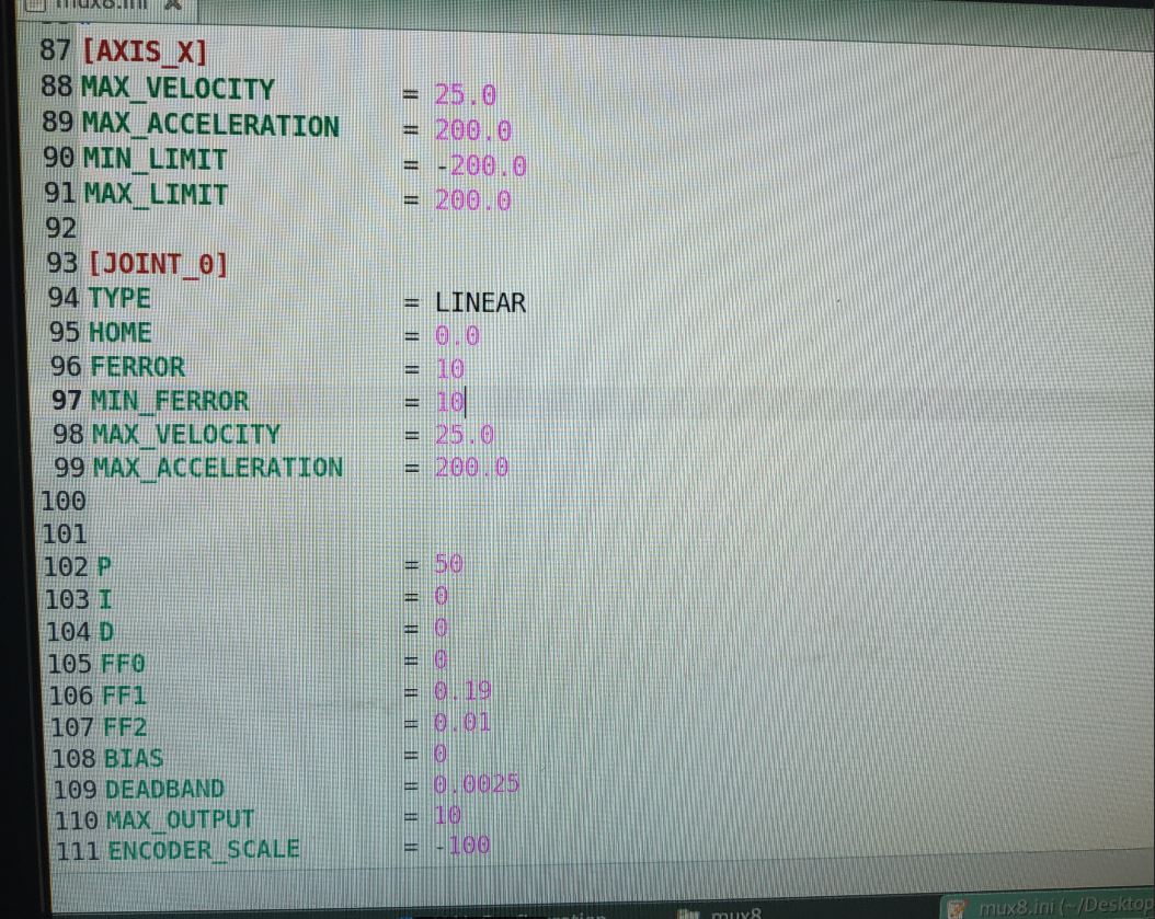

Actually I changed the OUTPUT_SCALE signal , but not difference ...
Peter ... Yesterday you told me may be the loop is not closed ... [ How can I verify that ] ??
- The Encoder feedback is ok as per the screen shoot i attached
- The drive enable also working properly .
So anything else I have to check it , to stop the slow rotation of the motor before enable ... ?

Is the behaviour different with OUTPUT_SCALE reversed?
What are your P,I,D settings?
The drive should not drift if not enabled It sounds like either the drive is still enabled
(check with a voltmeter on the drive enable input) or the drive is not programmed to obey the enable input
Last edit: 19 Mar 2021 17:54 by PCW.

- No reversed ? remain same direction .
- the PID i'm using : P= 50 I= 0 D = 0 (attached img)
As per the sketch I used the circuit breaker as switch .
So when : switch on => driver enabled
when : switch off => driver disable
Suppose to be the write wiring … but not right control because where is the effect of the net :
net x-enable <= joint.0.amp-enable-out
net x-enable => hm2_7i76e.0.7i77.0.3.analogena
when I measure between [ ENOA- & 0V ] I got +24V reading
and when I measure between [ ENOA+ & 0V ] also I got +24V reading
while I did not press the enable from the axis gui ?
that means I got +24 from both ENOA- & ENOA+

Peter .... I really appreciate your help ...
I found the fault of the Enable , it was wiring DB25 mistake
So the enable issue .. sorted .
I follow your comments previously said to a member in the forum ..
forum.linuxcnc.org/38-general-linuxcnc-q...nt-0-following-error
I followed the exact steps .... Once I enable the driver (from linuxcnc) the motor start spinning shortly and then get joint following error
P Range [10 - 50 ] , I : 0, D : 0
FERROR : 15, MIN_FERROR : 15

Replied by PCW on topic Analog servo drive enable
Running away like that points to reversed feedback
Does it runaway with P = 0?
