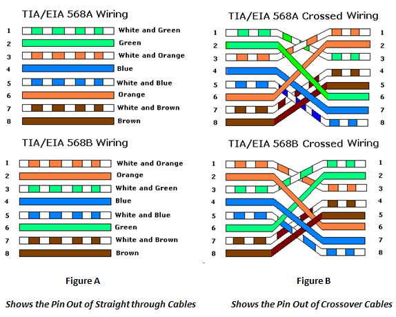

Have you got the right network lead?
There are straight through (sometimes called patch panel leads) and crossover leads.
A crossover lead is basically a 568A <> 568B ethernet cable.
A patch panel lead can be either a 586A <> 568 A OR a 568B <> 568B wired ethernet cable.... basically the pins / colours match on both RJ45 connectors.
For MESA cards, you need a patch / straight through network cable (wired as per either one of the below on the left).
Before someone shouts..... some ethernet cards (I think most of the newer ones can automatically detect and switch between the two cable types as part of their initialisation setup) its call Auto MDI-X and it depends if it is built into your ethernet card or not.
I am not sure if you need to change a setting to use / enable it, but you can force the change (if your card has it built in) withor
(with enp2s0 being your ethernet card name)
because I was getting some really poor ping times (and was using home made network cables) I got a proper pre-made moulded high speed patch cable..... turns out it was not that which was the problem ..... method of elimination. At least I know I am using the right cable now.
