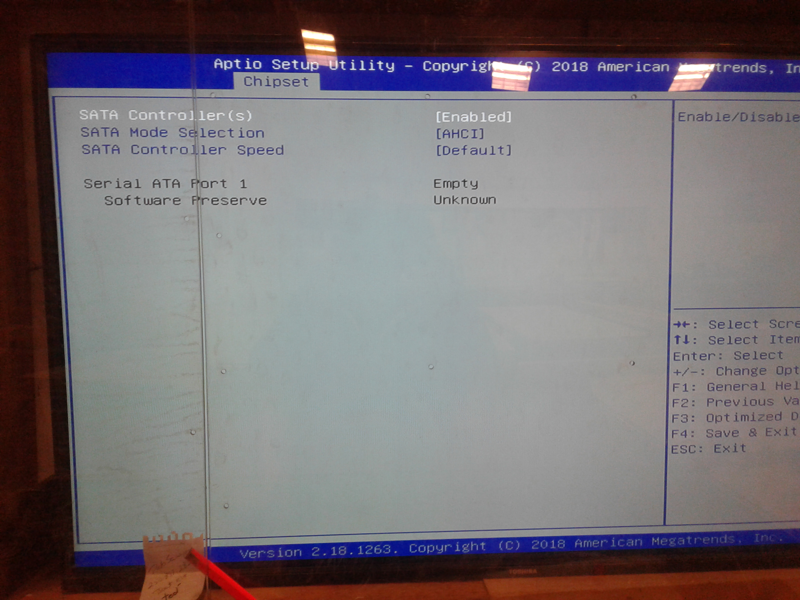

07 Jun 2021 03:07 - 07 Jun 2021 03:17 #211400
by Dragonbitscnc
Replied by Dragonbitscnc on topic Software not talking to hardware. New build
somewhere I reed ATA won't work. this is a shot of my bios screen

10 Jun 2021 13:43 #211697
Replied by andypugh on topic Software not talking to hardware. New build
I am a bit surprised that the parallel port shows up in /proc/ioports if, in fact, it is connected via M2 and PCIe.
Have you tried using the parallel port tester component?
