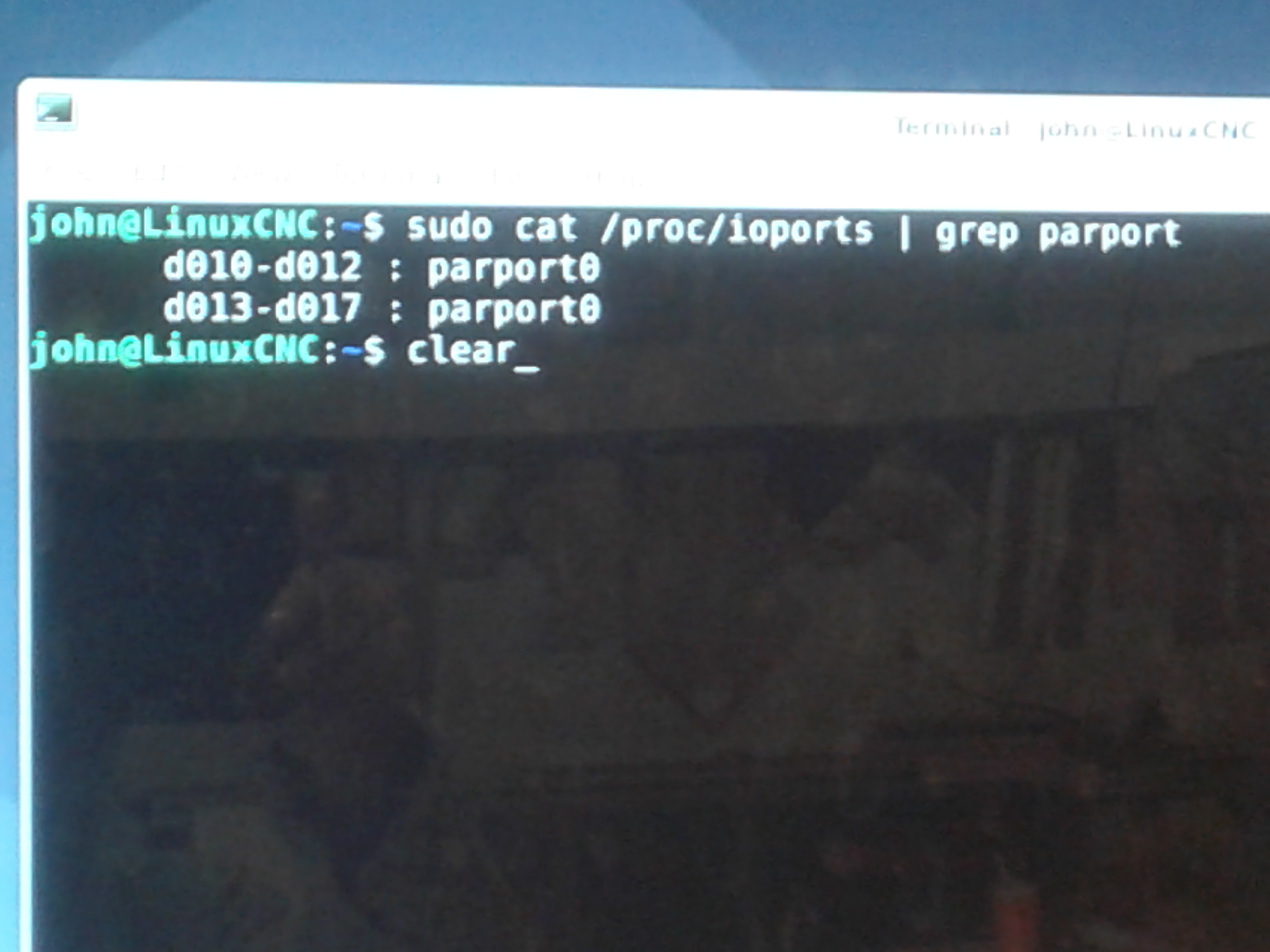

Replied by tommylight on topic Software not talking to hardware. New build
0xd010
That should be the address entered in hal or in stepconf, if that does not work try 0xd013 but after a reboot, some port get stuck when accessed on the wrong address.
Another thing to keep in mind with add on cards, the address might change at random when booting the PC. That is due to automatic assignment of resources on the PC at boot time, so if at any point the port starts working, check the address.

Thank you every one. I got it running, the step timeing was way off.
