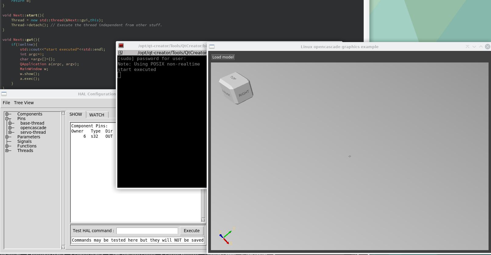

Could it be handy to integrate the "opencascade cad viewer" in a linuxncnc .so component?
The tk visualisation is a little bit outdated in the sence of displaying cool stepfile models.
Who thinks this is a cool option?

We got some progress.
The opencascade.so component is first online now.
And it start the opencascade screen in a separate thread. I had to write some unusual
code for this. It has to start a mainwindow from inside a shared library. And it may not freeze the application. That is solved now.

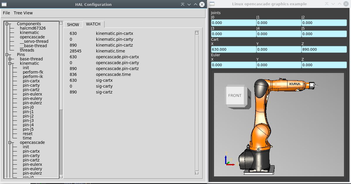

28 Jun 2021 16:37 - 28 Jun 2021 16:41 #213158
by Grotius
Replied by Grotius on topic Opencascade hal component, display and interact with 3d stepfile models
It now loads the robot model.
I had to solve a message : std::bad alloc
This was happening when the kinematic.so and the opencascade.so where loaded together on the servo-thread.
I think the showing time value's are quite good.
The basic's are working now. A proof of concept is done!
Have to code straight to the finish line now. I will keep the c & c++ code as simple as possible.
Arciera, do you have your robot stepfiles already?
Latest source code for info : github.com/grotius-cnc/hal-opencascade/releases/tag/1.0.0

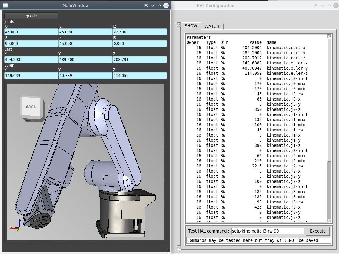

28 Jun 2021 22:14 - 29 Jun 2021 00:12 #213182
by Grotius
Hi Arciera,You don't have to look. I have some work to do before it's ready.
If you have any time left, could you convert the stl's to step? Maybe color the files a little bit, so it looks cool !!
My first attempt rotating the machine by setting joint hal rw parameters with forward kinematics.
[edit]
And a video where the inverse kinematics is just working.
To apply the gcode, we want to use a kind of 3d matrix for this. Then we can position the gcode to our needs.
Todo : Maybe search how linuxcnc read's the gcode. This would save us programming time.
Then we can visualize the gcode with the machine model. The dxfrw library is already inside the opencascade component.
We could display dxf files already !
For the kinematics i will add hals pin's for
1. ik from current position - ik from init position.
2. user defined ik iteration value ~100
Ok so far so good! Have a nice day!
