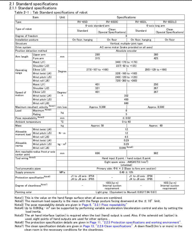

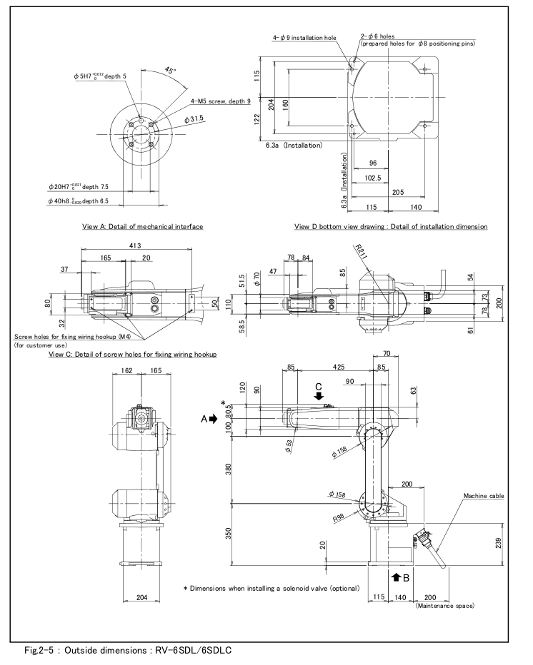

Cool! I notice the colors didn't work after all but mitsubishi robots are usually white anyway.
Joint Limits in respect to "home" position as depicted in the 'RV-&SDL-Dimensions' Document below:
J1 Waist: -170 .. 170°
J2 Shoulder: -92 .. 135°
J3 Ellbow: -129 .. 166
J4 Wrist twist: -160 .. 160°
J5 Wrist pitch: -120 .. 120°
J6 Wrist roll: -360 .. 360° (this is with hose or cable attached to the Hand. Mechanically there is no limit)

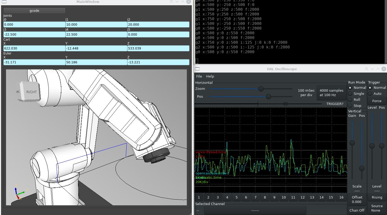

Today the robot was painted in original white colors, and it recieved a 25mm solid metal base plate.
The mitsubishi is happy with it's new gcode parser adapted from github, named gpr. The interfacing had to be coded. It's in the project now. It can read several syntaxes:
We have to make a tiny plan to interact with the original linuxcnc gui. There are some offsets to handle.
I think to set up a tiny test with linuxcnc axis running a gcode. Connect some motors and then see what happens.
Would it be an idea to write a component based motion planner?
A planner for xyz moves? Something simple... How do you think about this?
Ok. have a nice day.

How much effort would it be for a user to add an stl model of a gripper or other end effector to the flange?
You mean instead of using the built in motion planner? Why not, but really for a robot to be limited to xyz will be a severe limitation to it's usability.Would it be an idea to write a component based motion planner?

A video with linuxcnc axis_mm as position controller for xyz moves :
user-images.githubusercontent.com/448801...5d1-66722a014bb7.mp4
The sequence for loading this in the axis_mm.ini file, we add 3 hal files only :
HALFILE = machine.hal (interface machine to axis_mm.ini)
HALFILE = mitsubishi_rv_6sdl/mitsubishi_rv_6sdl.hal (contains machinemodel parameters)
HALFILE = link.hal (connects kinematic.so to opencascade.so)
Then the most interesting one is the "machine.hal" file wich does all the work, mention axis_mm has already
the servo-thread loaded in a previous hal file :
loadrt opencascade stepfilepath=/machines/mitsubishi_rv_6sdl (load the opencascade.so and point to the stepfile path)
loadrt kinematic (load kinematic.so)
addf opencascade servo-thread
addf kinematic servo-thread
net sig_testx joint.0.pos-cmd kinematic.pin-cartx-in (connect a axis_mm pin to a kinematic input pin)
net sig_testy joint.1.pos-cmd kinematic.pin-carty-in
net sig_testz joint.2.pos-cmd kinematic.pin-cartz-in
It would include joint move.
What would be the real benefits if we have a component based motion planner?
This component then includes reading and executing a gcode file.
What would be the benefits if we have a c++ linuxcnc interface gui instead of a python coded one like axis ?
Now the project evolves, it looks like a component based program is a very clean solution to create realtime programs.
If we go on this way the program can look like loading a few components:
1. motion.so (motion planner + gcode reader)
2. kinematic.so (convert gcode, jog, etc, coordinates to your kinematic model)
3. opencascade.so (display it)
4. load the .hal hardware file.
This modular build up, give's you freedom. Currently it looks impossible to use a stand alone motion controller from hal.
Or a stand alone gcode reader.
If we have a c++ linuxcnc interface gui, we could load and connect component's from a selection list on the fly.
Or load a hal project. Then it's also possible to load multiple motion planners at the same time !
This make's it possible to create programs for a complex machine cascade. Just a idea.
