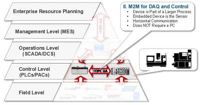

Simple OPC UA (Pub/Sub) is not a fieldbus. It is positioned higher in the Maslow hierarchy (the automation pyramid of Industry 4.0). Naturally, this implementation of the protocol is slower. However, regarding OPC UA FX, it somewhat merges two levels of the pyramid. (Although in promotional images, it represents the entire pyramid)
Its speeds supposedly exceed Ethercat, at ~40 ns and less. Briefly, this is due to the efficient separation of traffic (a separate lecture would be needed for this
