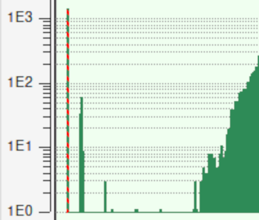

There are striped lines on the base period side, this will show the value.
Replied by tommylight on topic Successfully configured with stepconf: but +Y-axis "stutters" running G-code
latency-histogram --showPlease Log in or Create an account to join the conversation.

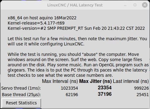

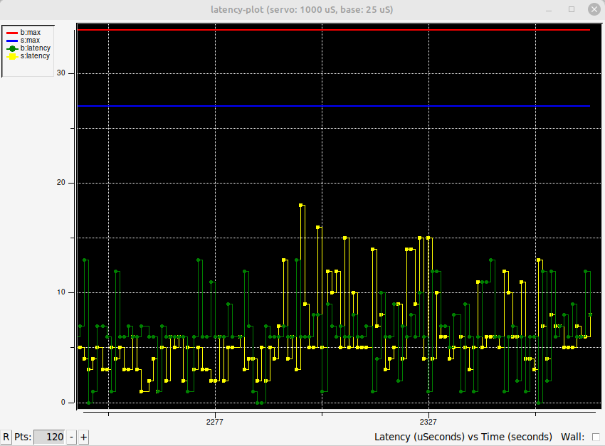

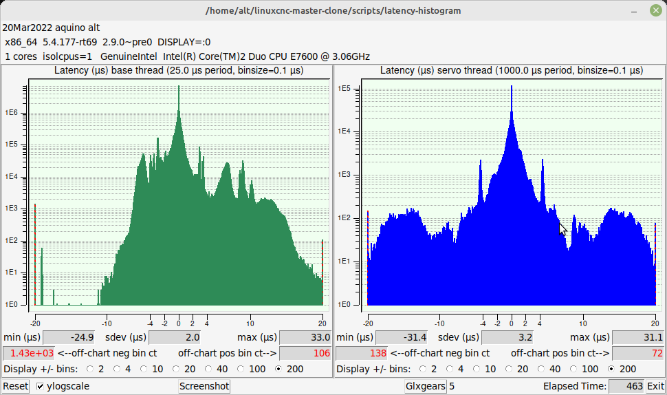

20 Mar 2022 15:41 #237820
by clunc
Secondly, thank you for your help.
I've attached the latest latency-histogram with an even heavier torture test going on.
I see three ways forward for meJ: 1. continue on the path of trying to find and fix the sources of latency, 2. dial back performance settings to avoid being hit by latency problems, or 3. start over. Of course, I'm partial to #1 because it would be better to have a better understanding of my setup.
I can add now that the original problem I mentioned did not recur, after simply editing the LinuxCNC logo G-code program to change G21 to G20 (and adjusting the scale accordingly), mm to inch mode. It ran without incident in inch.
What caused me to throw in the towel last night was this: after experiencing a Z/joint-2 following error when jogging (at under 200 IPM) and losing position information and having to restart LinuxCNC, I had actually been able to face the workpiece (w/a program of simple back-and-forth passes). However, as I was jogging to set the zeroes for the first roughing pass of a model, it lost position again, this time in the Y-axis. While I suspect the rough pass might have run successfully, I couldn't be sure and I still have the more complicated finish pass to run (which actually might run fine owing to the much fewer and shorter rapids).
To recap:
1. I have copied the config/ directory from the old machine to the new, and have edited only the parport/io addresses,
2. move the PCI (not PCIe) parallel-port cards from the old machine to the new.
3. run stepconf and tested all 3 axes in the back-and-forth mode, confirming I thought the acceleration entries were acceptable.
4. the machine stops abruptly, but not predictably, when jogging (at least in Y and Z so far) with a "joint-following error."

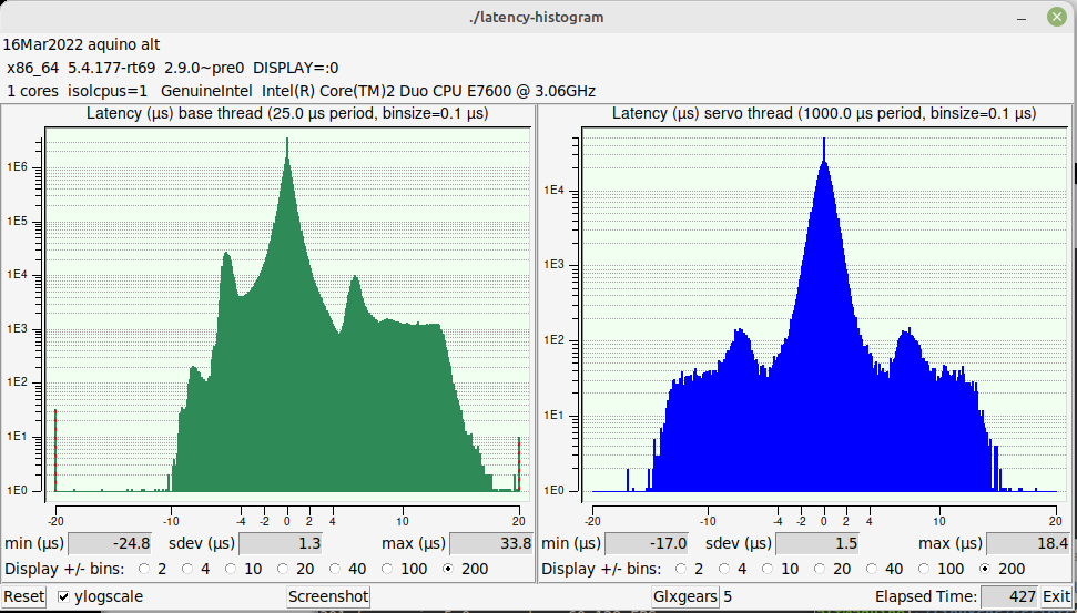

20 Mar 2022 15:48 - 20 Mar 2022 16:14 #237821
by clunc
Replied by clunc on topic Successfully configured with stepconf: but +Y-axis "stutters" running G-code
Oh, I see, finally, the striped lines you mentioned (attached).

20 Mar 2022 16:15 #237822
Yeah that is bad, see the red numbers in the histogram, those are huge latency excursions so it will be useless for anything except testing.
That will cause random stalls, wrong dimensions, low motor torque...
If you can:
-remove all memory sticks and test them one by one
-change the power supply
-check the processor for heat or failed fan, repasting it might help a lot
-test the latency from a live USB session
Also remove cpu isolation, some insist it works, for me it never made any reasonable difference with RT kernel, it does work with RTAI.... Thinking of it there is a RTAI kernel that works with the official ISO, so try that, chances are it will work.

I spent some time months ago playing with preempt-rt, different machines, vga, core isolation, interrupt routing... yada yada to squeeze 'more rt' out of machines. There is quite a lot of stuff that can be done... see attachment for a nice result while torture testing.
But a 'clean' bios is a good initial step. If suitable bios options to get power / clock management under control aren't available, kernel params can be used to get things under control. The kernel documentation contains all the info required.
Isolcpus isn't worthless btw. It won't turn a lemon into something brilliant but depending on how intertwined the cores are (e.g. cache layout can require to sacrifice more than one core) it can be combined with a proper irq routing to keep a core 'clean' and reduce an 'acceptable' latency by an order of magnitude.
Also my experience on old intel machines has been that onboard vga produced the least noise in terms of latency artifacts.
What CPU and kernel version are you running exactly? I might have dealt with a similar machine and have more concrete tips or 'kernel spells' I could share
