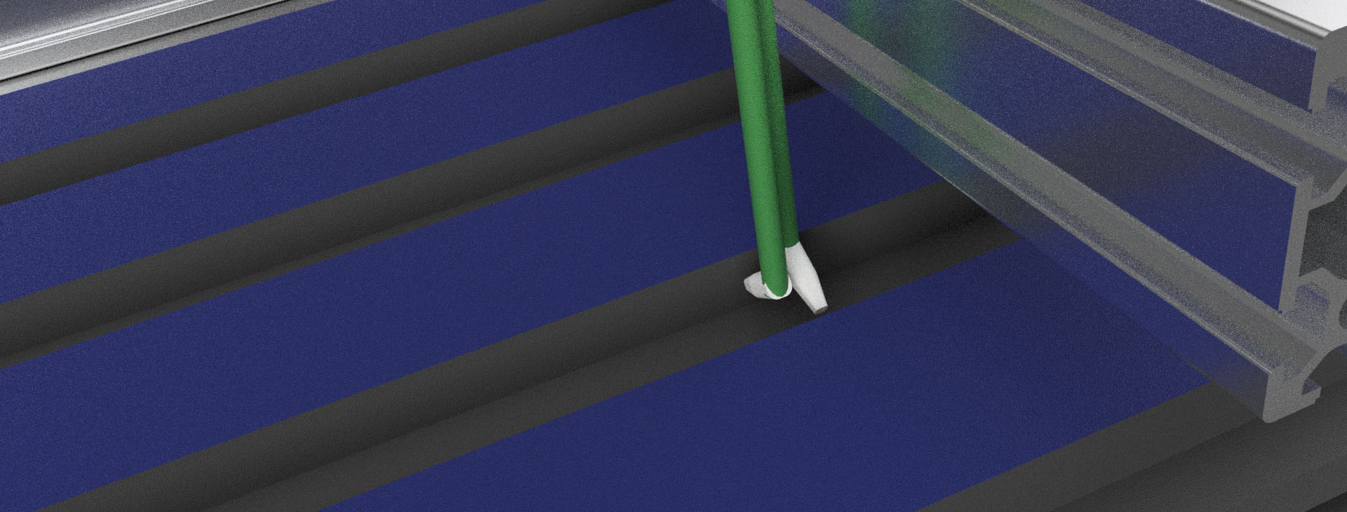

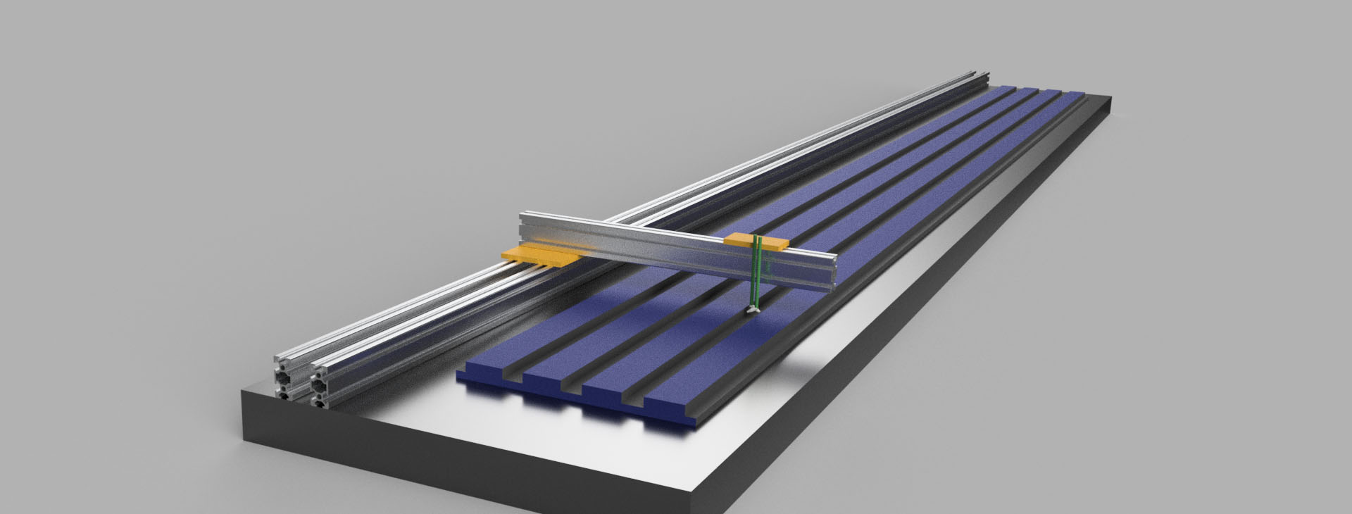

@tommylight: Thanks for that. I hope it will be not that difficult to set it up in Linuxcnc. From the hardware side, it shouldnt be a problem for me, because i have a fog mister on my cnc router with a solenoid relai valve. Setting up 2 of these should not be difficult for me.
Here the simple drawing i made. I hope that is enough to understand what i am planning to do.
You can see on the pictures, the nozzles are not on the same position, so one nozzle has to start and stop spraying earlier than the other nozzle.
On the last picture you can see that when spraying the side-ends (if i can say so) of the panel, only one nozzle has to be activated.
PS: I will use the "siphon feed" type painting technic, so there will be actually 1 paint nozzle and one air nozzle for one side to paint. The paint nozzle is always "open", and the paint gets pulled by the air from the air nozzle. Its the venturi effect if i remember correct. You can type "airbrush siphon feed" in google to see that type of airbrush and how it works. The only disadvantage with this technic is that the paint nozzle has to be above the paint lowest point of the paint in the tank, otherwise the paint will just flow out of the nozzle until the tank is empty.
I hope now everything important is clear. If not, just let me know. I always got help here, but first time i am really in a hurry, so if you have any good ideas, please let me know it. I need to get that machine done within 2 weeks and i havent even started the drawing and ordering components.

05 Sep 2022 19:25 #251249
Replied by tommylight on topic 2 Axis machine - Controlling 2 solenoid valves seperatly at specific locations
That is simple enough, so you might be overthinking it.
What is the distance between nozzles?
Why not have the nozzles to paint everything at once ?
So, for having one nozzle stop before the other, use an M code that does is not syncronised with motion as the speed of painting will not change, or was it one that does not brake blending ? Getting rusty!
Or do some tests with acceleration if you get jerky motion when the first nozzle stops.
Either way, it should be doable and it should work.
