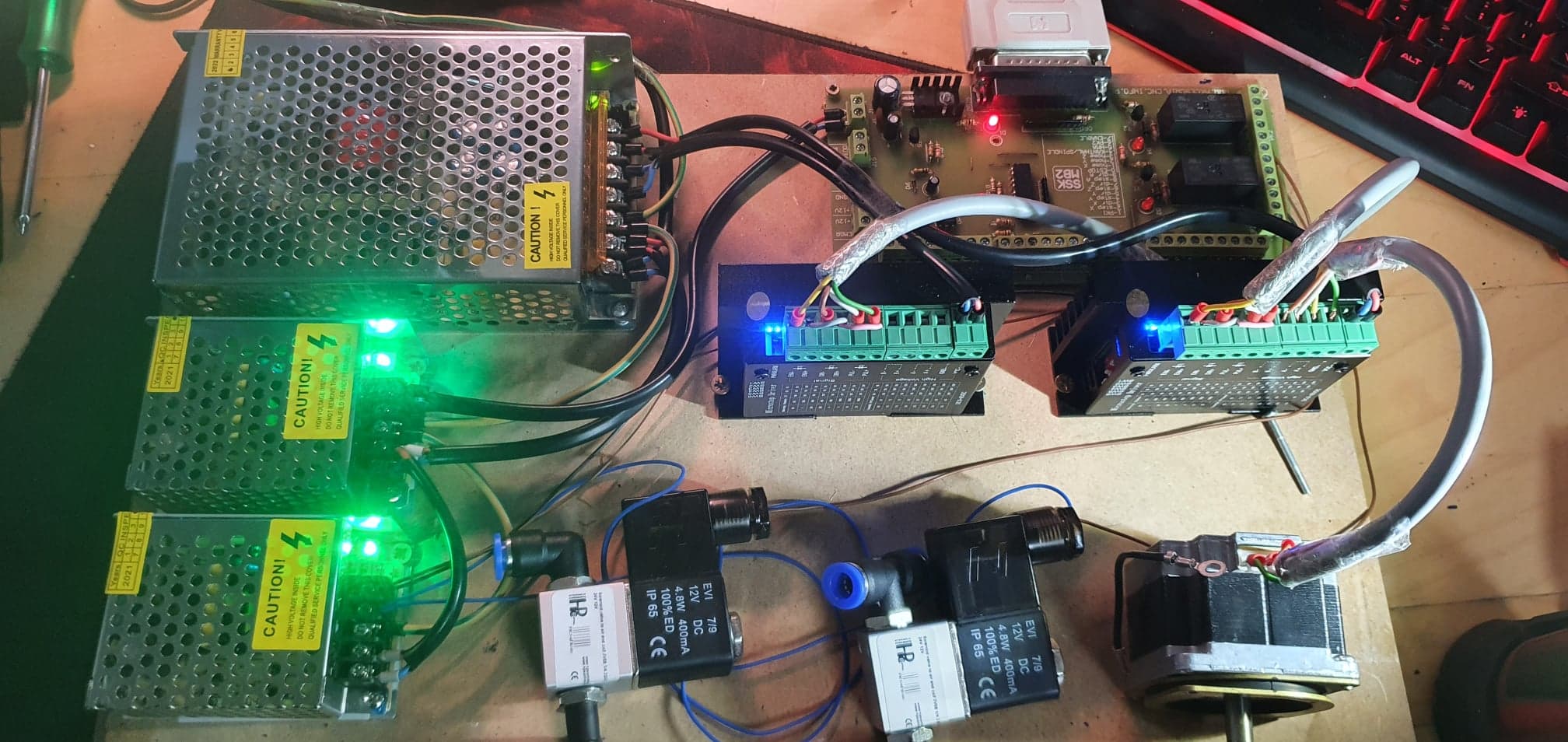

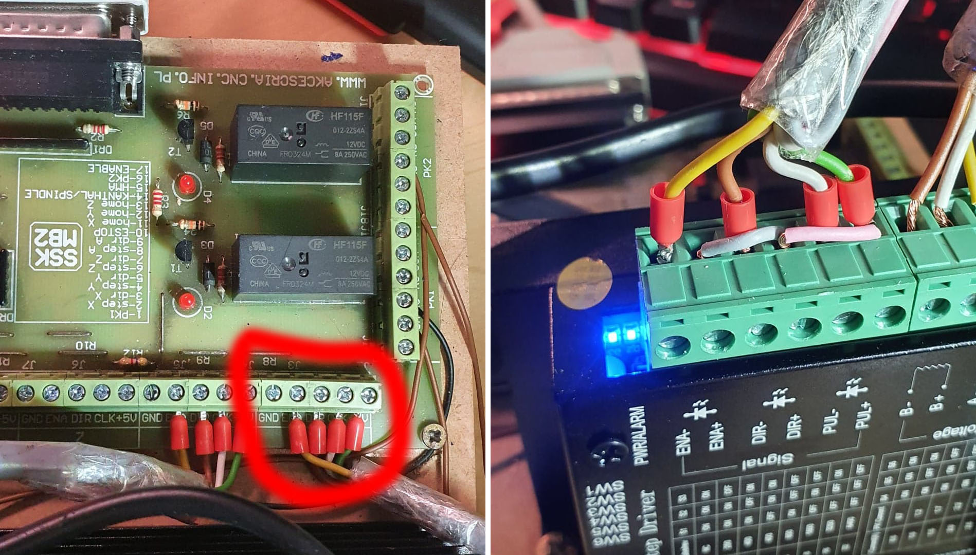

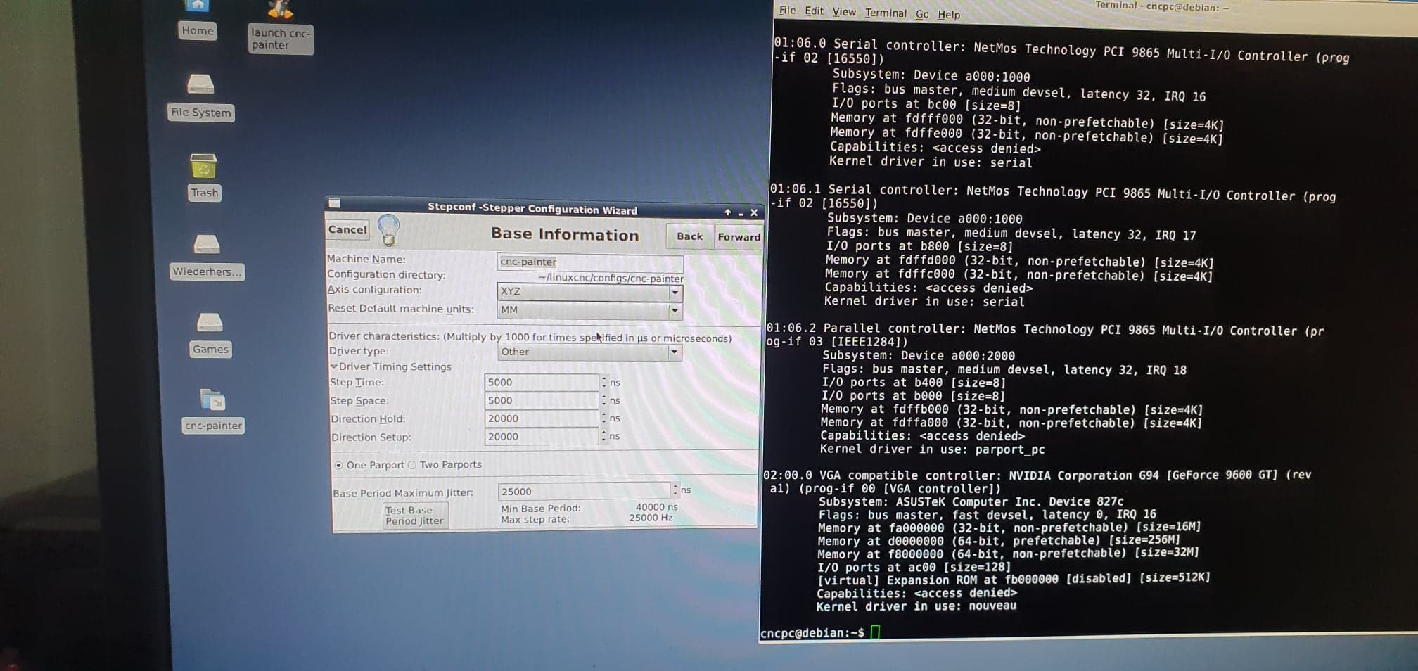

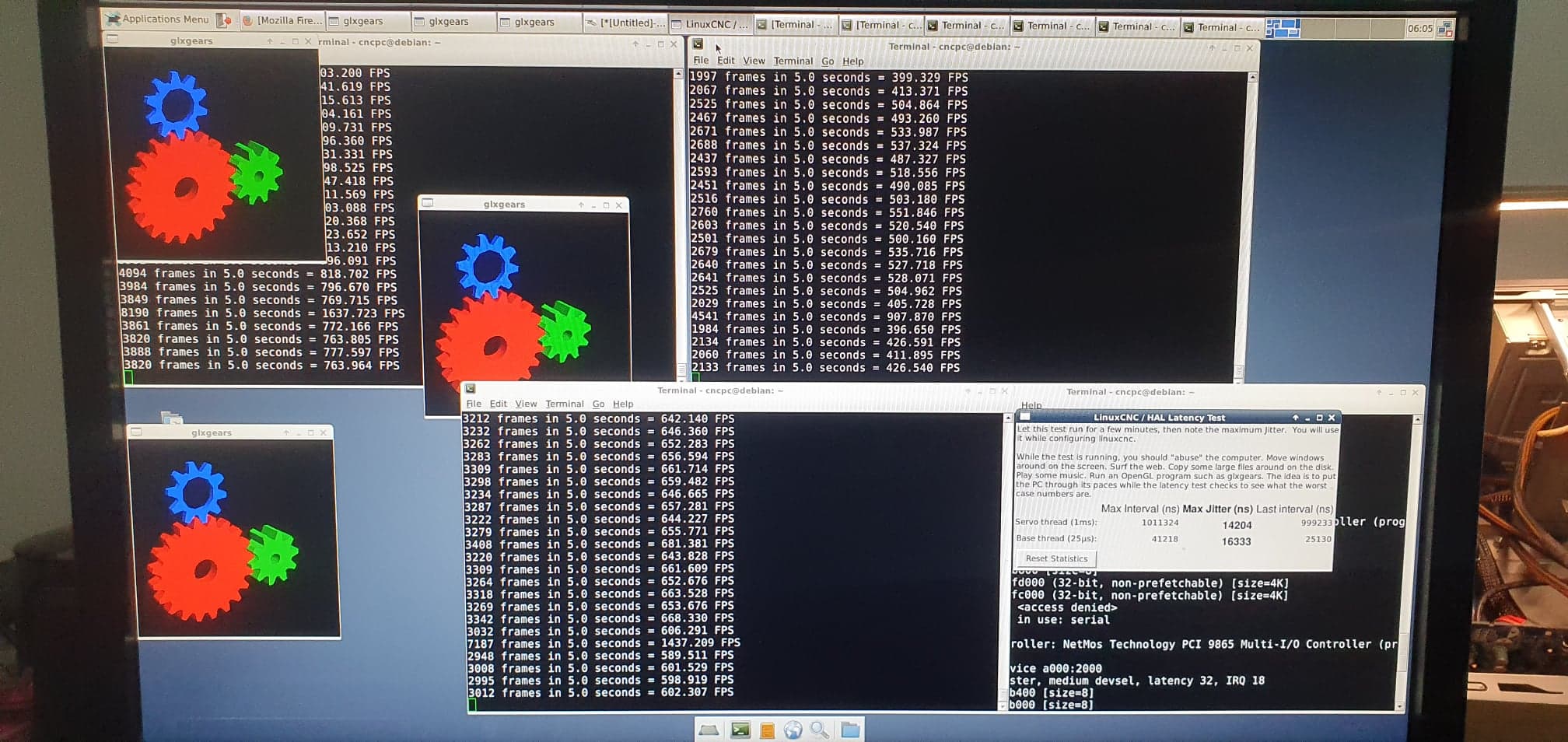

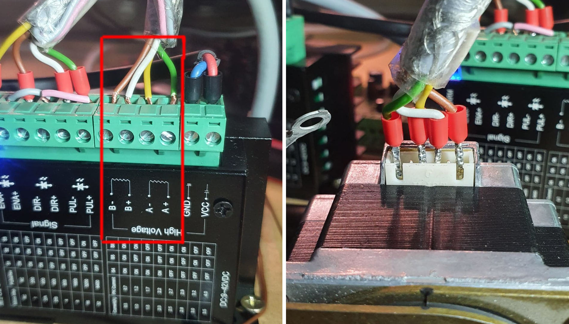

Hello Guys,
i got everything i need to do the Linuxcnc settings, but i am not able to get the nema 23 motor (Minebea Mitsumi) to turn. Its powered and difficult to turn by hand, but its not moving when jogging in stepconf. I have tried everything what came to my mind.
Here a short description of what i did since yesterday.
Yesterday i picked up a PC with Monitor, etc.. (Fujitsu mainboard, Quad Core Q8300 cpu,...), but it had crazy latency spike, so on today i picked up a Gigabyte board with a Phenom X4 850 (all Phenoms CPUs i had worked well with low latency) and installed it to the case from the previous PC case.
I was also facing latency spikes as soon as i started GLXGEARS (from 5000 to 180000), so i installed a GPU, changed bios settings and now after running for 2h with 3 x GLXGEARS, the latency were at 16000. It was at 6000 for a long time, but the screensaver was on when i came back and then it was at 16000. Not sure if screensaver could create that spike from 5000 to 16000, but its still good.
I have tried a lot of different wiring setups, but the current setup (which can be seen on the pictures), powers the motor when testing the axis in STEPCONF. Its difficult to move, but the motor just wont turn.
It seems that i am not getting it done by my self. This is my 4. machine i build, but its the first time i am not getting the stepper to turn..)
Hardware:
BOB: SSK-MB2 (its a polish breakout board, that i am also using on my cnc router, but this one was lying in the corner for 5 years or so - should be O.K.)
Driver: TB6600 (was cheap, 13 € or so, so i am not sure if they are original)
Powersupply for drivers: 24V / 5A
Powersupply for BOB: 12V
Powersupply for Solenoids: 12V
Pictures: (please let me know if i should add more pictures)

Motor is turning!
I hade switched the wires between ENA- and PUL+ on the driver. Previously i just copied the wire arrangement from my cnc routers driver (Leadshine). I thought it will be the same arrangement.. Its strange, but I think you guys will better know why.
I will continue and try to get a g code to work with the solenoids, but currently i am not sure which codes are the correct. M62 - 65 , or M67/68?
For 2 solenoids M62 - M65 should be right, because I need 2 "On commands" and 2 "Off commands" or am i wrong?
